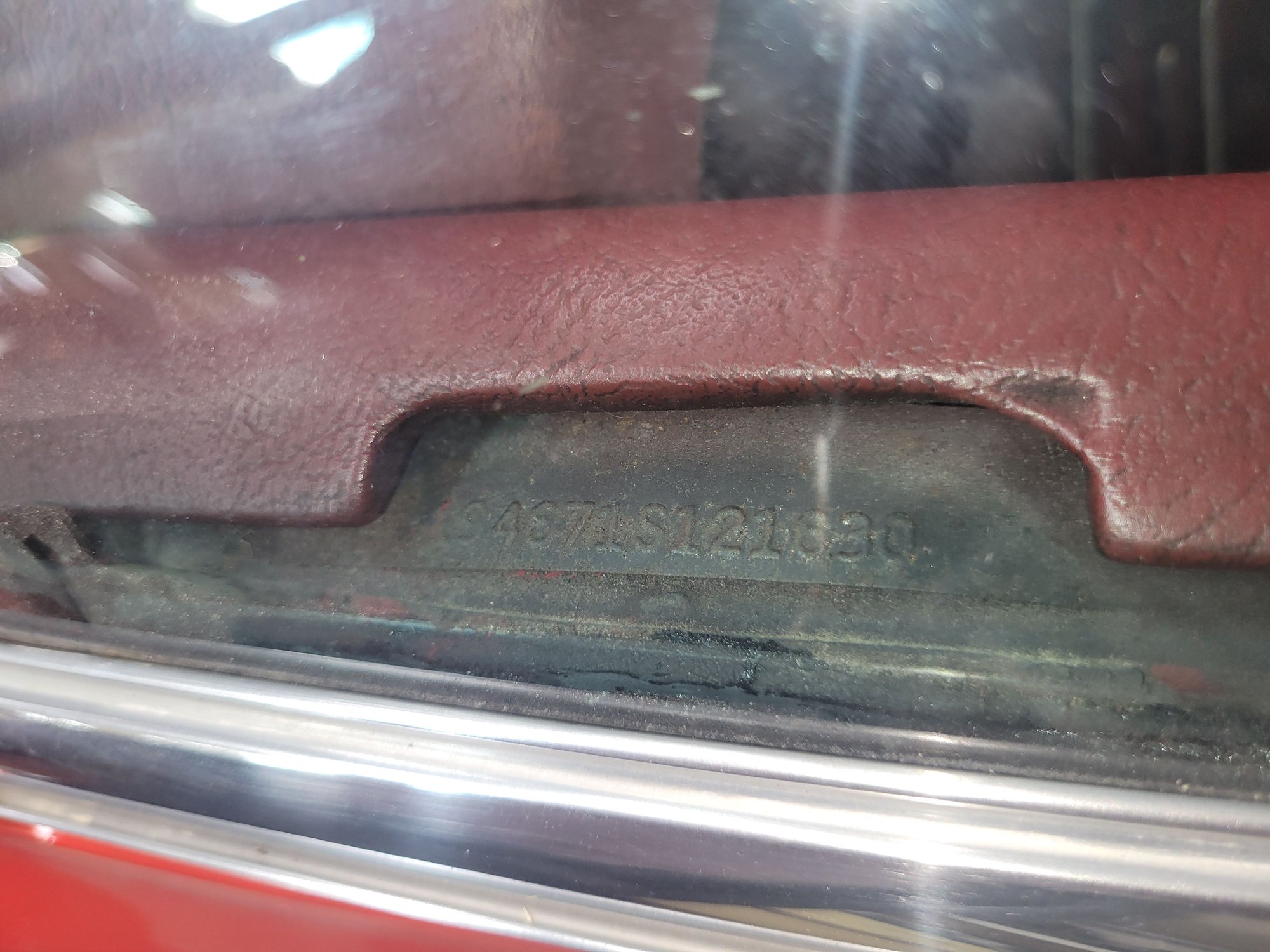

I found a thread from 9 yrs ago where somebody said that the VIN number of the frame is not the complete VIN as seen on the A-pillar behind the windshield. Is this correct?
As you can see the number in the A pillar is
194671S121630 whereas on the frame itself the last three digits are not there.

Every country should be looking at the VIN in the windshield frame. And no where else.

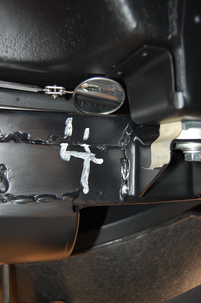

This is the stamp's location on the left side frame rail as seen with a small mirror.
It's just forward of the #4 body mount.
Often the surface needs to be 'cleaned in order to see the stamp.

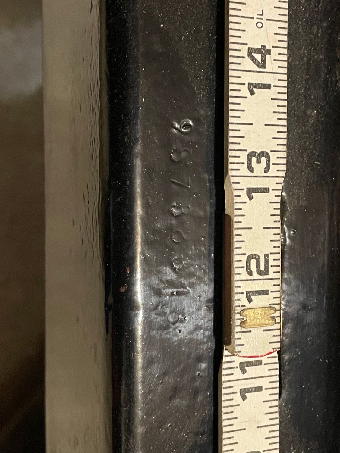

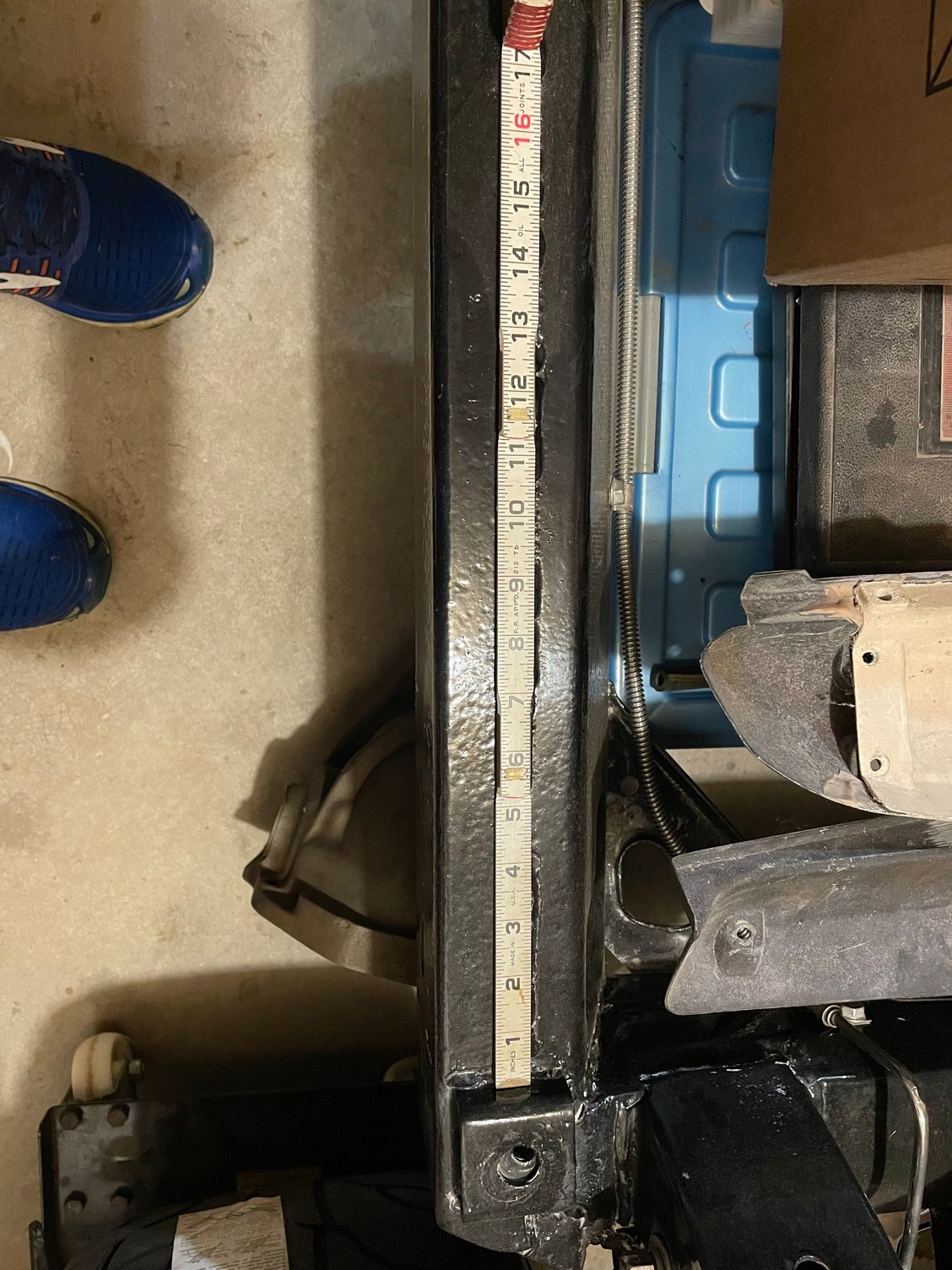

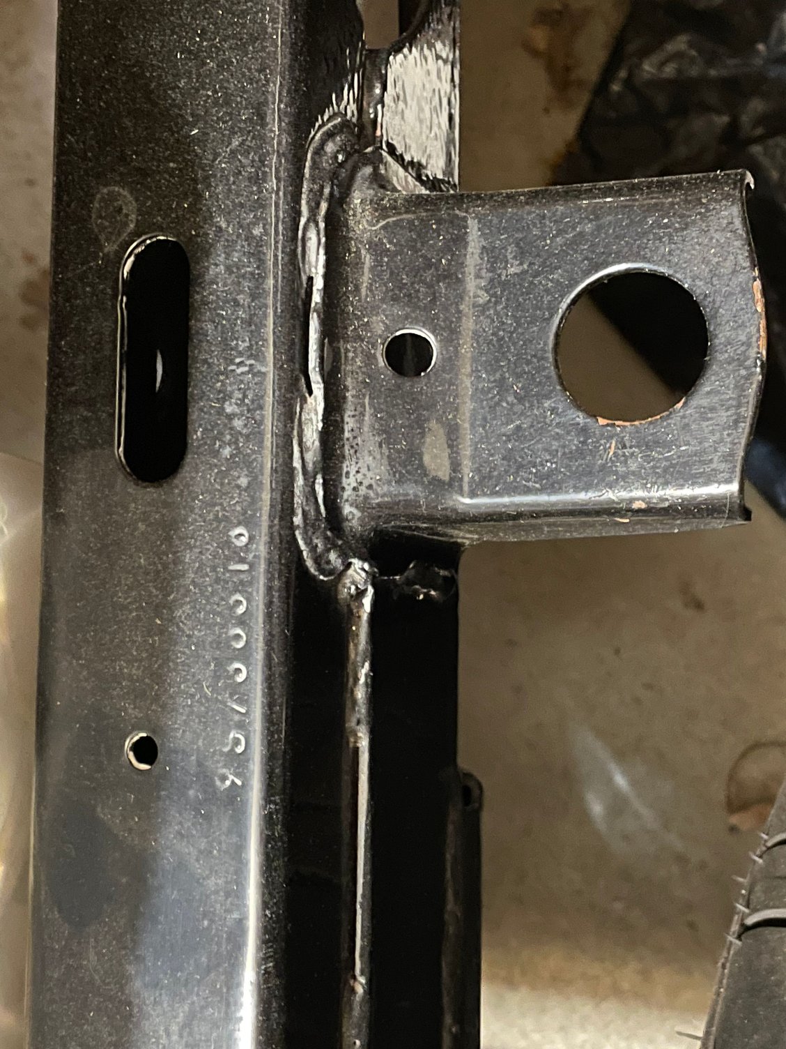

Here are some shots of my late December 1969 frame.
12 inches forward of the #3 Left mount
Closeup of main frame retail forward of #3 Left mount
#4 Left mount area
#4 Left mount area
