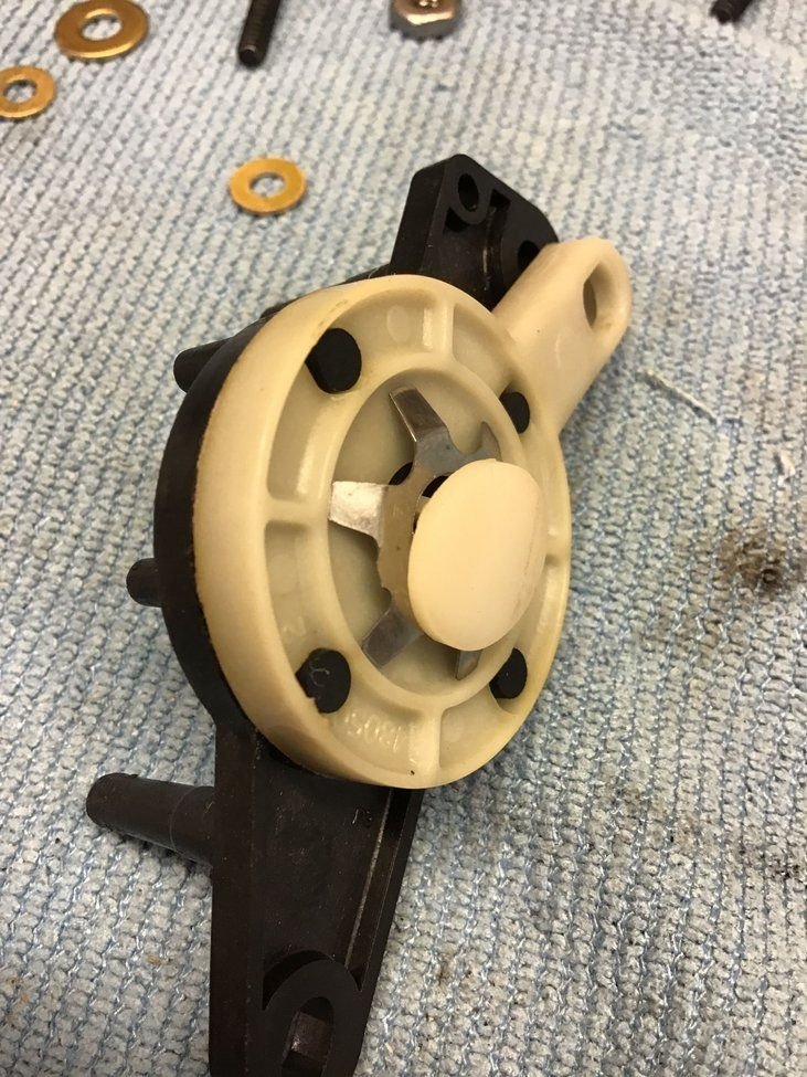

I have a 1979 with AC and the blower works fine but only blows on the floor vents. I cannot get anything from the dash vents or defrost vent no mater what setting I use. I have checked the vacuum lines and I'm pretty sure they are all good or at least as far as I can trace them. Any other suggestions would be great. Thanks

Vacuum distribution manifold (or its mechanism) mounted on the left side of the heater control is damaged or needs replacement [probably]. Could also be a failed vacuum servo which operates the deflector door (which moves from floor to dash to defroster ducts).

I would suggest you get a vacuum tool, like MiteyVac. Hook it up and pull a vacuum while operating your control lever. You should be able to hear doors open and close. Or you might not be able to pull a vacuum, which will then lead you to diagnose where the leak is. Hook the tool up to the main vac line, then pinch of the rest while you test one at a time. DO you have a schematic of the vac line hoses for the heater switch? That is really good to have. It will tell you which line goes where ( the green strip, the blue strip etc). If you don't have one, PM me.

your switch is bad.. see this thread..

most likely cause, broken plastic rivet in the vacuum selector. Actually, forward, center of console on a 79. Very common problem.
