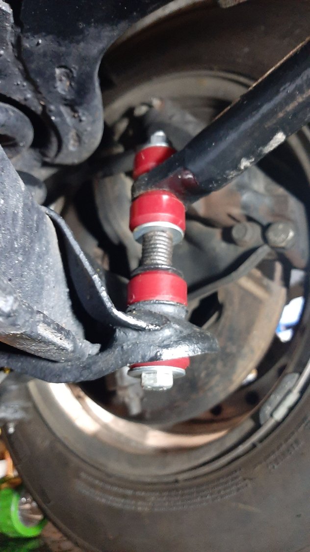

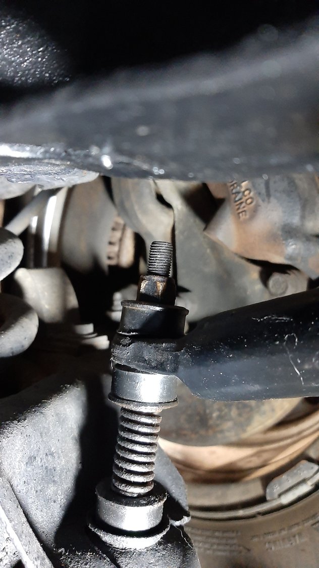

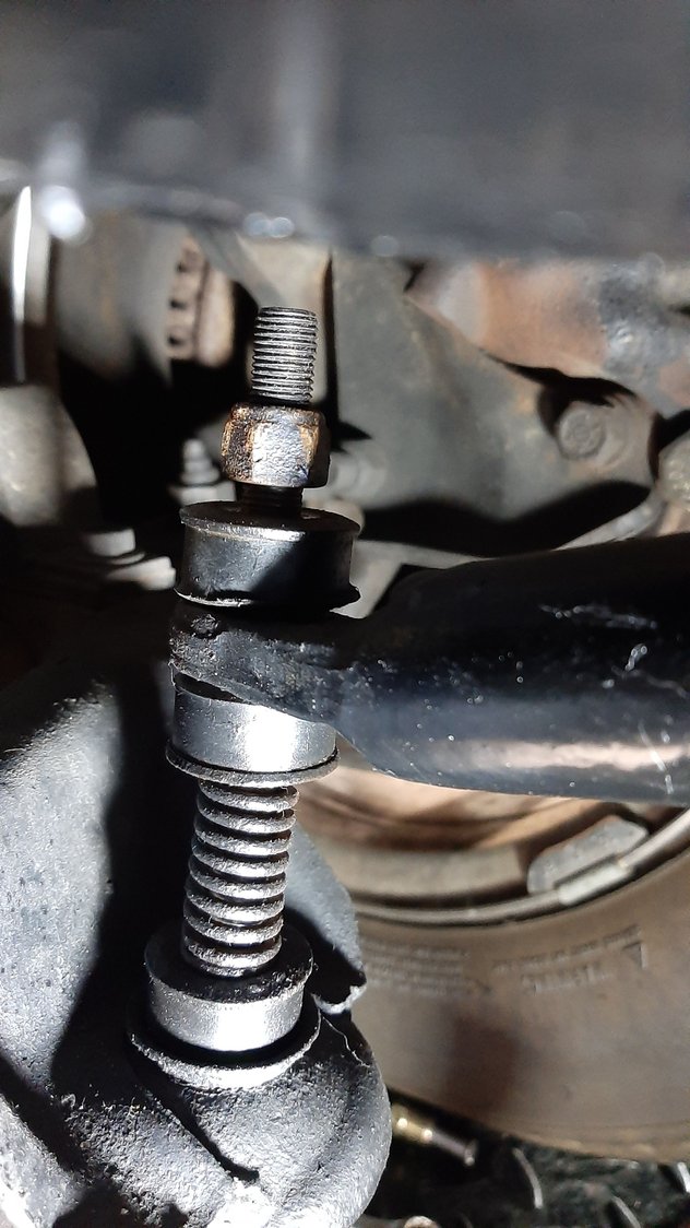

Hi and have a question regarding the front sway bar. Should there be half inch or so play with these. I posted pics su u can see. I got a socket and wrench on it but tight as it gets. I have it up on my lift replacing the power steering hoses and these links with all the play just doesn't seem right. Is it

There should be no gap, but that spring is not stock, either. That is an aftermarket sway bar attachment method.

The middle bushings look like aluminum (?). That spring certainly doesn't behave like the solid tube spacer that is normally used. I'd be buying a new bushing set and just replacing what's there.

This is an aftermarket end link, with a spring replacing the normally solid sleeve. The bushings are likely poly.
These links are pretty cool and allow the owner to fine-tuning the handling characteristics of the car.
The spring softens the effect of the sway bar, giving it less effect on that end of the car.
This looks like the front, so the car would understeer less, or oversteer more, than before.
Tightening or loosening the spring will also have some of the same effect.
Replacing the spring with a solid sleeve will cause the sway bar to work harder, and the car to understeer more.
Try it both ways and see which you like best.
There should be no free play. You can tighten/compress the spring some. If you completely squish the spring into coil bind you may as well have a solid sleeve on there. These little springs are much softer than the bar, so the bar does not work until these springs bottom out. The springs eliminate any clunking that you may get with that nut 1/2" loose.

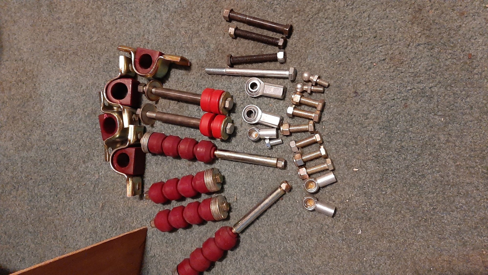

One rattle at a time on these old cars, it just seemed like something not right as the gap shouldn't be there, going to take one out and see what I have, maybe an easy fix as have a bunch of new fiero links as came with my other build

Mabe something here will work or off to ebay i go

You need to use the correct length bolt and spacer not random parts.Any NAPA or other parts chain can provide the correct part.

If I recall correctly, those adjustable links were originally marketed as a "fine tuning tool", as "leigh1322" pointed out in an earlier post, and were sold by Addco, the sway bar people. From what I see in the OP's pictures, is that the "through bolt" on the link(s), is about an inch to an inch and a half too long. Replace the bolt, so you can get a little tension on the spring, before the nut bottoms out, and you'll be OK...........

So I pulled out the old one tonight and turns out same length as the new fiero ones just no spacer so used the spring and I belive it works will see
