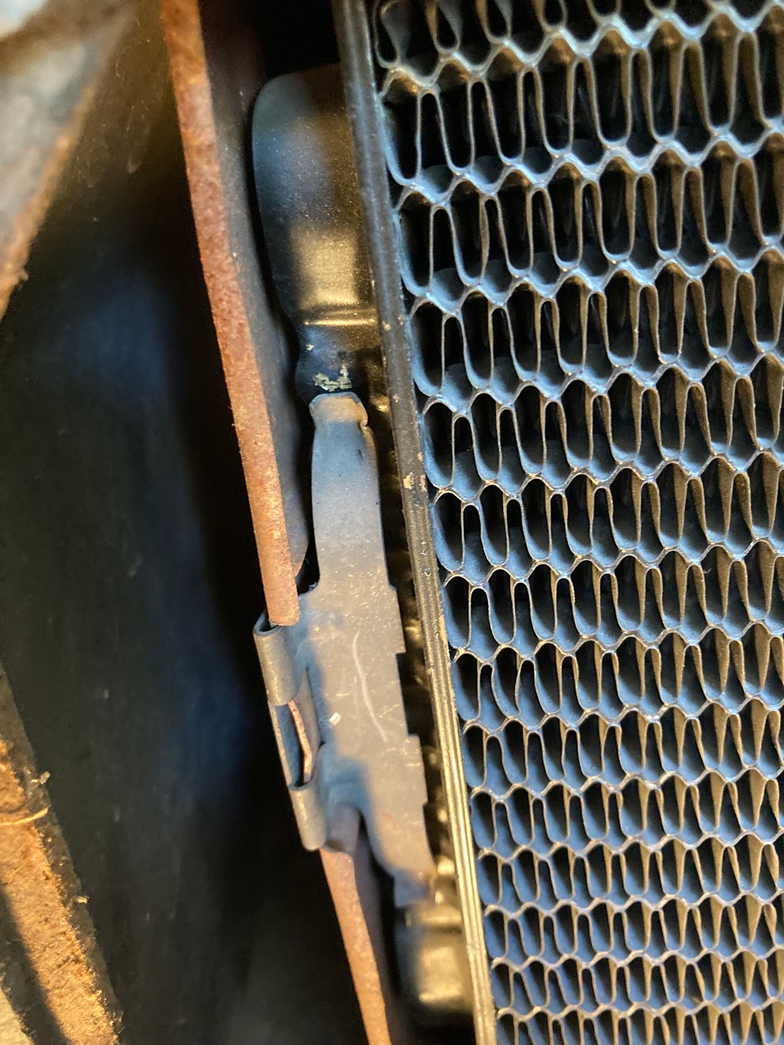

Can you tell me how to remove this clip.

Looks like its still in the car, is that accurate? Removed mine on the work bench, had the whole system out and dash stripped. If i remember it was interesting...pliers , screwdrivers and a third hand...

If I recall correctly, I just used one the "L" shaped picks to slide under the loops and pulled the clip straight back.

Just a pick under the loop and pry outward.

Have tried the pick but it stuck on there, I it being on there for 55 years will make it tough.

Yes that style of clip is designed to dig into the glass. A bit like a fish hook barb. Your going to need to rip it off.

Got it off, thank for advice. Made some sheet metal shims and forced them in and little pry with a screw driver and it popped off.
