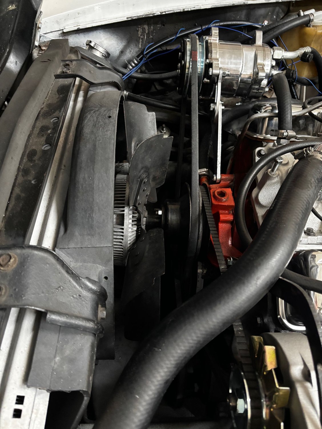

Hoping someone can help with question about fan blades on 1975 stock L48.with 7 blade fan - I have searched numerous threads and can find that there are a number of questions about the spacing between the blades but looking to find out if the pitch of the blades should all be the same or they vary. In picture below the blade in the foreground is about 0.5 in further from the shroud then the one behind it. I have had the fan off and laid on a flat surface and note that all of the blades differ in pitch so it is not just an illusion created by the shroud. There doesn't appear to be any damage to the blades and when fitted and running I do not observe any vibration issues. Is the pitch change just a feature of the design or is there a problem with the blades? Don't want to see it come flying through the hood one day!

On my '76 7 blade the pitch is all the same and there's only about 1 inch of the blades outside the shroud...

Didn't the small block engines have a shroud extension?

Yes. It looks like the car is missing the shroud extension piece, #331870, that attaches with the drilled holes in your existing shroud.
Here's a pic that was posted a few years back from the NCRS judging guide: (Note the main shroud is 339175, extension is 331870.)

Thanks for the responses - I will order the extension shroud (car didn’t have one when I got it). If the blades are all supposed to have the same pitch I may need to get a replacement . Should I just get a blade and do away with the clutch - car is in Florida so basically fan would be running all the time anyway

No, do Not get rid of the clutch. Also consider a 180 or even a 160 thermostat.

I agree: keep the clutch. They work and work well.
The blades I have had experience with are all in the same plane. (Not to a high degree of accuracy, but in a general sense.) Have you tried to slightly tweak the blades that are out of plane with the majority? I seem to recall being able to shift one or two of mine to be in better alignment. (Easier to do when it's mounted on the engine.)

My 76 small block has a different shroud/fan and radiator mounting brackets. there is no provision for a shroud extension could 75 and earlier that requires the extension.

Make sure you have the little foam strip on top of the core too. It's a very important part. My motor dropped ten degrees when I replaced it on my car.
