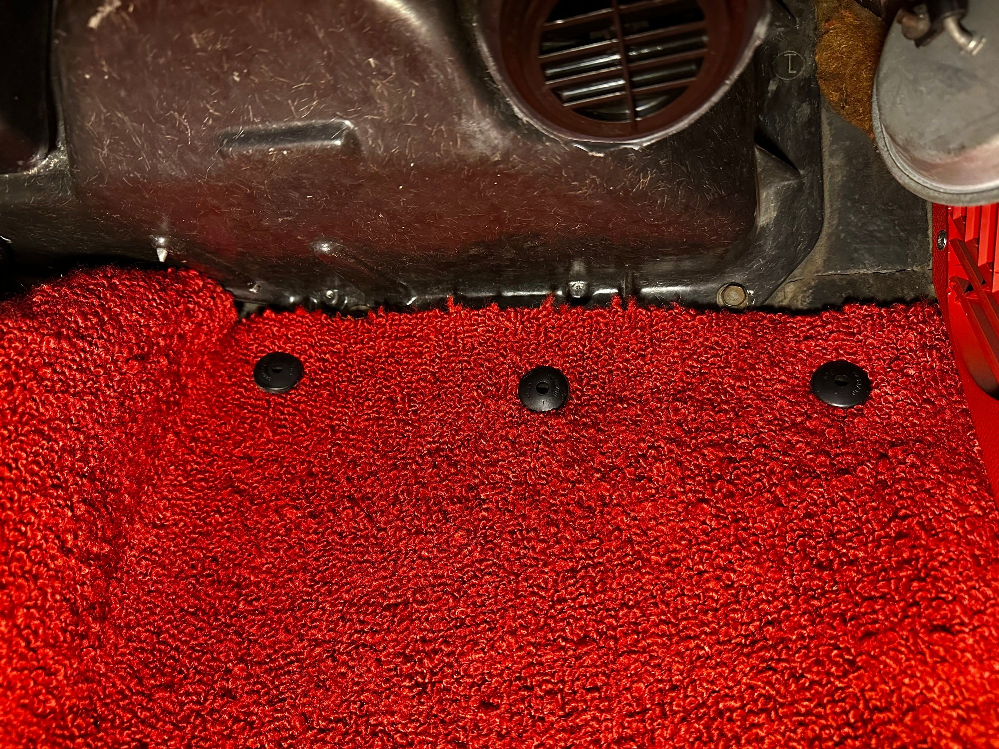

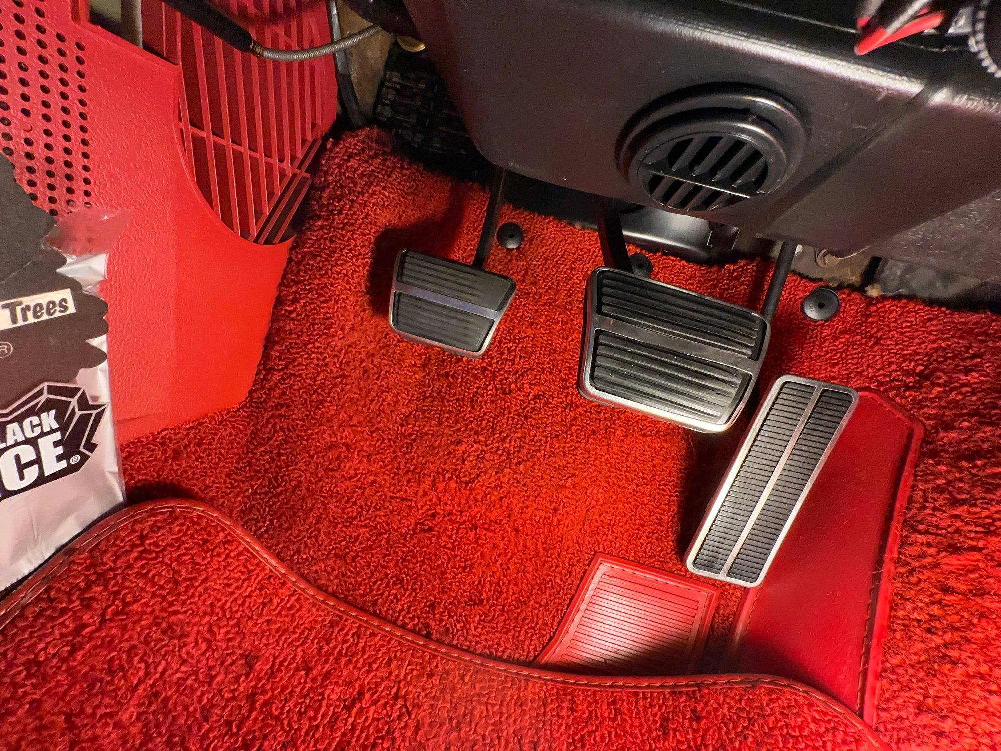

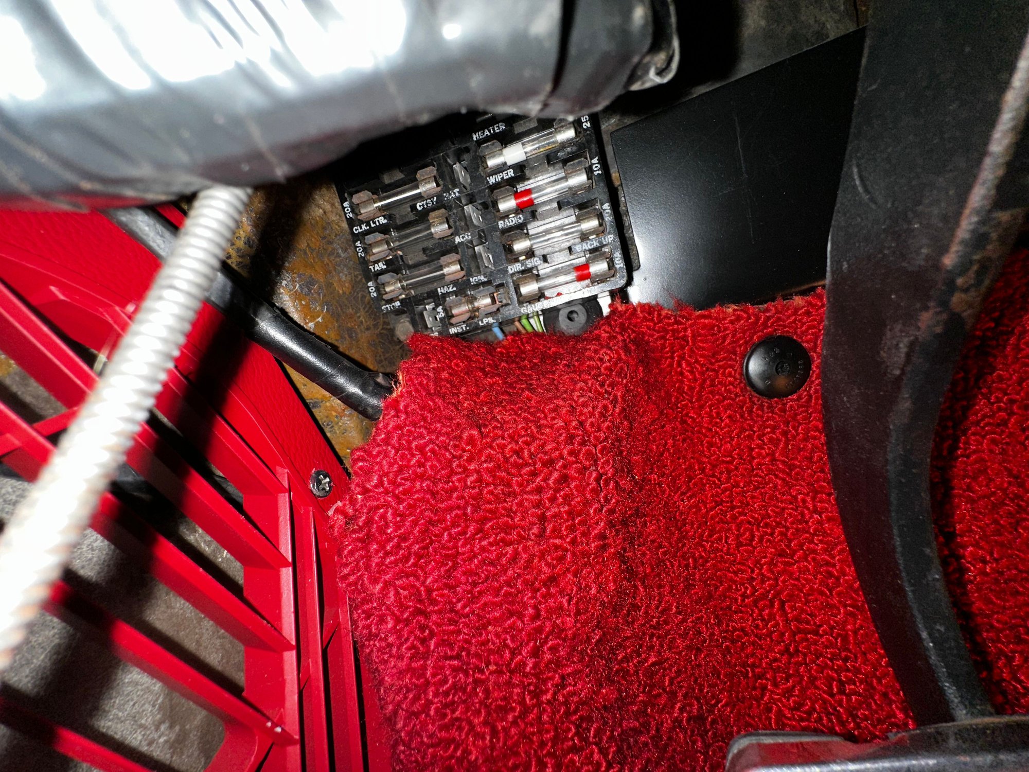

Depending on your year, some of the early C3's used black rubber carpet plugs to hold the top edge of the carpet to the inside firewall. The rubber plugs are Christmas tree shaped on the end of the plug that faces into the firewall to keep the carpet plugs snug against the firewall.
Of course the 3M Super 77 adhesive would work for just about any C3. Sounds like your carpet is a tad short of the fuse box and may need to be stretched a bit. I think that can be done using a hair dryer and a slight amount heat plus pulling to stretch the carpet in that area it to fit better. Then, just follow directions on the 3M Supper 77 can if your car doesn't have or doesn't need carpet plugs.
BTW Alan - great to see you on the Forum again.
Kevin
Driver side rubber carpet plugs for 1969
Close-up of the fuse box for 1969
Passenger side rubber carpet plugs for 1969

Hello,
The photos KS69 posted show the carpet to be just about at the height I'd expect it to be.
Regards....
