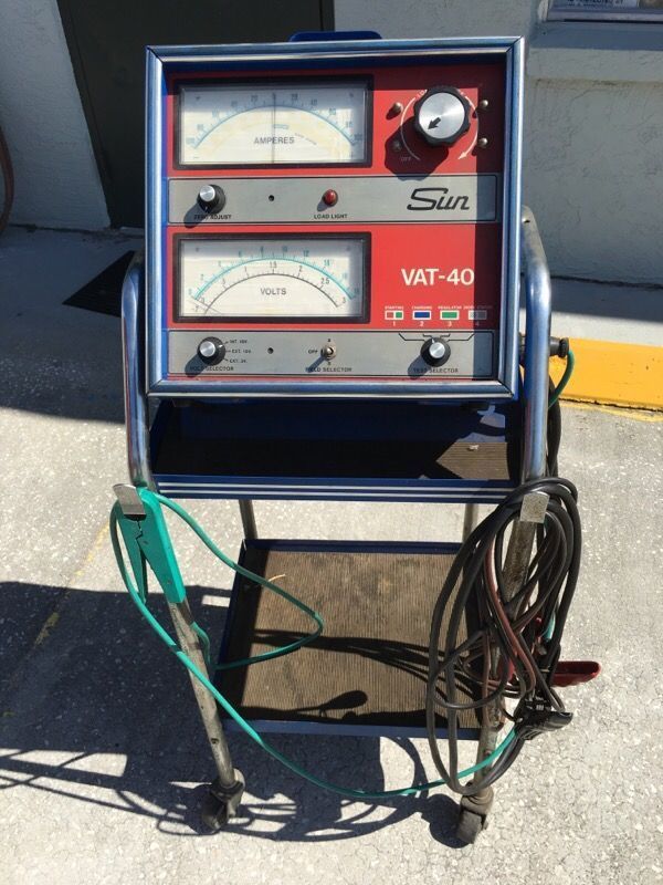

*nothing can reveal (& measure) a faulty battery (even a new but bad one) better than a true carbon-pile load tester; Local starter/alt/gen Rebuilder shops have em.

sunflower 1972's Avatar
sunflower 1972
Joined: Sep 2016
Posts: 2,215
Likes: 971
From: Wauconda IL
Like one of these.
Old Aug 14, 2025 | 04:30 PM
Rebelyell's Avatar
Rebelyell
Joined: Jun 2025
Posts: 1,692
Likes: 589
YES, like a SUN VAT-40
