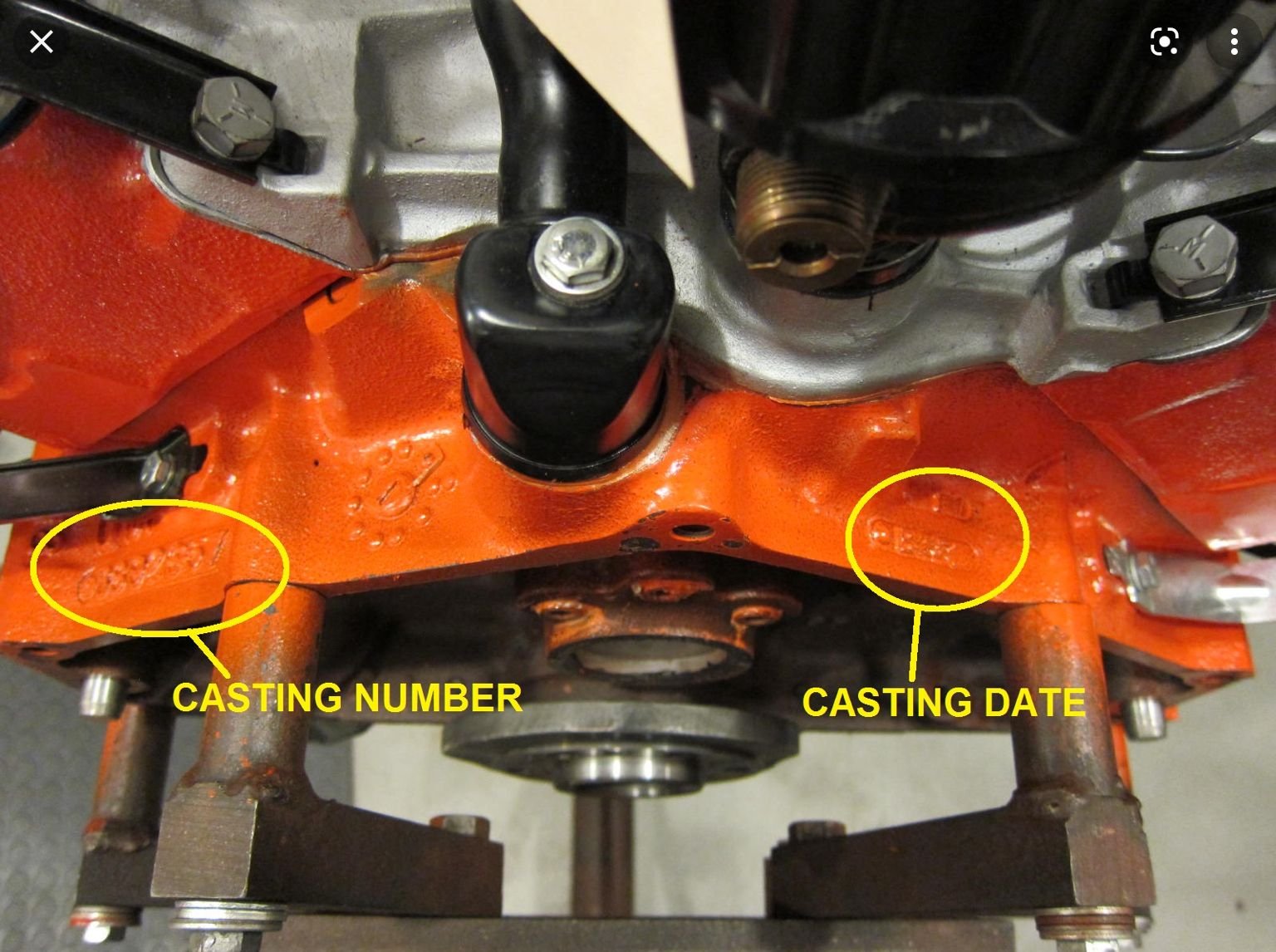

Definitely not the original engine.
Look at the rear “shelf” for the casting number and date.

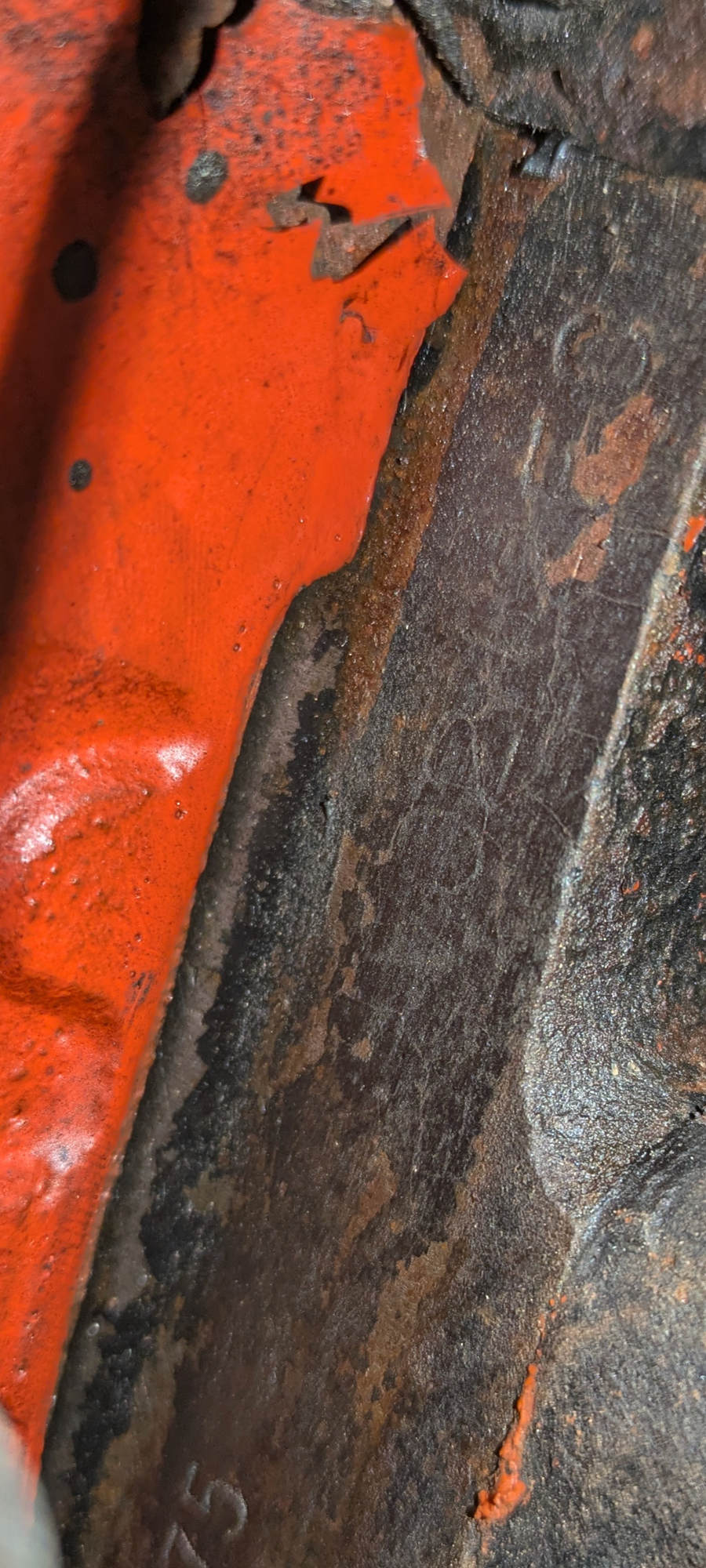

I can't get to the casting number very well.
It was sold as not being original. Just looking to double confirm I guess.The second owner told me the engine is an 1970 (or was it 1971/1972?) LT1.

Tried to take a photo of the rest of the stamping. Looks like. V021__FC
