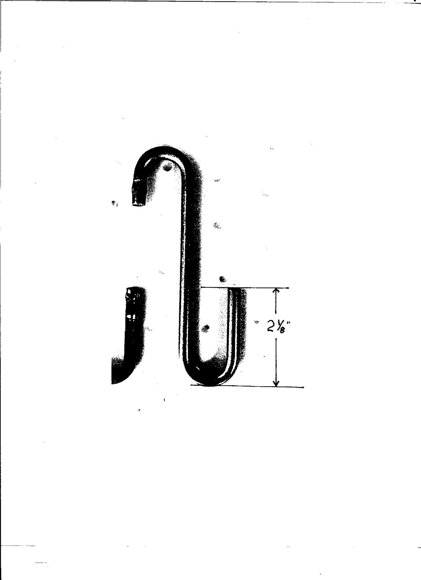

Some springs were not cut correctly, make sure that yours measures 2&1/8"..

Mine are shorter and have a knotch.

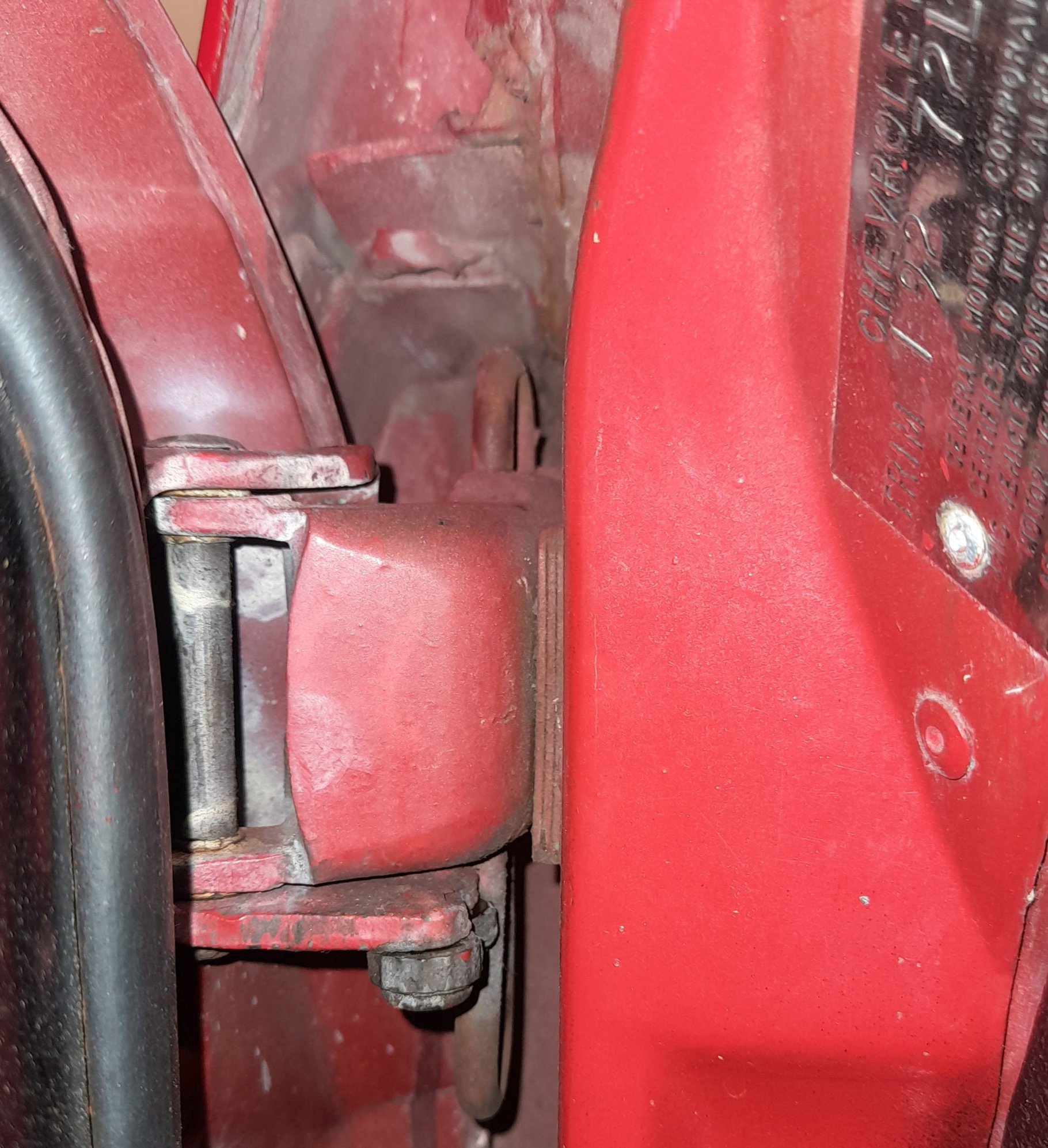

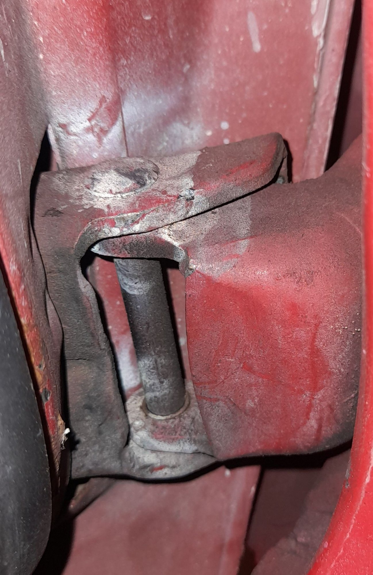

Just to be clear. The hinge that the spring to hold the door open is definitely in the upper position. Definitely.
some pics of my 77. Yes I've definitely worked on this car. But I'm certain these are factory hinges in the factory locations.

Originally Posted by c1nicole
no way to install on the drivers side. They put the hinge that accepts the spring in the bottom! 🤬
I was intrigued by this comment, so I had to nip downstairs and have a look at our '78.🙂
Maybe a '68 is different, but I confess that I couldn't see how the top hinge would actually fit at the bottom, at least with the spring and detent rollers attached. On ours there just doesn't seem to be room.
I'm assuming that someone has had the doors off at some time in the past and re-assembled it incorrectly? A bit of a pain if that's the case, to say the least.😡
