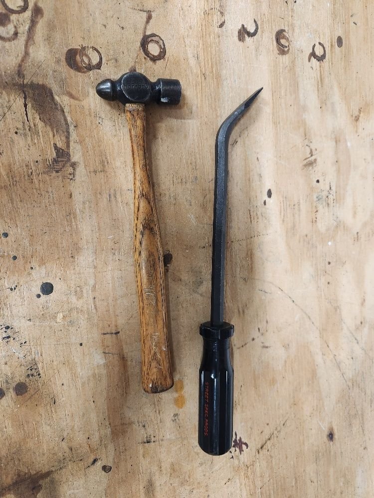

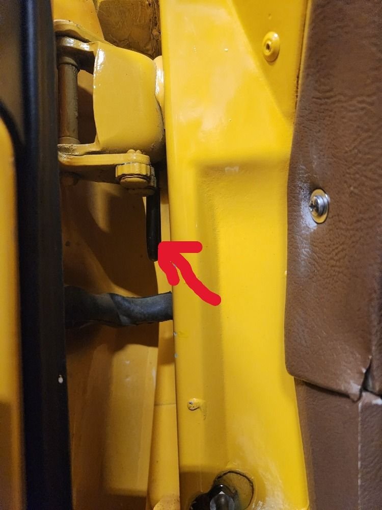

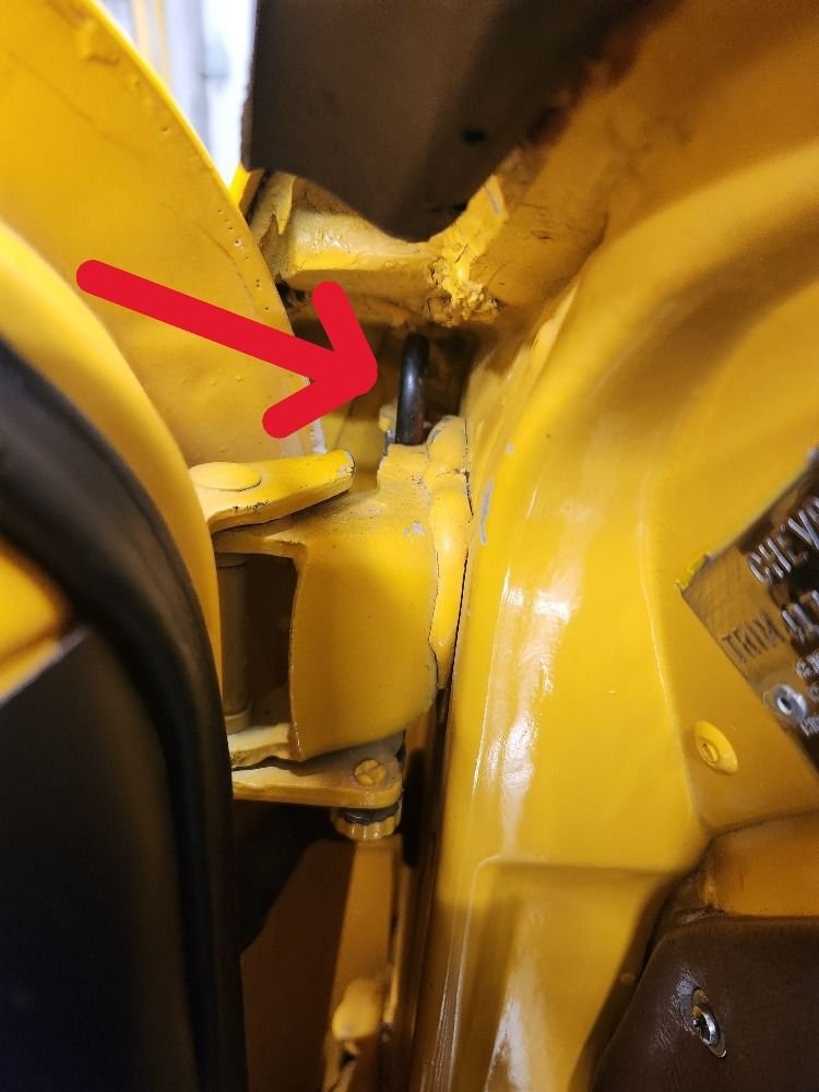

Interesting thread since I just did this yesterday on my '71 driver's side door. I did this years ago on my '77 but initially struggled this time until I watched a couple of YouTube vids. The hardest part was getting the new spring up and into position. I was afraid of scratching something so out of caution I taped off the end of the door, front side and lip just in case I accidently reached around the front while wiggling the spring into place. Better safe than sorry. Like stated previously by others, once I understood how to get it in place and where it went it was a 30 sec job.
I had the tool from way before, a Carlisle swap meet purchase. You kind of need it to "load" the spring and get it into position so when you tap it up the long end guides into the allowed recess space and the "notch" on the top seats into place.
The tool I had & the hammer I used to tap it from below into place
Really hard to see but this is the new black spring in position top and bottom. You'll see the slots and recess on your car and once you see these it all falls into place.
