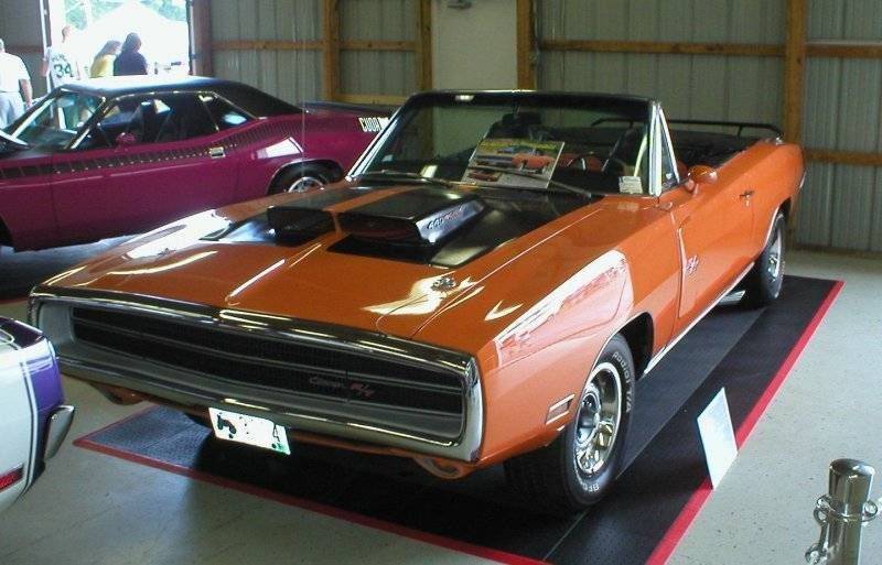

Go forth and go topless! I built this convertible 70 Charger R/T.
