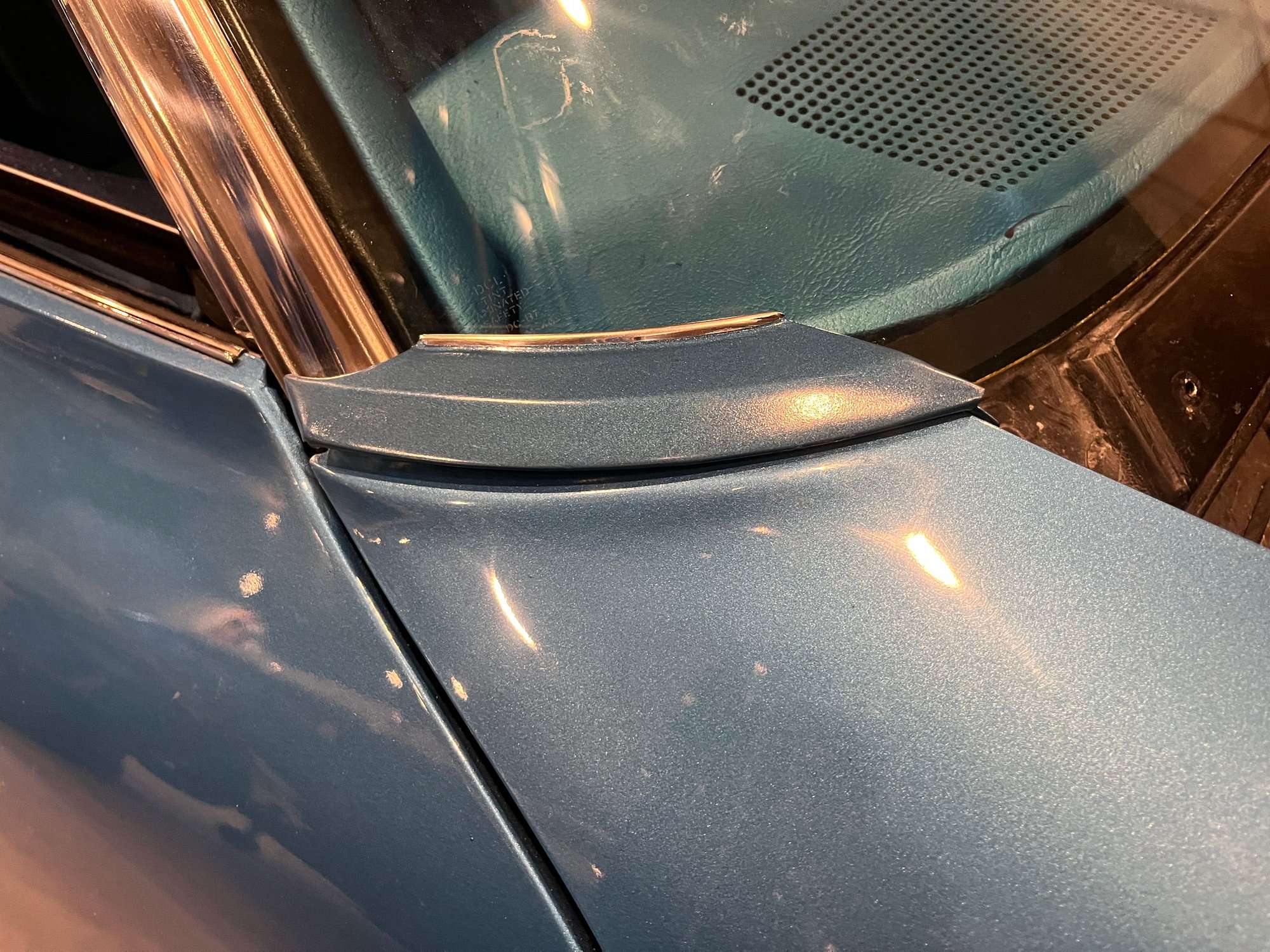

70 c3. Replacing the fender trim on the top of the fender on the corners of the windshield. Is it really just one screw that holds it on? I can’t seem to get them to fit right. It’s like they need some silicone or something to keep them in place. What am I missing 😂. Thanks, Bill

After playing with the screw to make sure it clears the wiper door plus trying to get the clip on in the right place, now I just use only a few dots of 3M emblem glue to fasten these upper rear fender trim pieces. Works great for me. Hope this might help.
(AIM will show the screw as you see plus a clip at the rear of the trim pc.)

Figured it out. Clips holding it on. Thanks😂
awesome. Thanks so much
