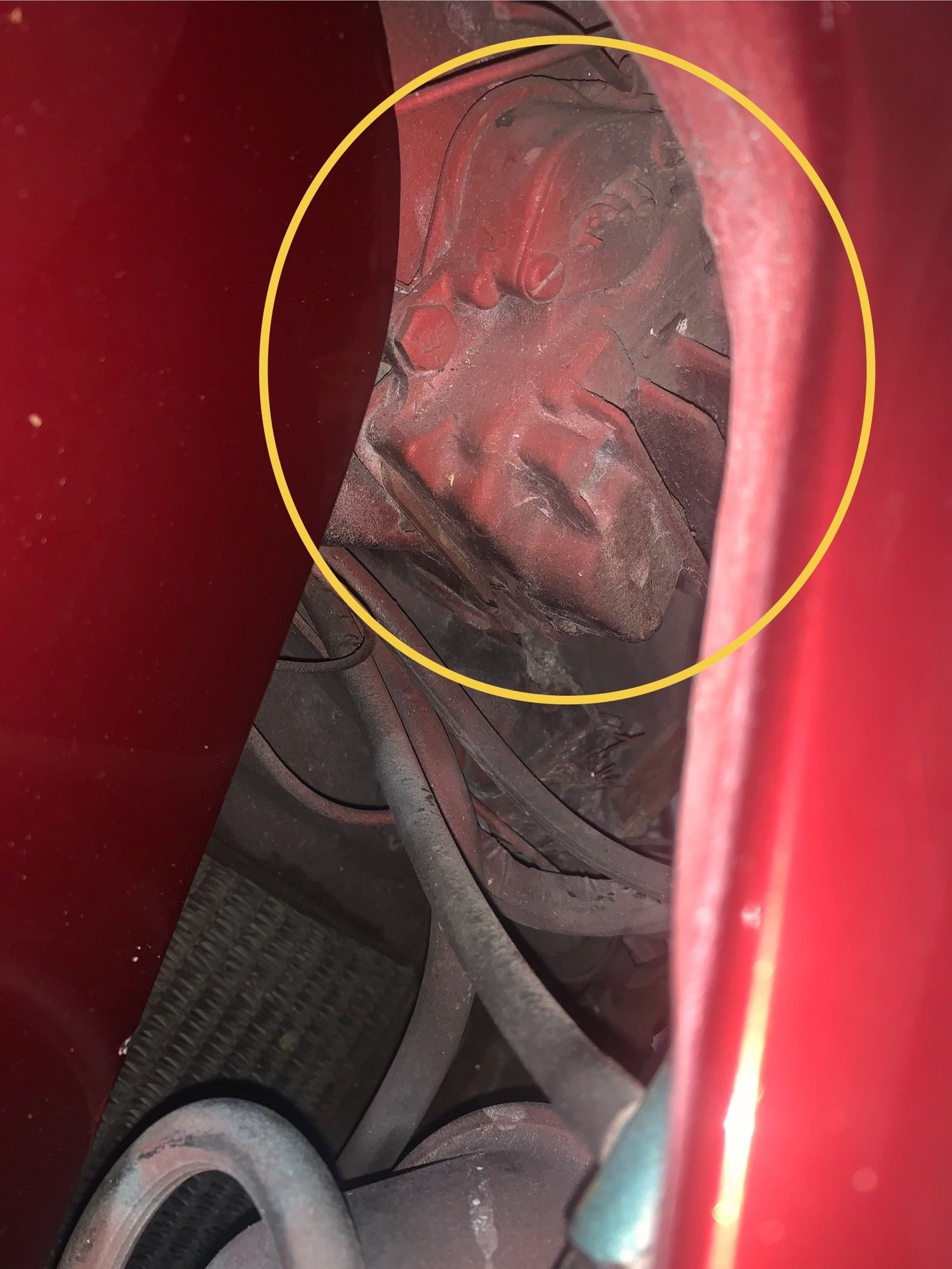

I know it’s covered in paint from the garage repaint before I bought this car 40 years ago…but what is this part ?

That's the amplifier for the transistor.

As GB said, K66 transistor box for the transistorized ignition.

the motor has been replaced is this thing still used? Are they still available for replacement. I know it’s specifically for a big block 69, right ??

It’s not just for big blocks, you could get it with the L46 350hp 350. Also, not all big blocks got the option. It was standard on the L71 but optional for all the other 427’s in 69. This was used for the ignition and would be hooked up to your distributor.
You may not be using it. You have to see if it’s hooked up. Follow the wires from the box and see where they go. If they are disconnected then you will know it’s not being used. Its expensive to replace the system.
Forgot to mention its also standard on the L88..

its GM first attempt of electronic ignition. required for solid lifter BB and optional on nonbase engines

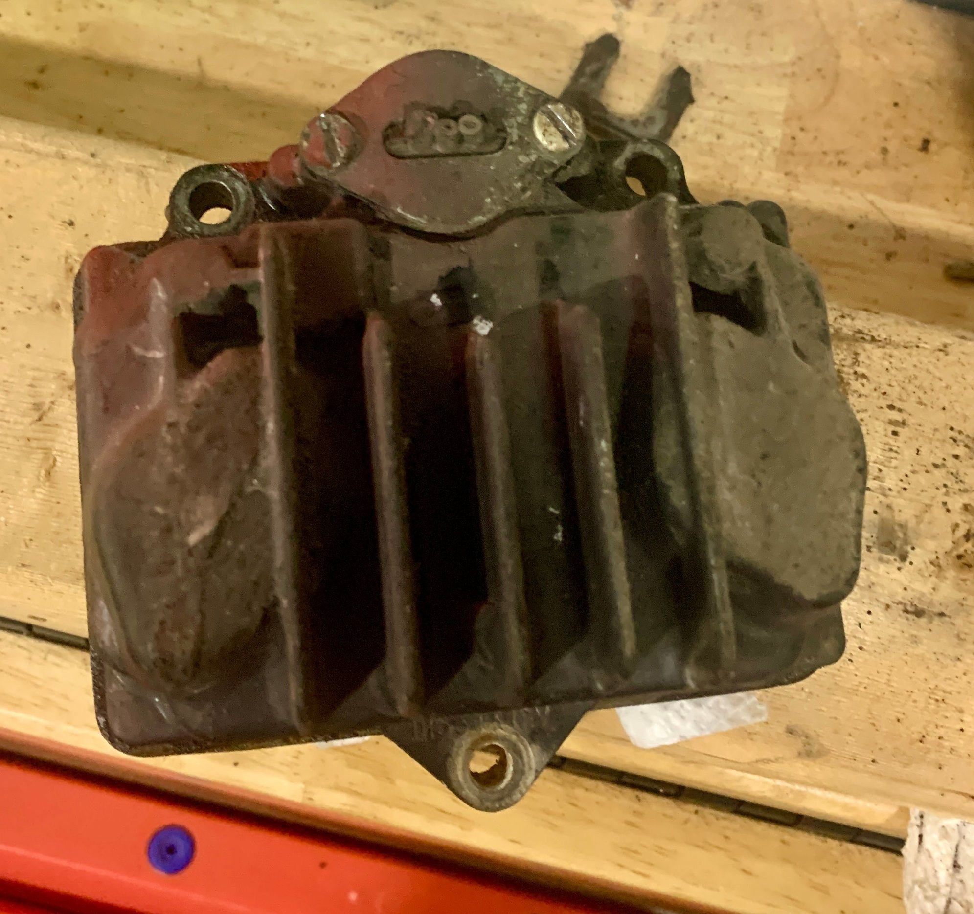

Pulled it out. Had a ground wire attached to one of the screws. The wires coming out were cut. What’s the significance of the numbering on the back?

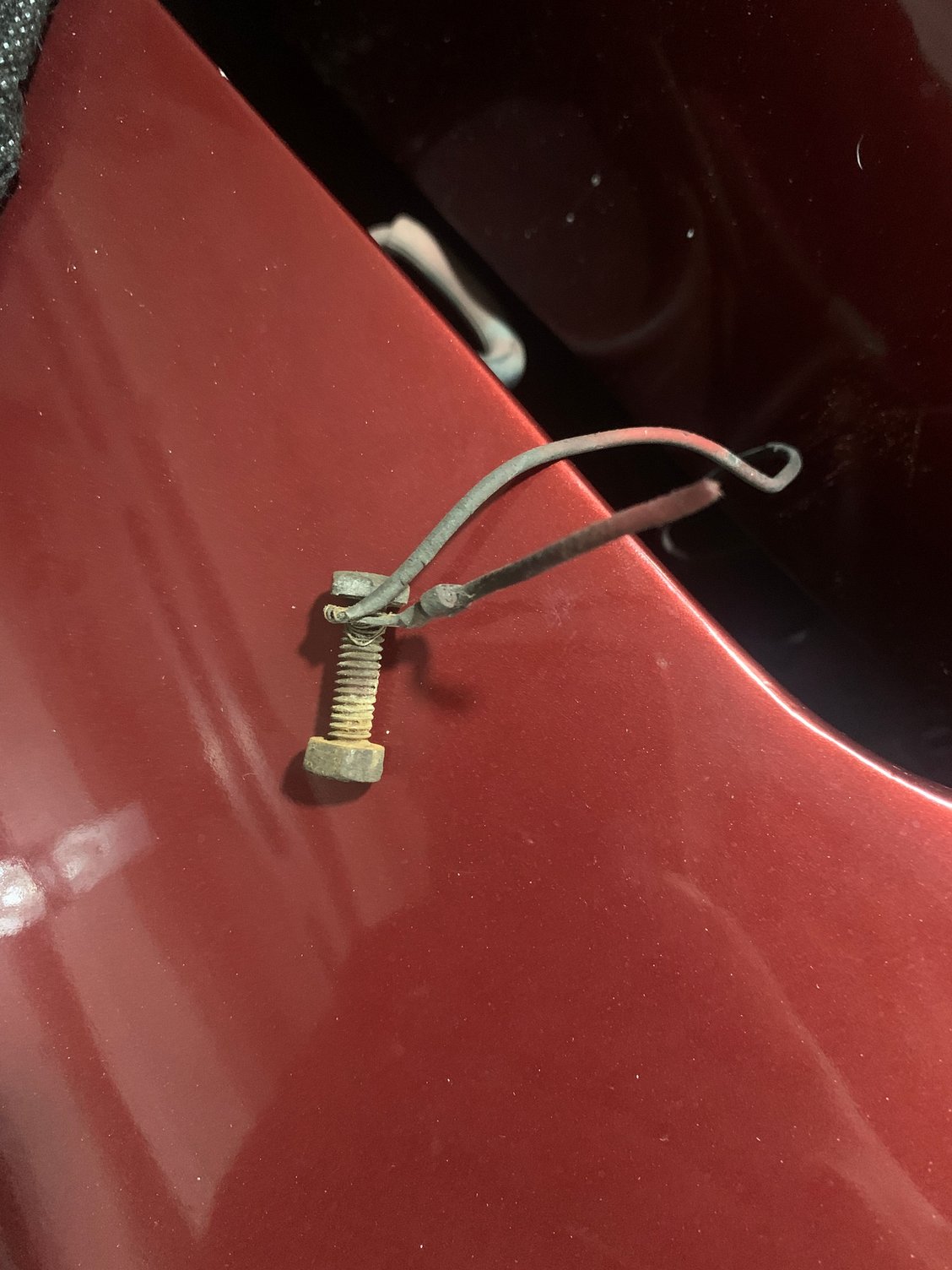

Mystery wire and broken wire attached to one of the 3 mounting bolts

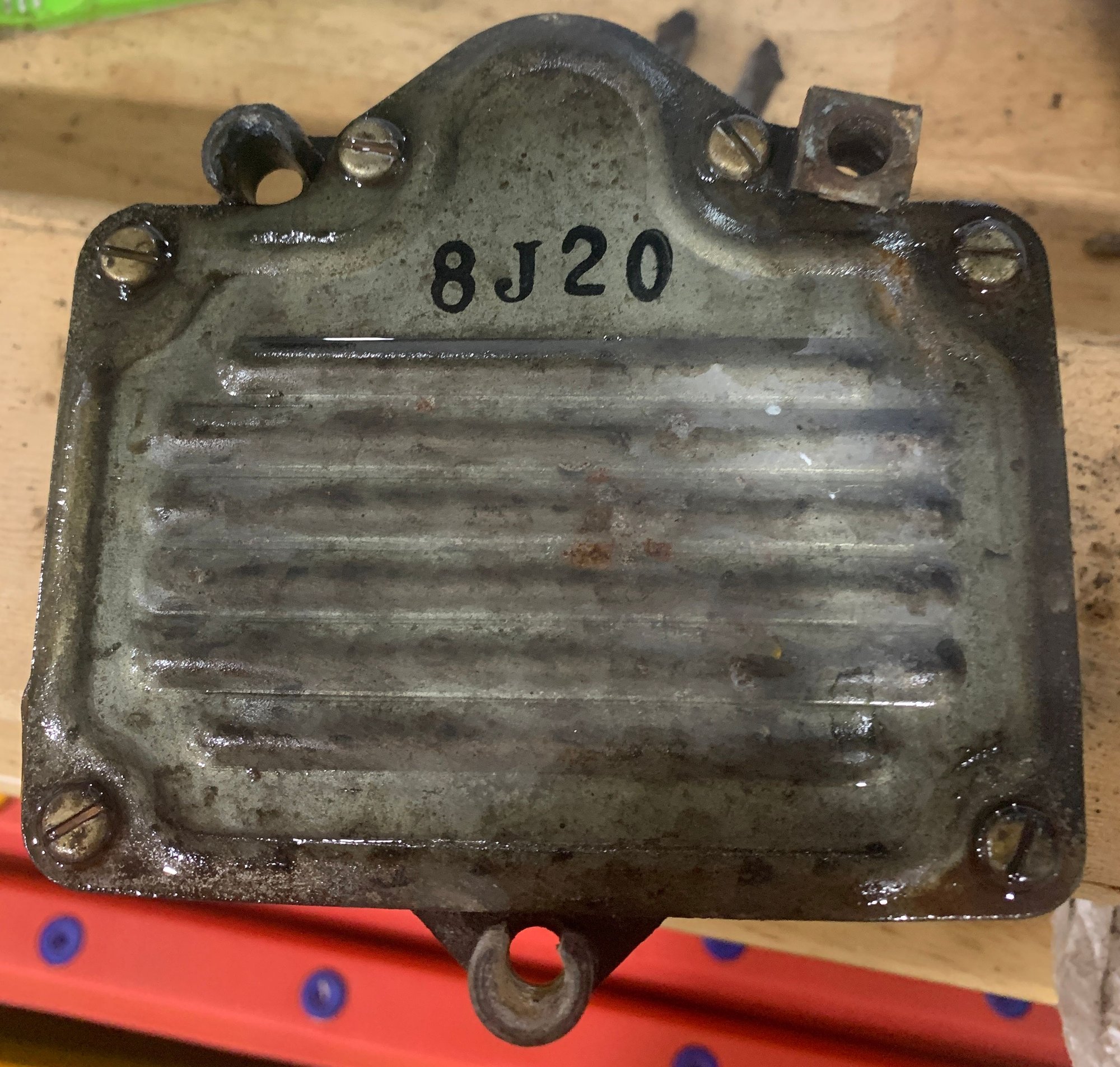

What does the 8J20 signify if anything at all ??

if I was to guess that would be sept 20 1968

did some reading and it is October 20th 1968. Not sure the accuracy of that. My trim tag on the driver side door says October 9th 1968. Not sure where that tag and how long the vehicle takes to get to where the factory installed that module. 11 days seems long, but maybe not.

I think J is September as they skipped over the letter I.

ahhhhh. That would make more sense than October 20th !!

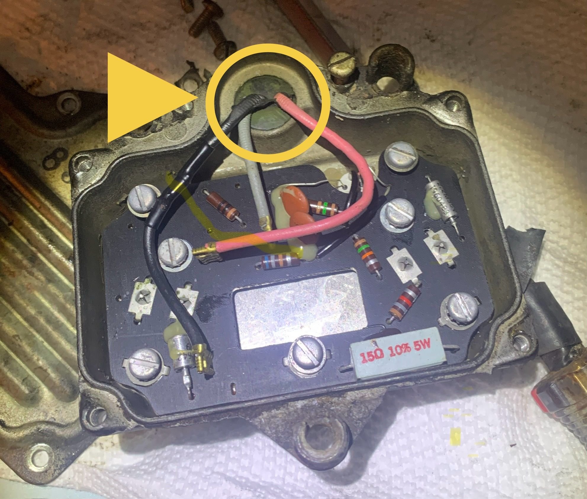

Anyone know the best way to get this rubber plug out ??

Remove the two screws on the out side of the amp box next to where the wires come out

did that. The rubber is pressed in and doesn’t budge.

There's a gent named Dave Fiedler who specializes in parts & repairs of K66 ignition
http://www.tispecialty.com/about.htm

last time I did it the rubber just fell out. Keep working at it
