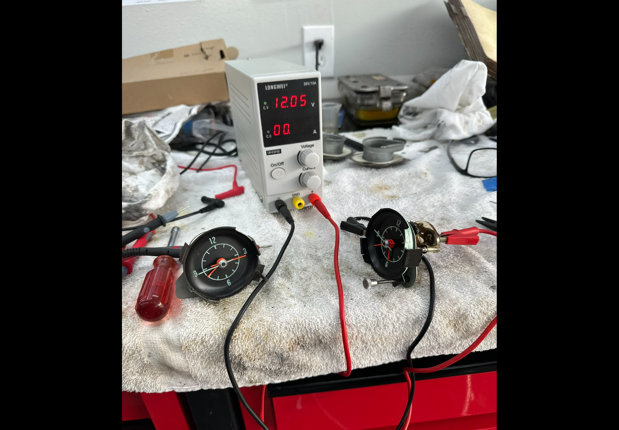

The clocks are easy to fix.
take the back off, use a jewelers file to file the points contact (which often fuse together or become corroded) and then carefully mist the guts with wd40 being careful not to get it on the face of the clock. I then use air to blow off any excess wd40.
Test with 12 volts.
I had 4 non running clocks and every one I was able to get running.
Test with 12 volts.
I did all of that you listed and began working then the second hand started flying, and it blew my powersupply like the one you have totally smoked it literally.
