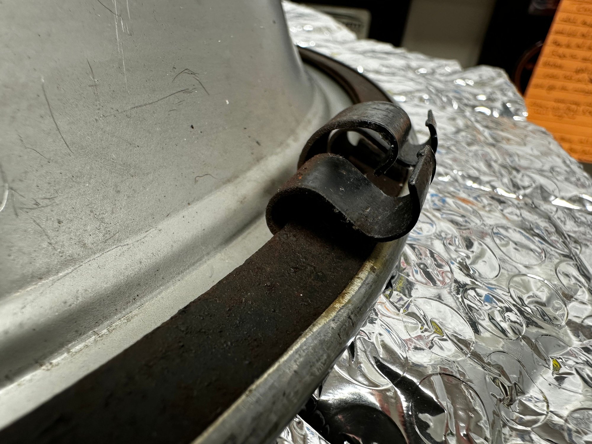

I have a set of NOS trim rings for a 1969 but the four clips that hold the trim rings to the wheel are located in the wrong position for NCRS judging.
Anyone know of a person or company that can install new clips so they are NCRS correct?

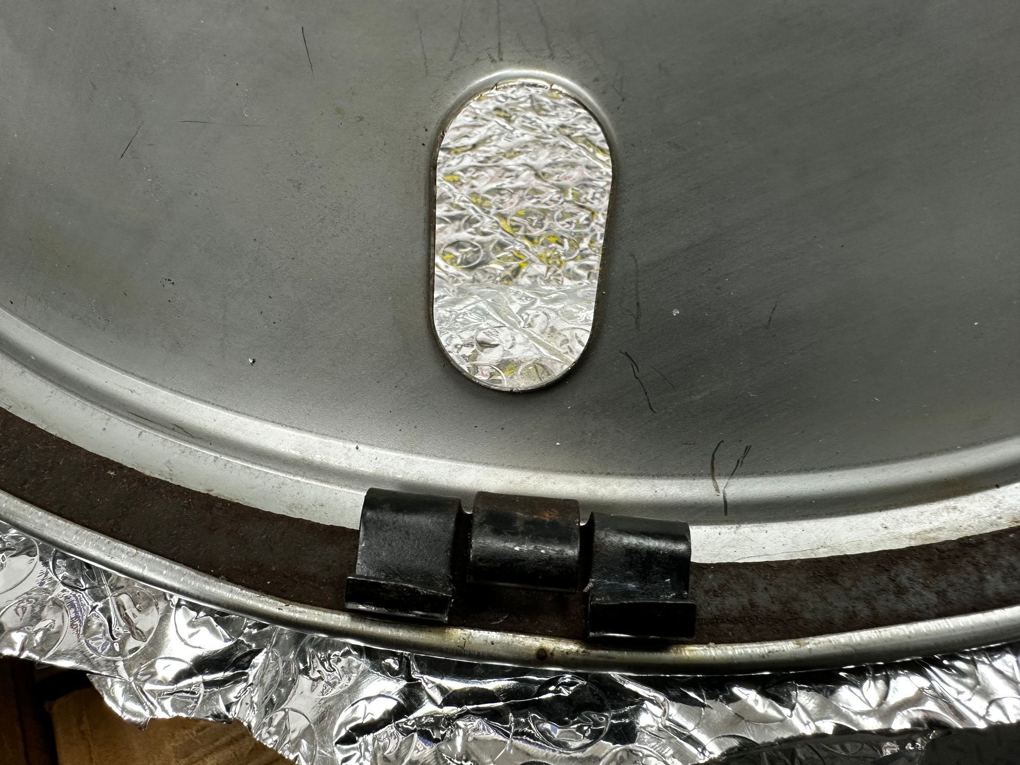

Mine all look like this.
They are not neatly aligned with the valve stem. My car is a January 69 and I bought it in1972 so I highly doubt these are substitutions. Were there multiple suppliers at that time?
I'm looking to sell my pristine set but I would like to put an accurate price on what I have.

Hey ignatz,
From my NCRS 1968-1969 Corvette Technical Information Manual and Judging Guide book, 6th edition, P.96-97, "the trim rings have four black-plated clips equally spaced that hold the trim ring to the wheel. Originals have one of the clips at the valve-stem hole; later GM production has the clip mounted some distance from the hole".
Guessing yours and the first set I was talking about in my OP are both later GM production trim rings.

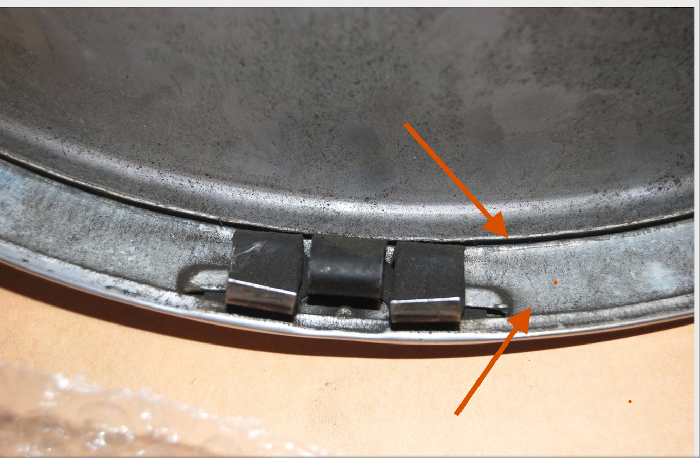

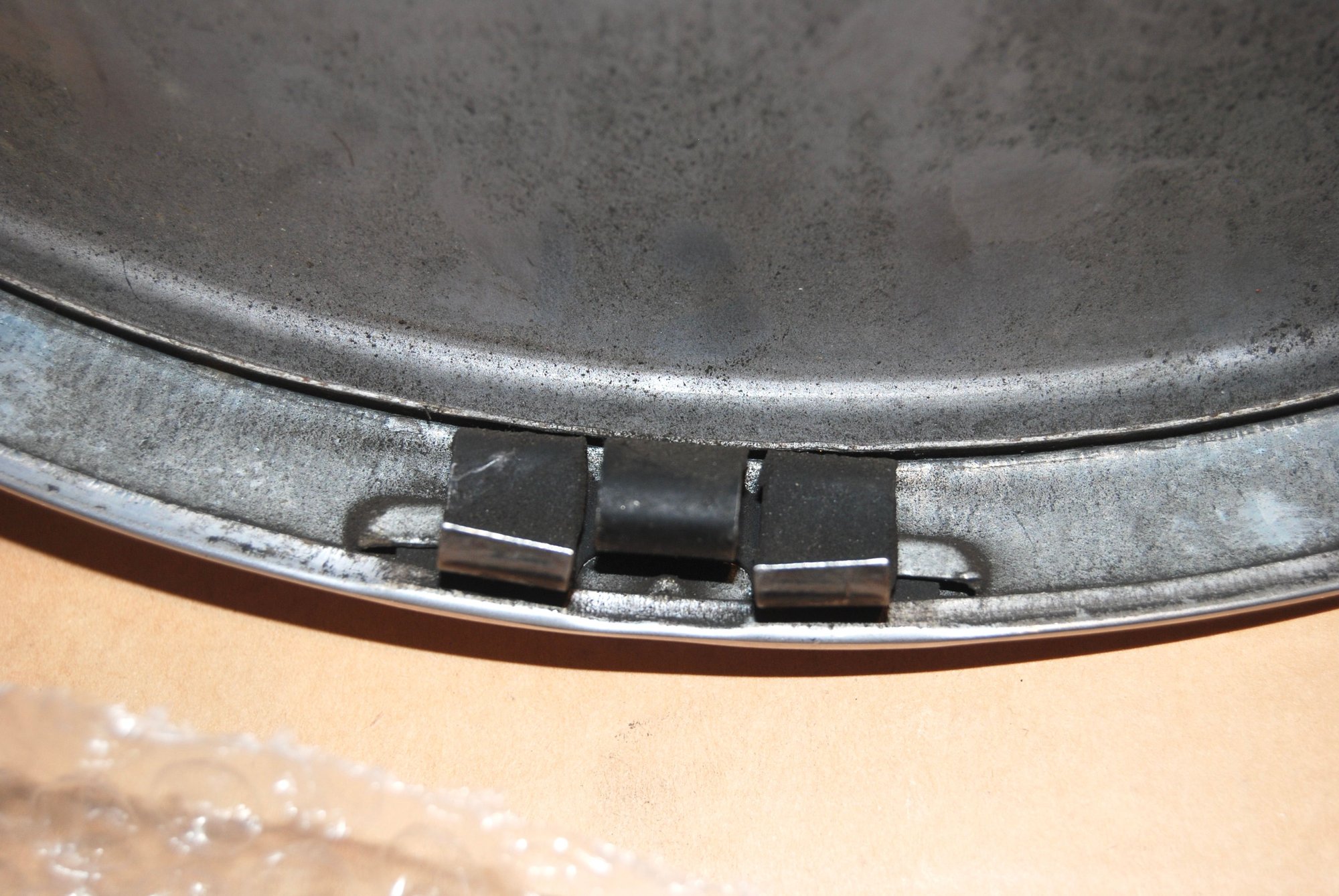

I believe this is the configuration of the 4 wheel trim rings that were placed in the storage compartment of cars in St.Louis.... 68-72 era.
3 prong clips (1 of the 4 clips was aligned with the valve stem hole).
Clips are spot welded to a band.
Band is black and flat (no inner 'lip' on band.)
Band is crimped in place using a smooth crimp. ( some rings that have had the clips/band 'spun' have a rippled crimp).
Regards.......
On a 'side' note...I believe the ring itself is stainless steel but additionally the ring was 'flash' chromed.
Polished stainless steel has a 'yellowsish' hue while chrome plating has a 'bluish' hue.

Do I have any cause to be skeptical that the Holy Bible of the NCRS crowd is always correct? I have owned my 1969 car since 1972. The previous owner had it parked on the streets of San Francisco so maybe somebody stole the originals and put these clankers on? Seems unlikely!

Thanks Stan, I just don't know how to explain what I have. I'll see what the market has been for this variety to put a price on them. They are nearly perfect. I really remember always having these, even banging them on with a rubber mallet.

My car is a late 69, Oct or Nov production, owned since late summer of 70 when a friend who bought it new decided to join the Navy. The trim ring construction is identical to the one pictured by Alan71 and one clip is aligned with the valve stem hole. The steel ring that the clips are welded to is much thicker than what would be necessary to simply carry the clips. My guess would be that the ring is thick to provide a surface for prying the trim ring off the wheel without distorting the much thinner SS from the inside out. The trim ring with the clips welded directly to the SS would appear to be much more fragile in removal or installation.

I was comparing your pic to the pic posted by ignatz where it appears the clip has a couple tabs captured directly under the hemmed area at the OD of the trim ring in addition to a couple tack welds. If there's a full circular ring carrying those clips, I'm not seeing it. Ignatz's car is an early 69 and there were multiple changes from early to late 69. Obviously, 69 would have been the first year for a trim ring to fit an 8" wheel, but one would think, given the millions of trim rings produced to fit the earlier narrower rally wheels across multiple car lines, that the method of attachment of the clips would have been standardized well before 69.

Here's copy of a photo from above...
The upper arrow points to the raised 'lip' (about 1/16" to 1/8" high), on the band.
The lower arrow points to the crimped over trim ring that covers the edge of the band.
The band is what you see between the 2 arrows.
This band configuration is typical of rings that have clips attached to the band with tabs, not spot welds.
I believe the only other Corvette that had rally wheels with hub caps and trim rings were the caps and rings on the 67 model year.
That was a 6" wide wheel, the ring had somewhat different profile but did use the fastening system as on 68+ cars.... 4 clips spot welded to a flat band with 1 clip at the valve stem hole.
Also, the trim ring didn't change when the rally wheels went from 7" to 8" on the Corvette.
On 8" wheels the inner side of the ring is further away from the wheel's hub by 1" than on 7" wheels.
Regards...
