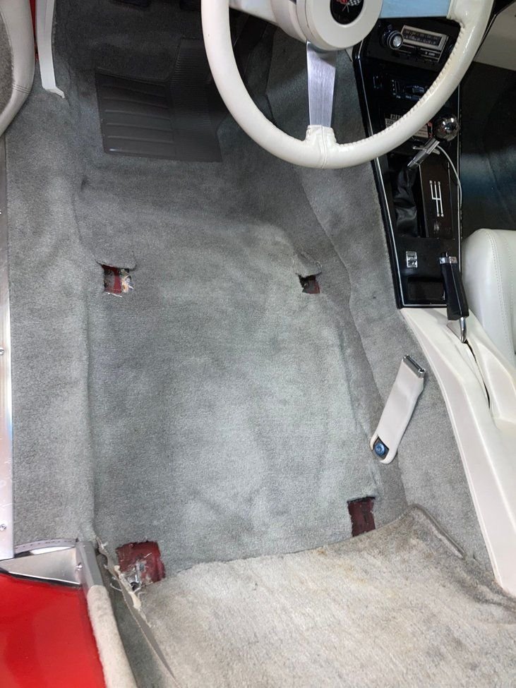

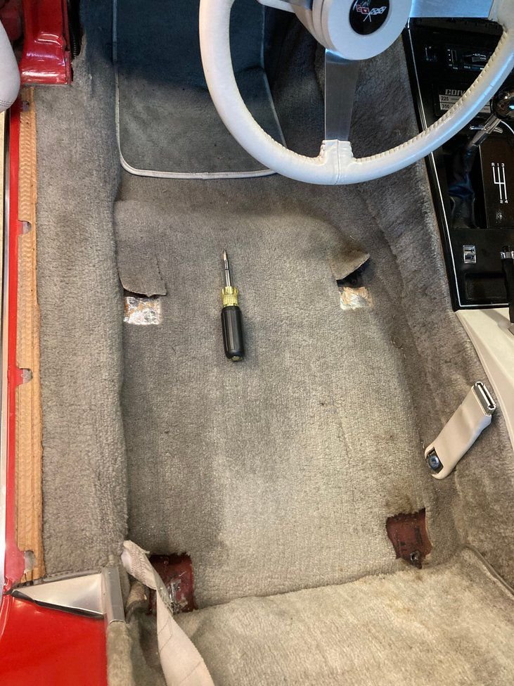

Hello,
At least on 68-72 cars the front 'foot' of the seat mounting tracks extends forward so it is seen when in the car.
St.Louis cut a small 'tab' to cover the foot and bolt.
It's a nice little detail.
Regards....

that's exactly what i did.. the rails are mounted direct to floor. I used OEM to compare as well. I did an ACC carpet install and comparison here.
