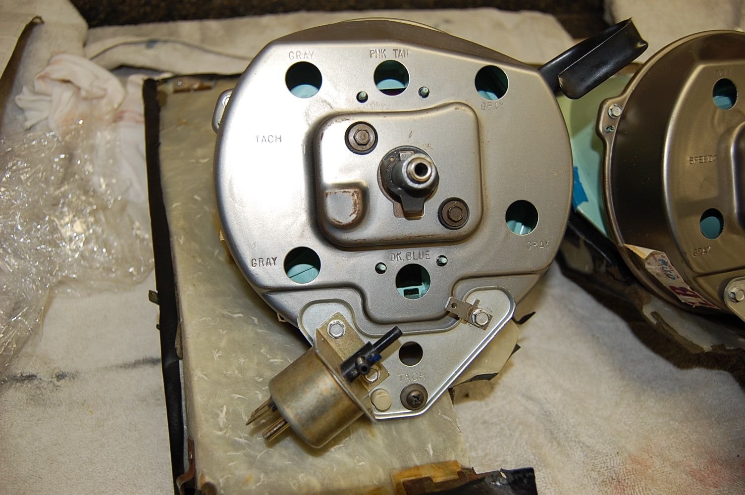

I'm admitting my ignorance here. I'm working on a headlight vacuum/actuator issue, and while checking things under the dash I see a gold cylindrical object with in & out vacuum lines, and also with an electrical connector on it. I don't know what it is or its function, but either way, it looks like its missing a vacuum hose at a tee fitting, and while I'm looking for the missing hose I'd just like to know what the heck it is and does.

Perhaps this might help.
It's typically mounted on the back of the tach housing.

Maybe I missed it... I don't think Alan 71 told you what it is/does.
It's the wiper door solenoid. When the wiper switch is activated this solenoid triggers the vacuum to open the wiper door.

Thank you Alan and barkingrat. That's exactly the information I wanted. I greatly appreciate it.
