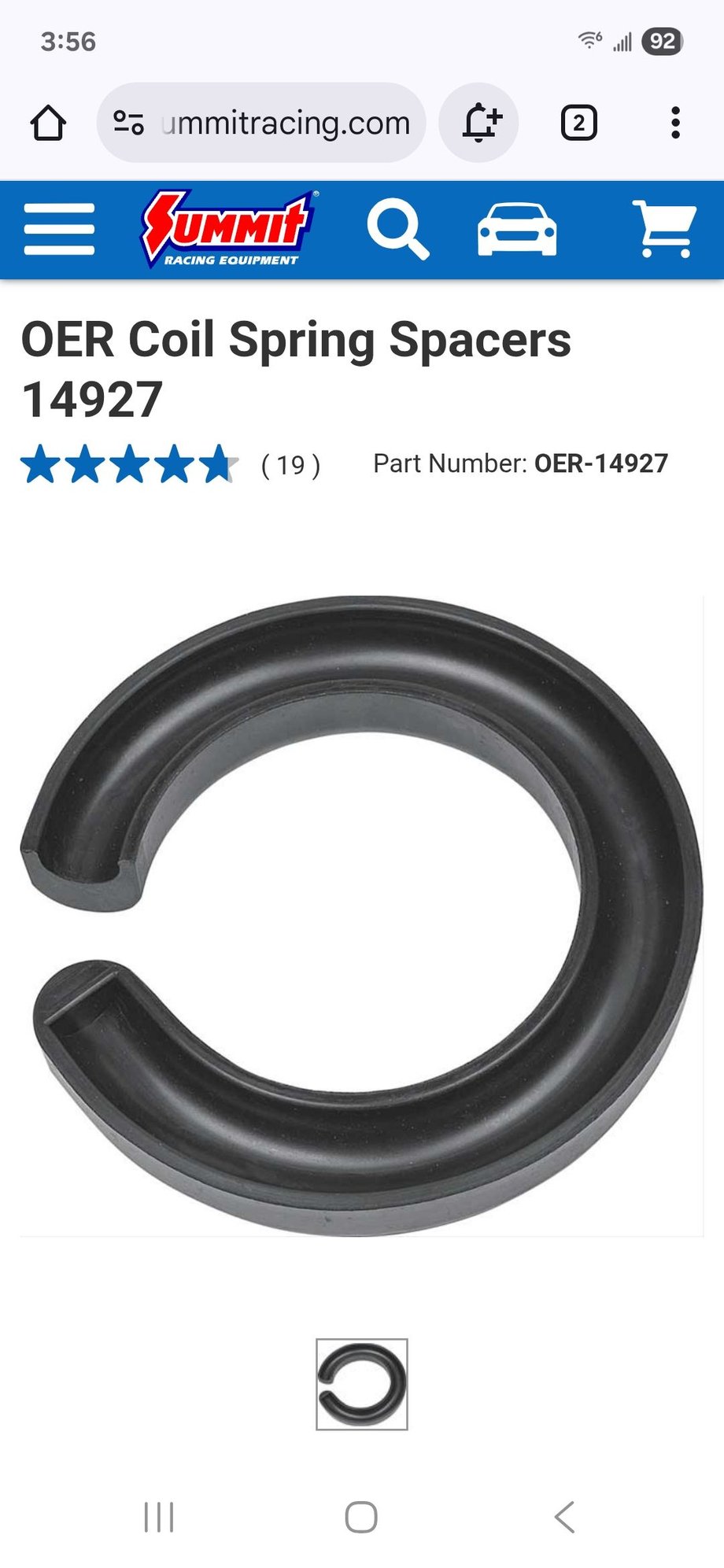

yes they go right on the bottom of the spring... they snap on a bit but adding just a few drops of an adhesive a few hours before install helps keep them in place through reinstalling the springs

I purchased coil spring spacers off of Ebay. Very inexpensive and enables you to dial in ride height perfectly.
they go under the spring. Yes you need to drop out the A arm again. No glue required.

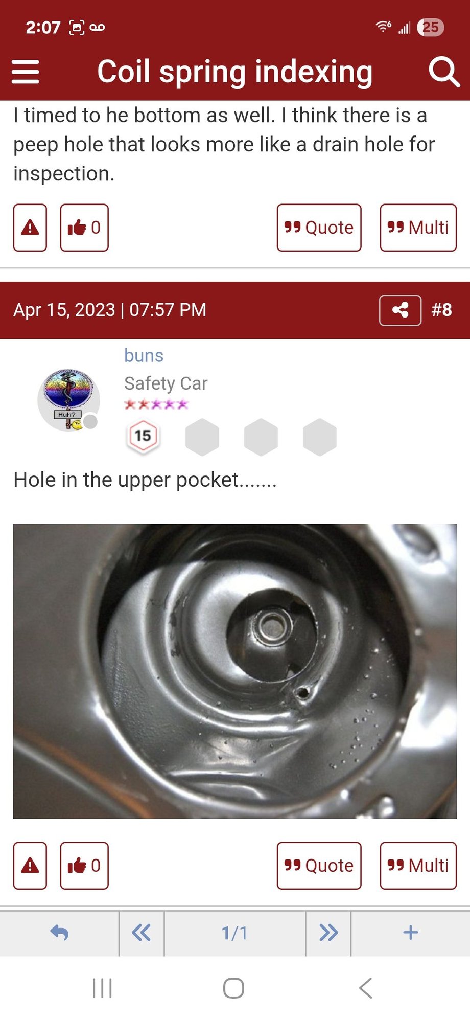

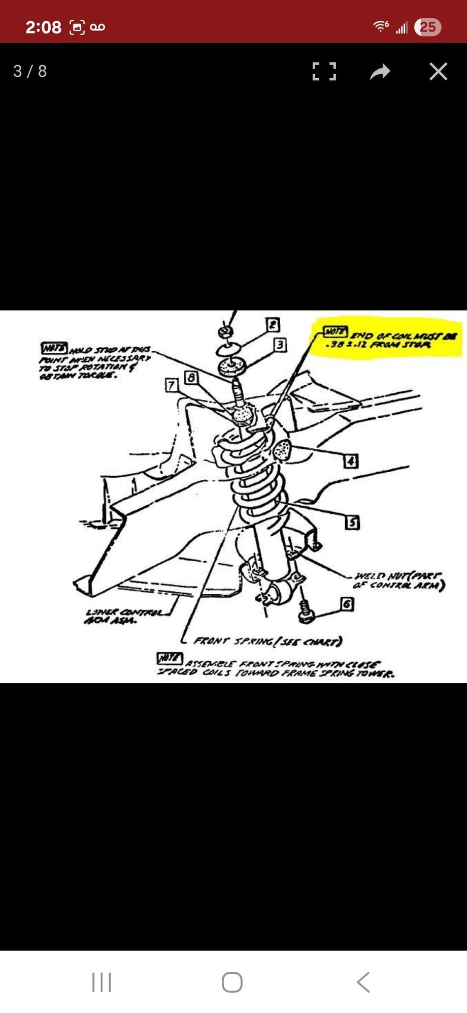

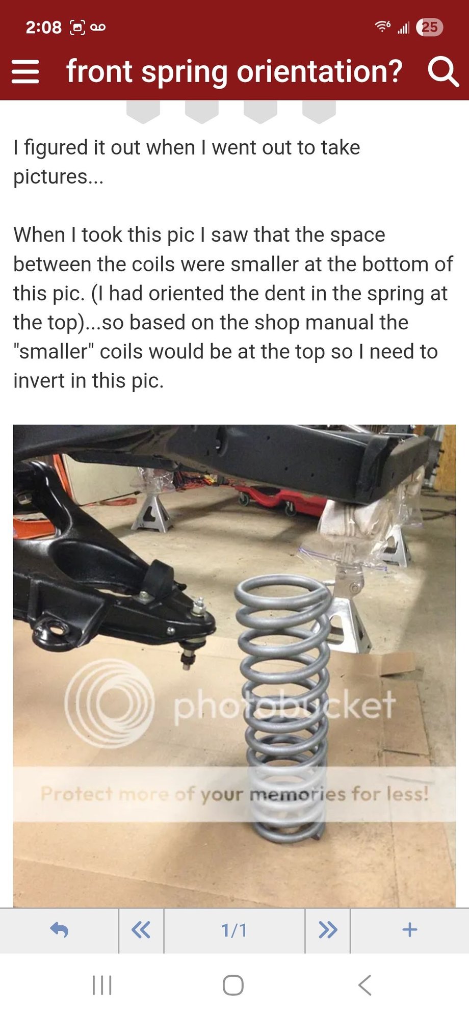

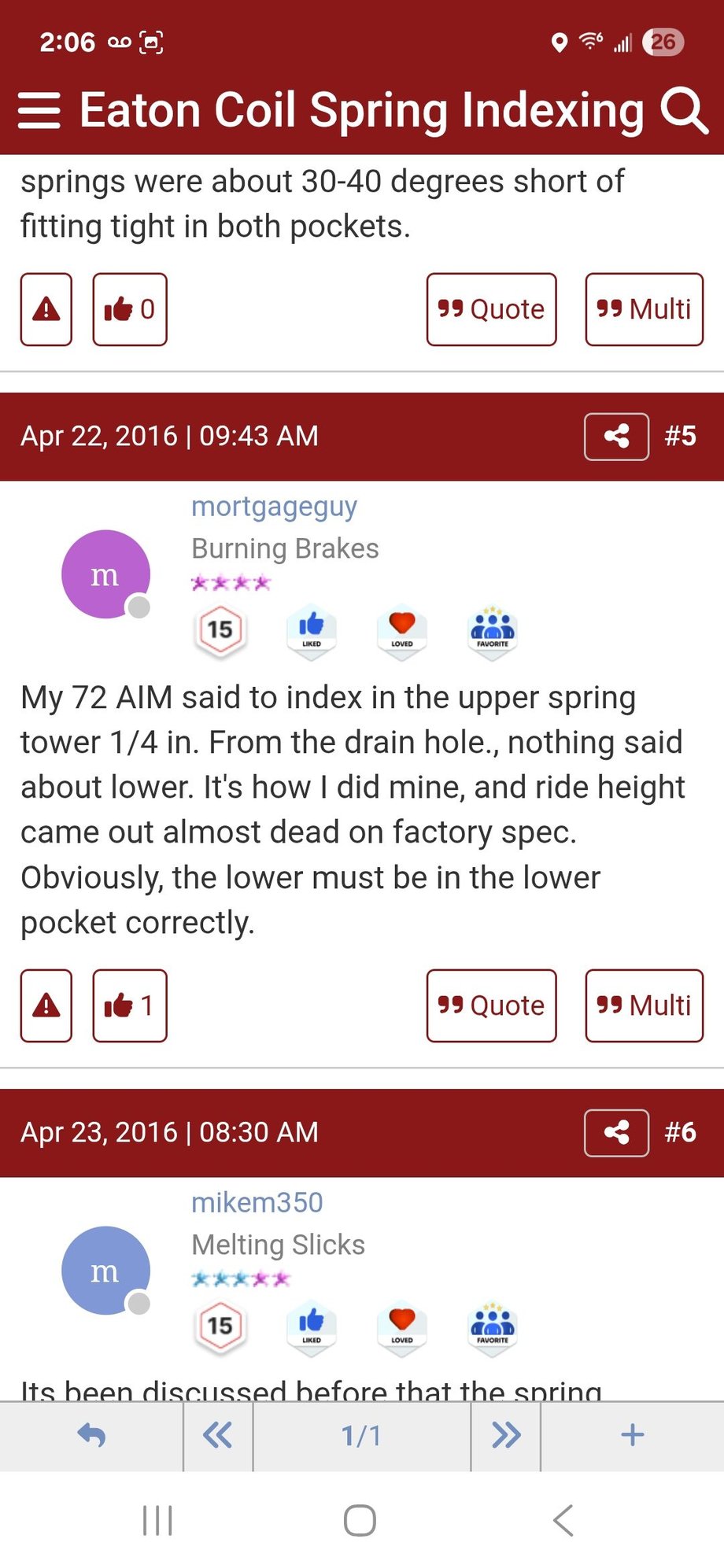

I hate to challenge but have cut and installed many corvette front springs and have always indexed at the top... according to Eaton Spring they say to index at the top pocket... drop a screw down the hole and trun till the top of the spring till it hits the screw and back off just a touch.
I've done juat this on many corvettes... 6 in the past 6 years with great success using the Eaton Spring cut to drop method.
I have also searched this many times on the forum and have always read top, a quick search will show dozens of threads on indexing front spring... also according to some postes the AIM book even says index at the top.
I dint know how imperative it actually is but everything I've ever read says top pocket and its always served me well.
Old Sep 23, 2025 | 07:07 PM
stingr69's Avatar
stingr69
Joined: Mar 2004
Posts: 7,493
Likes: 1,501
From: Little Rock AR
It's the top hole for indexing. The bottom hole is just a water drain hole.

Yeah but when you drop it to much by cutting to much spring and then put a spacer on the bottom , You are going to have 1 stiff ride, ask me how I know
