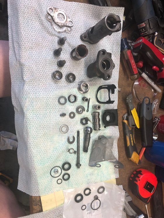

this thread may help. I did rebuild and had to align even though i put back same as removed.
still leak free!
