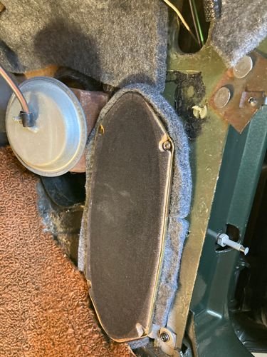

1968 - 1969 Corvettes used two 4x10 speakers in the lower hinge pillar behind the plastic trim piece (which was perforated). These speakers/locations were the same regardless of whether a mono or stereo am/fm radio was installed.
Regards....
Hinge piller
69 interior lick panel
71 kick panel

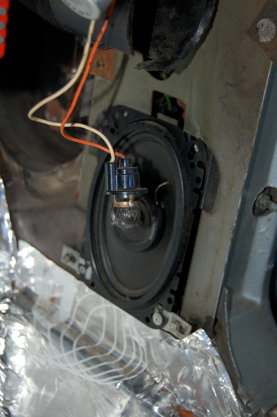

The speakers bolted to the body, using the area in green in Alan's photo as (I suppose) a somewhat convenient acoustic cavity. Bolting to the plastic panels sounds like an unlikely solution, probably picking up a lot of unwanted vibratrion.
Here's an old picture. I've since put better speakers in placc but at least you can see how they mount

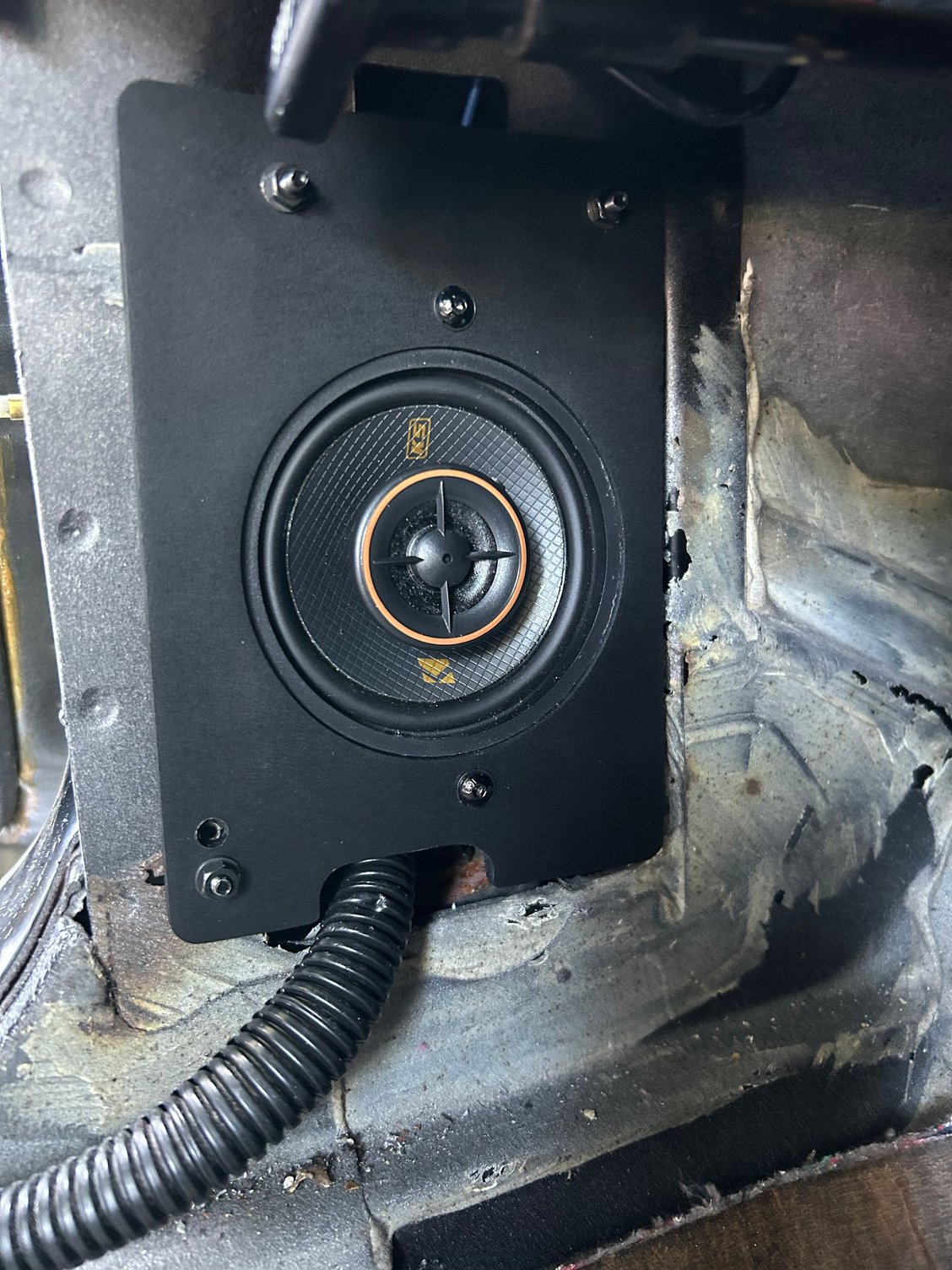

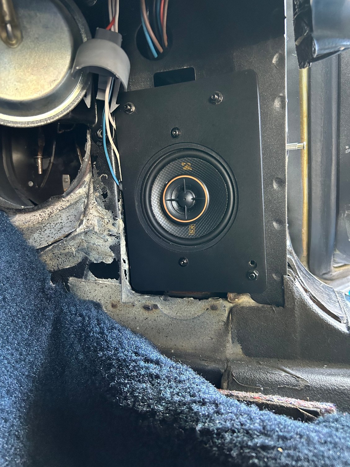

I made brackets to mount the speakers.
