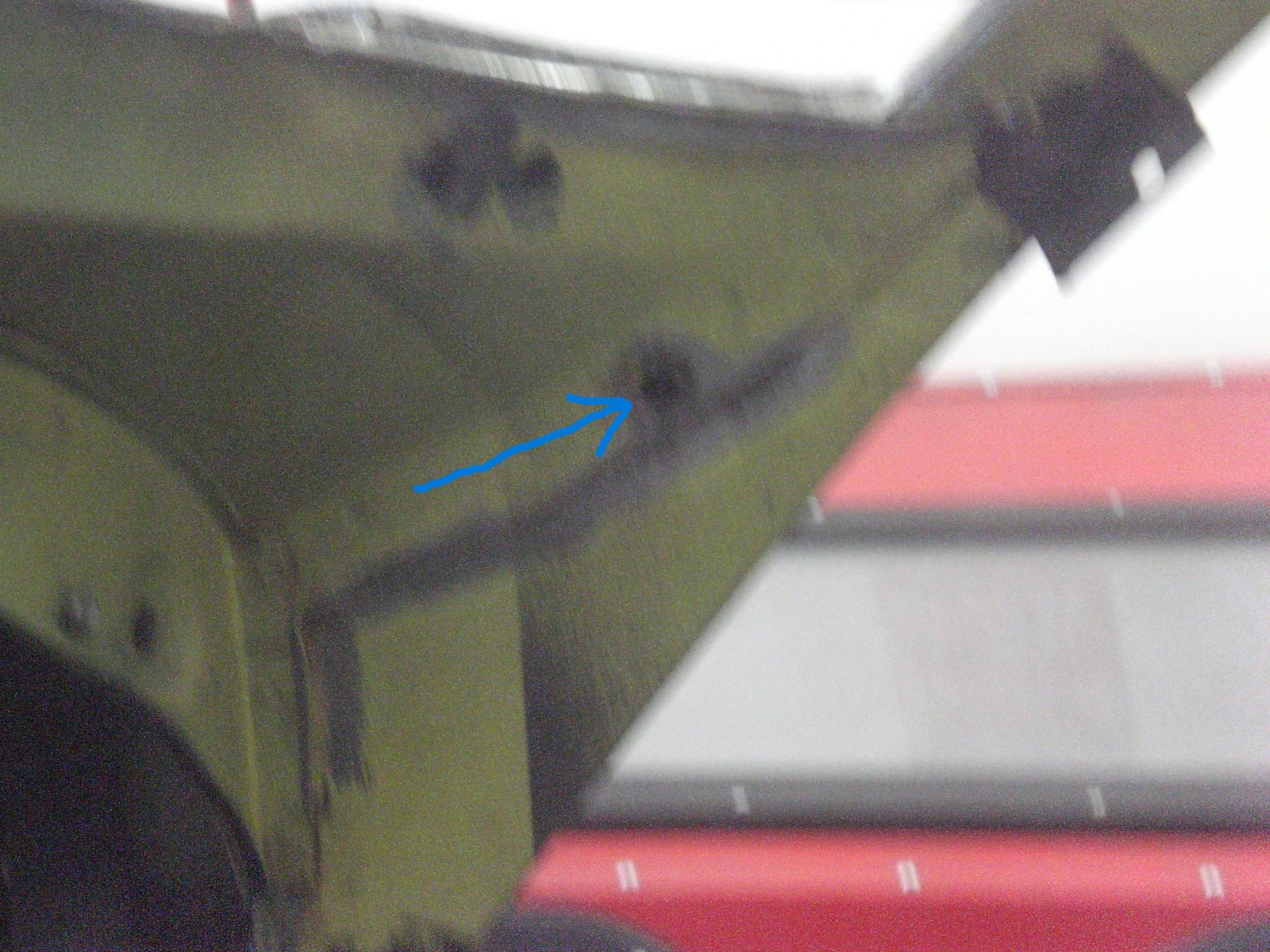

I was trying to spray internal coating into the widshield frame and had zero problem with the lower frame & lower corners and the left side frame, but could not get the applicator hose to go up into the right side.
Indicated hole allows access, but only about 3-4
Indicated hole allows access, but only about 3-4" up towards the right side frame then it's blocked. Worked fine on the other side...
Is that "normal" and have any of you members found the same thing?

Hello,
Does this give you a hint as to just what's in there?
Regards...
Note! right side..
