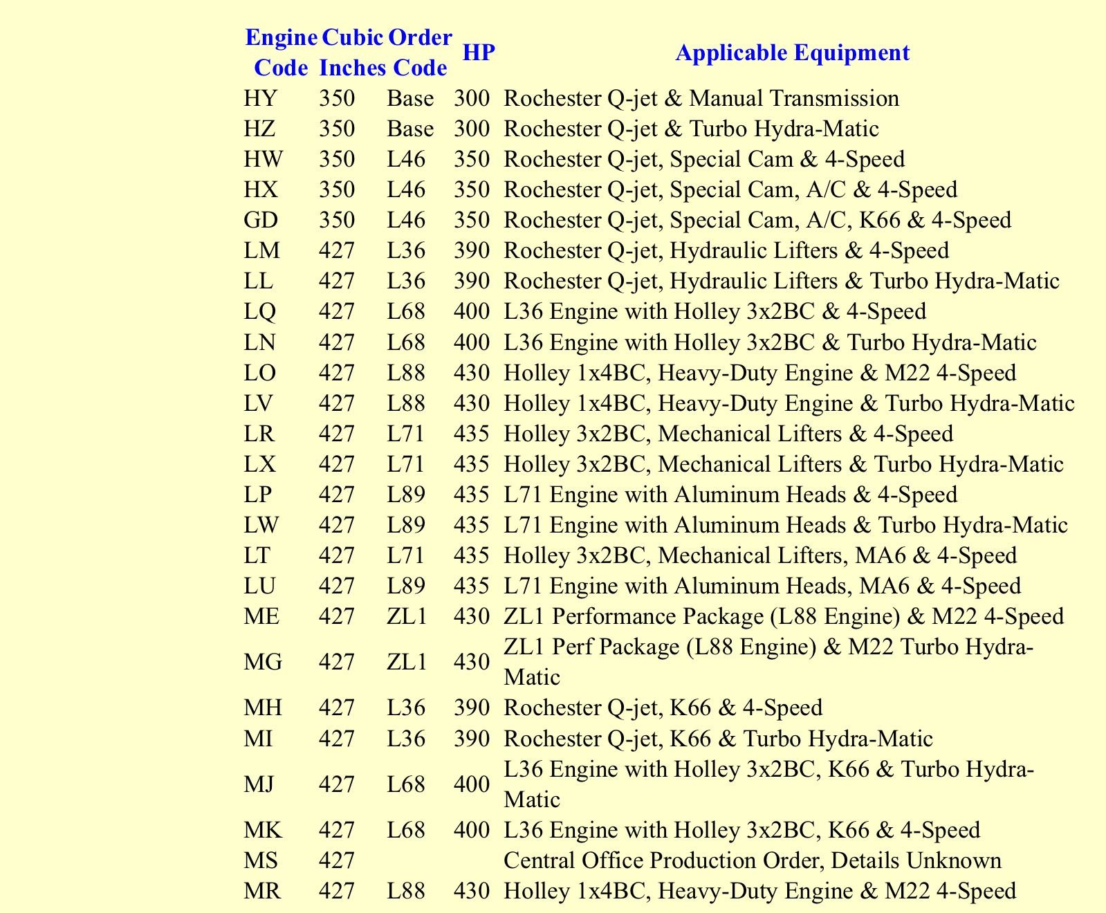

Here is a listing of all 69 engine codes

"1"s and "I"s were often substituted for each other in engine stampings. And "6" and "9"s were often flipped to make "9"s and "6"s.
"T" is the Tonawanda engine plant, "11" is November, "06" is the sixth day of November and "LE" is a 427/3305 out of a 69 full size as Bikespace noted above. On any day at Tonawanda (or Flint for that matter) November could turn up stamped as "11", "II", "I1" and "1I".
