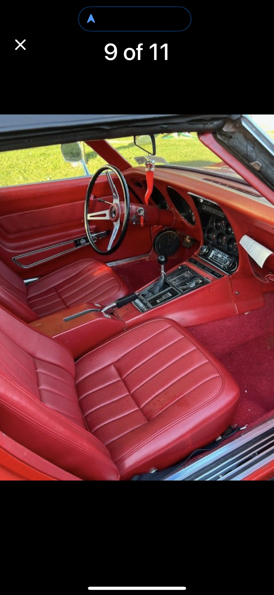

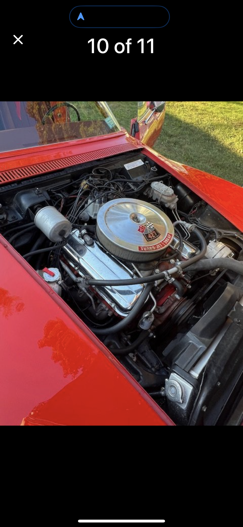

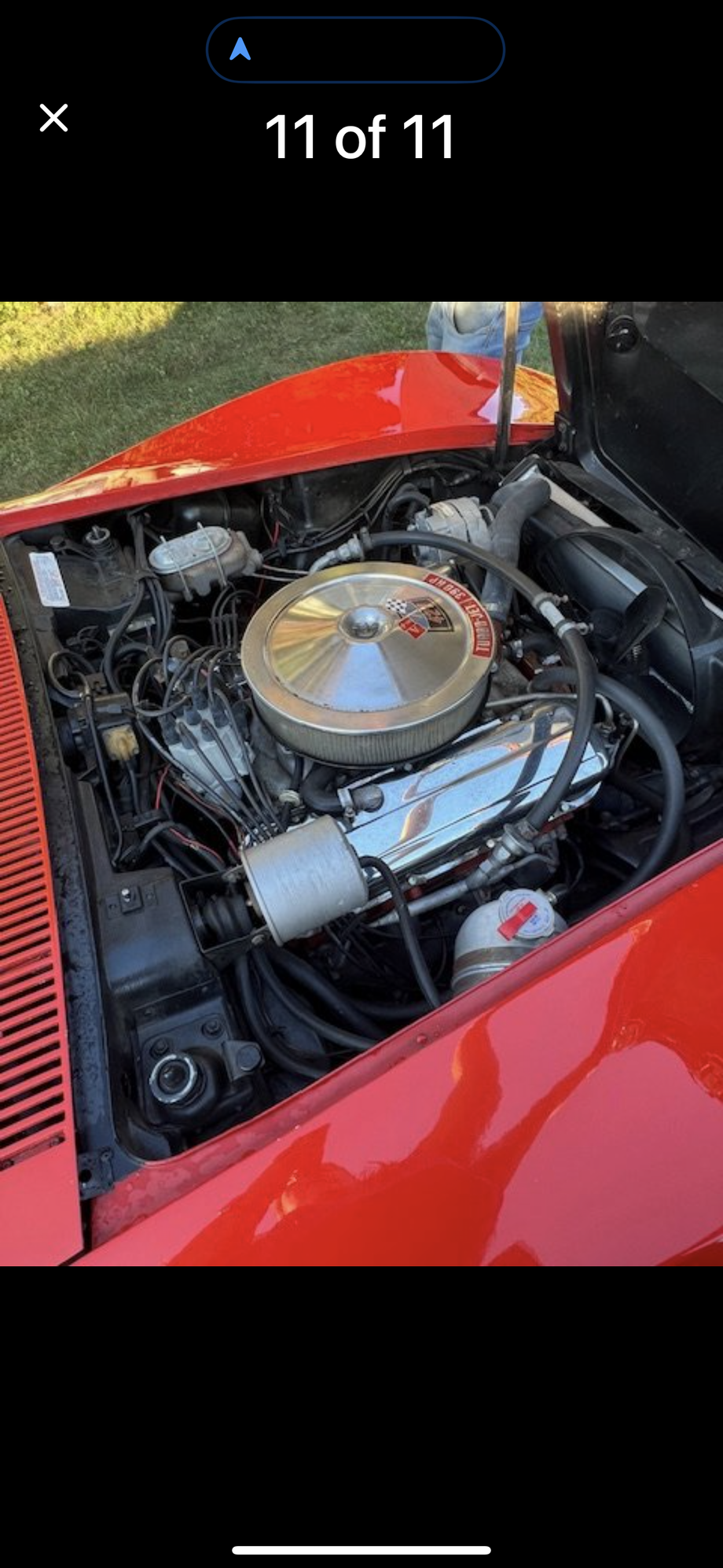

It's difficult to form much of an opinion based on those few photographs.
The engine bay seems to show a compartment that is a bit 'needy'.
The interior photo shows what appears to be a nice interior.

The valve covers are wrong. They should look like this..

That’s interesting the smog pump was removed but not the tubes. Did they join the smog hoses that go to the pump together?

Those manifolds and ht ehoses are worth some money if you decide to get rid of them....You could go back to stock if you are into the NCRS look

Replacement radiator, missing shielding, the "interesting" approach to removing the A.I.R. pump (as avalonjohn noted), the wrong valve covers (as pointed out by SEVNT6), it has the correct 3 groove water pump pulley but the belt routing seems wrong (even taking into consideration the missing A.I.R. pump and belt), and just the overall look of the engine compartment, vacuum hoses and wiring as Alan said looks a little needy.
The interior looks decent, but the radio is an aftermarket unit and (ugly to my eyes) speakers have been added to the kick panels. It's hard to tell from the picture, but it looks like it has a leather shift boot instead of the rubber boot used in 69 and I don't see any seat belts unless they're the black thing partially under the right seat. If they are the belts, the original ones would have been red, not black. The trim tag says it came with red "Comfortweave" vinyl seats, but it looks like it may have leather covers or smooth vinyl ones now. I can't tell from the picture but I assume it has the correct low back seats and adjustable headrests?
For the most part these are little things, but they're worth noting, and variations from original.

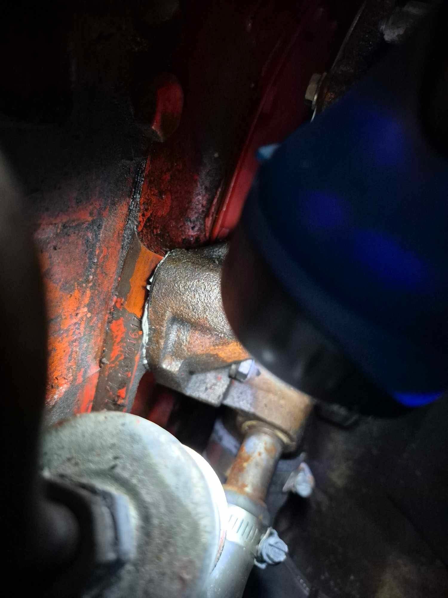

The picture of the pad is of such poor quality, and shows so little of the pad, it's impossible for anyone on here to say if the car is "numbers matching".

Distributor Ignition shielding missing.

That radiator fan only has 4 blades ,non-air corvettes had more fan blades.

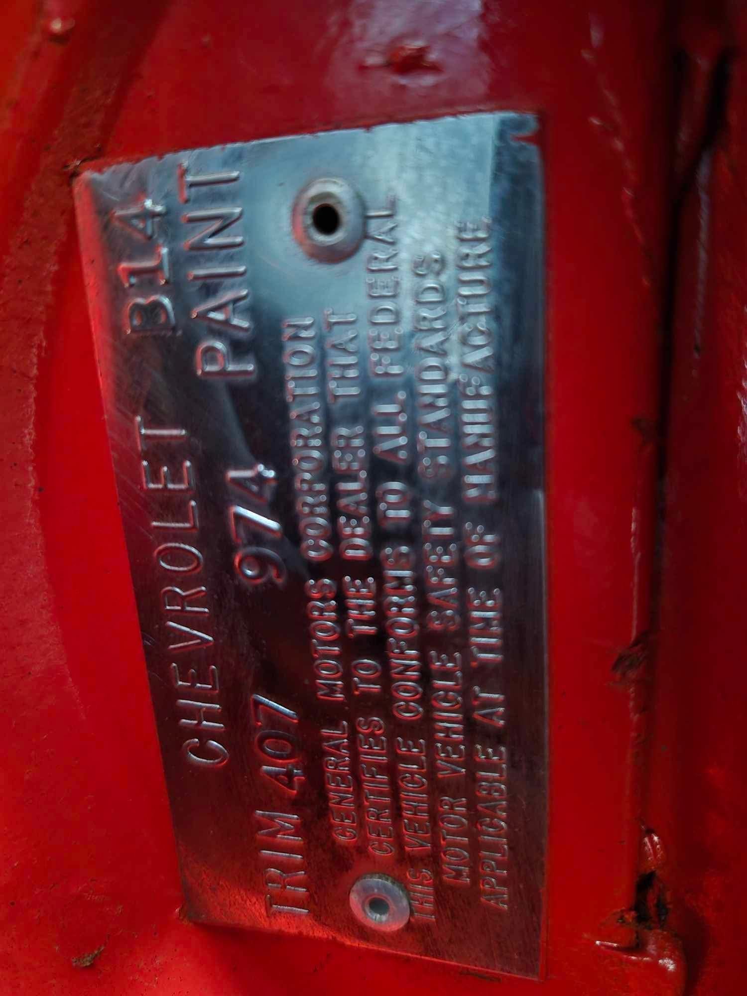

Like Ed mentioned, the car has been on fb for a while. The trim tag is original. Have the owner get you a picture of the front engine pad cleaned off. Tell him not to use a wire brush. There are a lot of non original parts on the car but the plus is that is a red red 69 convertible. I would check the normal areas for rust and the condition of the paint matters. It is hard these days to find a good shop that will paint these cars.
