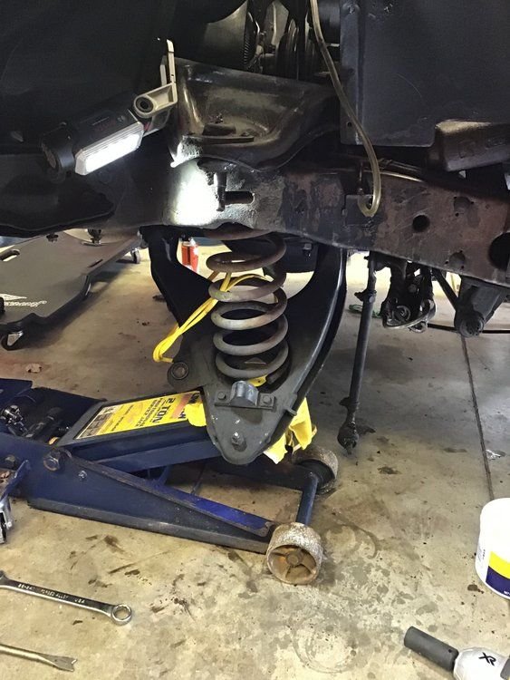

I just installed tubular control arms and new springs.
i found a bunch of YouTube videos that were helpful.
I used a spring compressor drop down through the shock tower and the bottom clamp. I also used a ratchet strap attached to the spring and the opposite side to pull the spring into the lower arm pocket.
I had a jack under the arm to raise into position once the spring was in place

Good pic above but always have a safety chain from the spring to some place solid in case spring gets away from you.
Have now done the job and did it exactly that way, definitely the best way.
