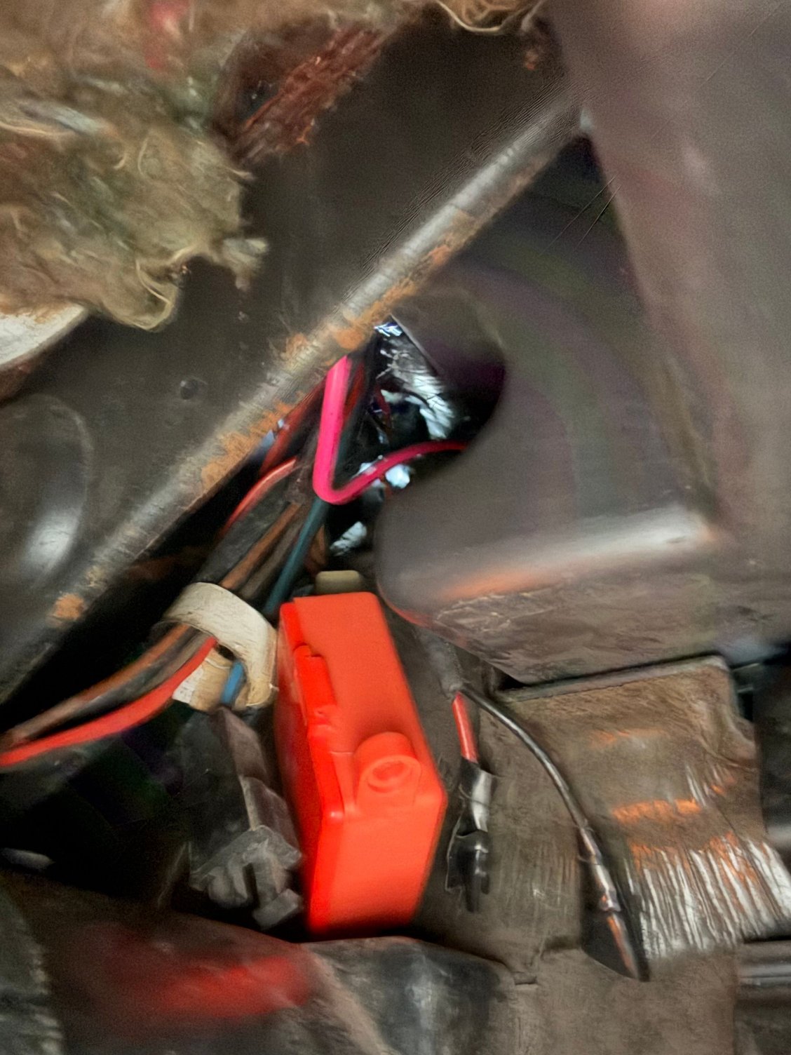

Default Mystery spotted!
Yes! I believe it is that orange thing. Possibly the light timer, judging from my AIM diagram, but does not quite look like the drawing….it does buzz constantly. I will attempt to access the area through the glovebox removal. Thanks guys for the help !!!
(the taped wire(s) may be related…)
Old Oct 22, 2025 | 02:59 PM
Yes, that orange box is the courtesy light timer. You're not the first person to have problems with the timer or the interior lights of 78-82's. I think a search of the Forum will turn up a few posts about working on it, and how to bypass it if necessary. Below is one post that touches on the timer, but there are others.

Originally Posted by 633BR
Looks aftermarket.
There's nothing aftermarket about it, that orange plastic box is the factory installed light delay timer installed in 78-82 Corvettes, and many other GM cars from the era.

Default timer update
(1980 350auto)
I successfully removed the glovebox one piece innards, accessed the orange timer box, disconnected it, removed and replaced the small circuit board (from Zip) the old one had no burn marks but metal parts were EXTREMELY hot to touch. The courtesy lights work normal, and no constant buzzing.
What I need to check now, as this was the underlying issue, is whether or not, the faulty timer was the source of my parasitic draw on the battery. (the lights were functioning originally, but the buzzing timer was a tell that something was not right.)
To remedy the dying battery syndrome, (3 of them) I installed a simple battery kill switch. I have been using a battery tender to keep it charged. NOW, I will take the tender off, connect the kill switch, and see if the battery remains charged while sitting. It took several days for the battery to run down, so I will monitor and report back here if that timer fix did the trick.
As a side note, I have a family member who also had a battery drain issue in his C6. THAT turned out to be a faulty connection in his horn button, of all places. FYI.
