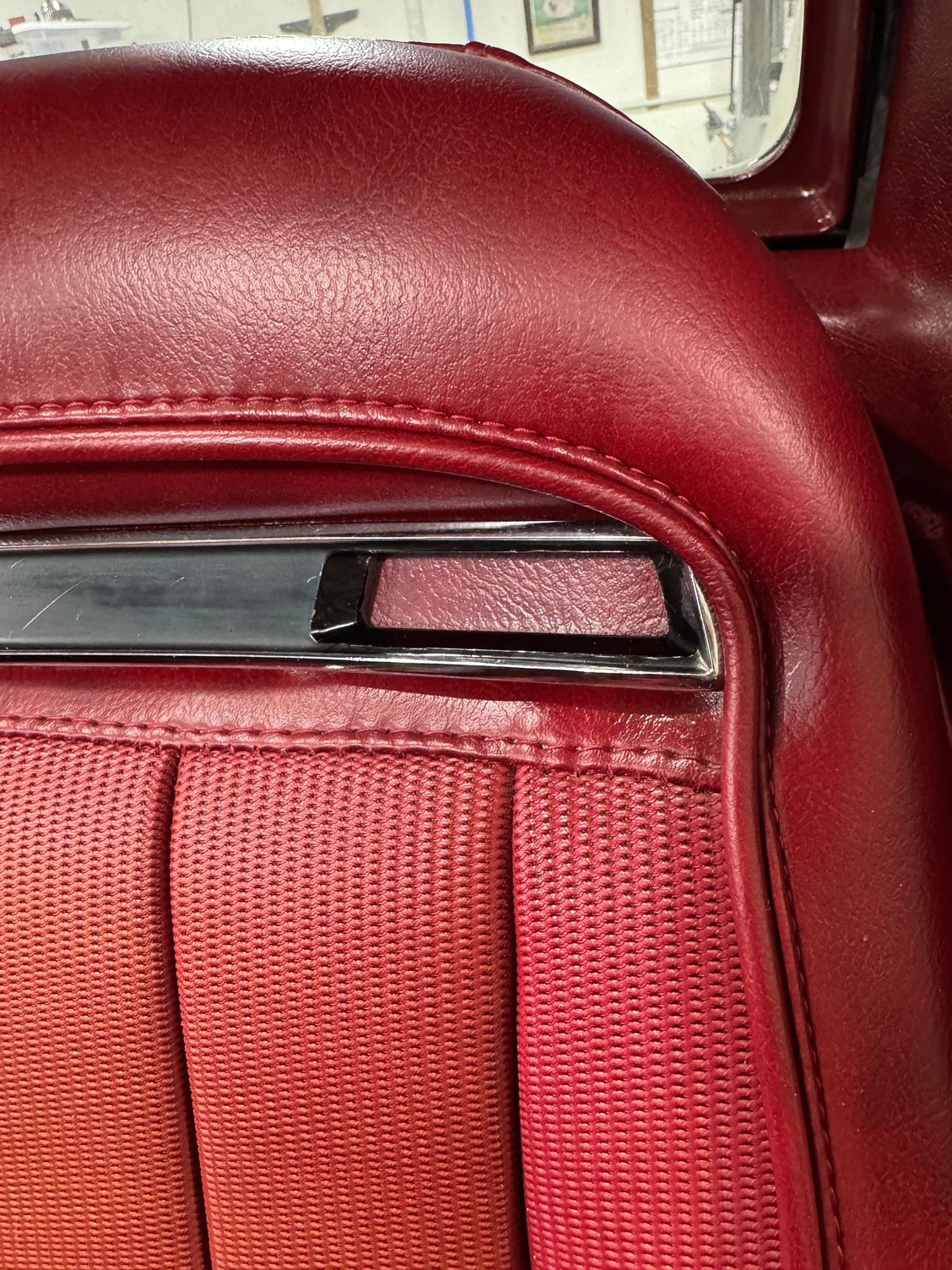

Looks like my car has new seat covers. The slot for the shoulder belt was never cut. How is this handled? Can I risk opening this with a razor knife and not ruining the seat? Advice appreciated

Clyde,
Before making the cut in the front of the seat, make sure that you have all of the parts for the pass through at the back of the seat as well. Would be a shame to open up the front and then discover you need several parts at the back (and internally) to make everything function as intended. You can feel the internal shoulder harness guide at the back (underneath the seat cover) to see if it is there, but you’ll need the trim plate/screws if not already installed.
You have the shoulder harnesses already, correct? That can be a pricey acquisition if you don’t already have them.

Hello,
It's a little tricky but can be done if care is taken.
Cut as little as possible.
You'll probably need to soften up the plastic guard at the tongue end of the belt to get it through the slot.
Soaking the end in some hot water for a few minutes helps.
Regards....

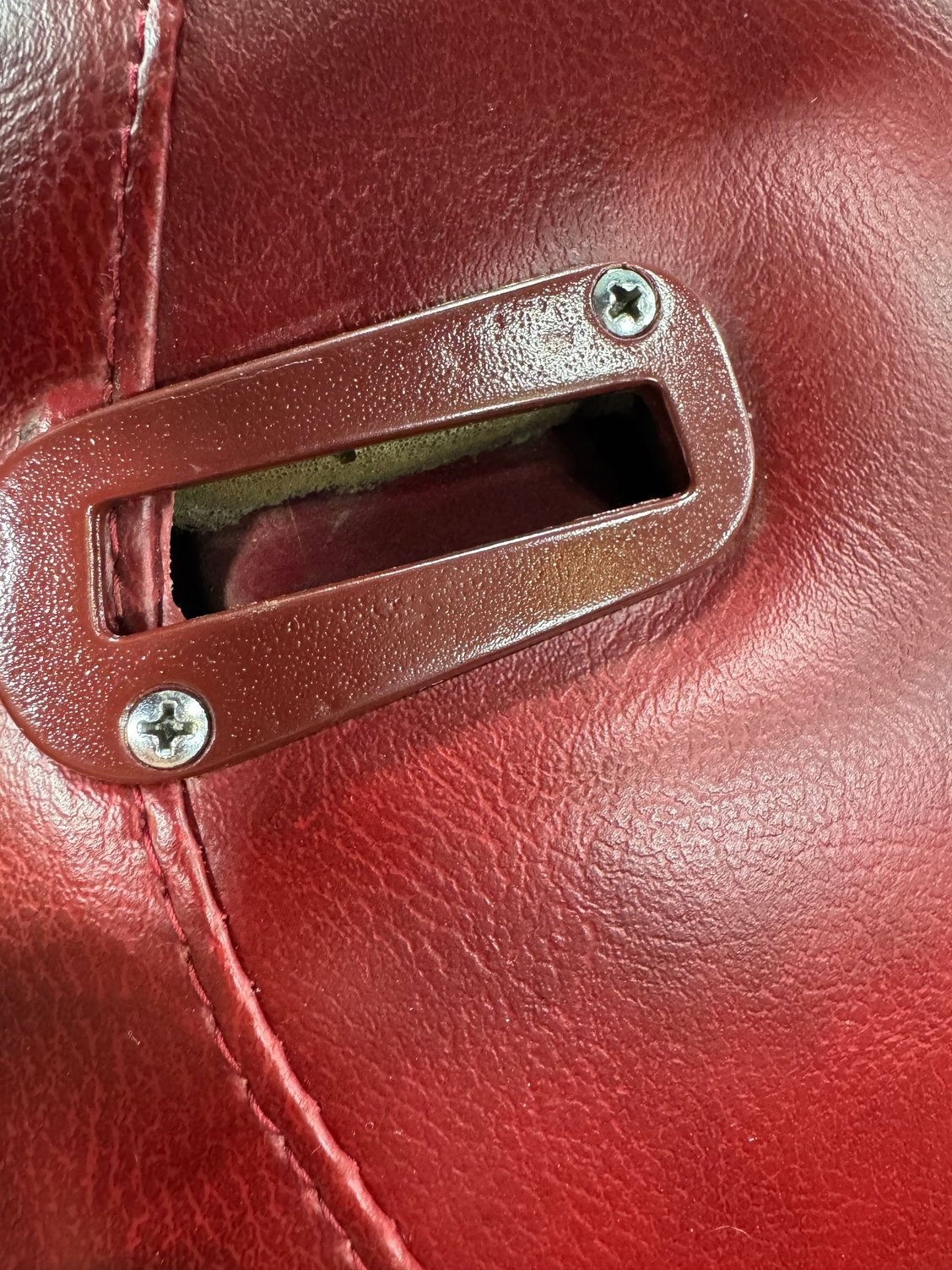

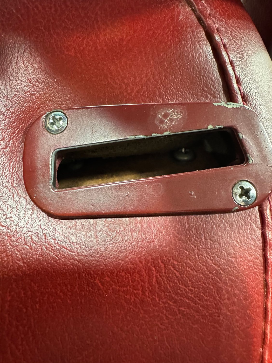

this is the left. Appears to be a plastic part, no screw.
this is the right. I see a screw. Clamps vinyl?

Not sure why there is a difference, but I’m guessing that the internal guides ARE in place, otherwise there would be nothing for the outer trim pieces to screw into. There should be two screws attaching each of these internal guides to the seat frame (you can secure it with one, but it originally used two from the factory). Obviously, you can see a screw (s?) on one of your seats… Not sure what is going on with the other although it looks like some seat foam may be covering it.

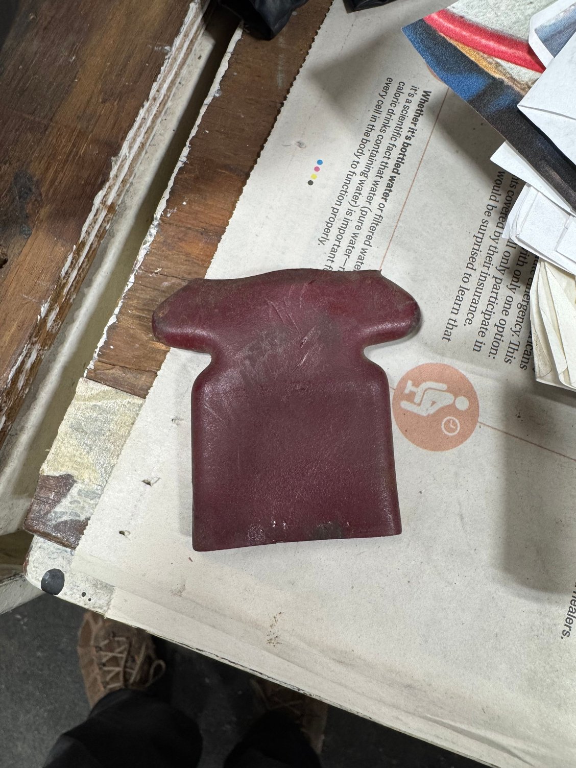

Brew haha. Four screw in place - two per seat. Old buckle cover hidden in the left.
thanks for all of the advice & pictures.

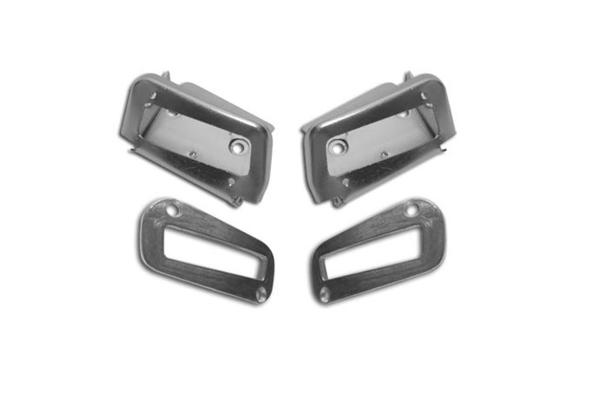

You need to make sure that your seats have internal metal parts or there will not be a way to mount the rear bezel. I don’t see your model year in your post, but my 73 did leave the factory without shoulder belts. The long chrome/black pot metal bezel did not have the opening for a shoulder belt. I purchased the internal brackets a the driver and passenger pot metal bezel that the shoulder harness goes through. I had to add the brackets and the long pot metal bezel, which required removing some of the wires on the seat back. Then after mounting the brackets and bezel, I used a hog ring pliers from Harbor Freight to reattach the wires. It was a pretty easy job, go slow and you don’t want to cut anything until you know what your seats have inside them. I used some large clamps to compress the foam when installing the long pot metal bezel. You can pull the shoulder belt with the rubber cover through the seat by attaching it to a couple of zip ties, also warming the rubber boot helps.

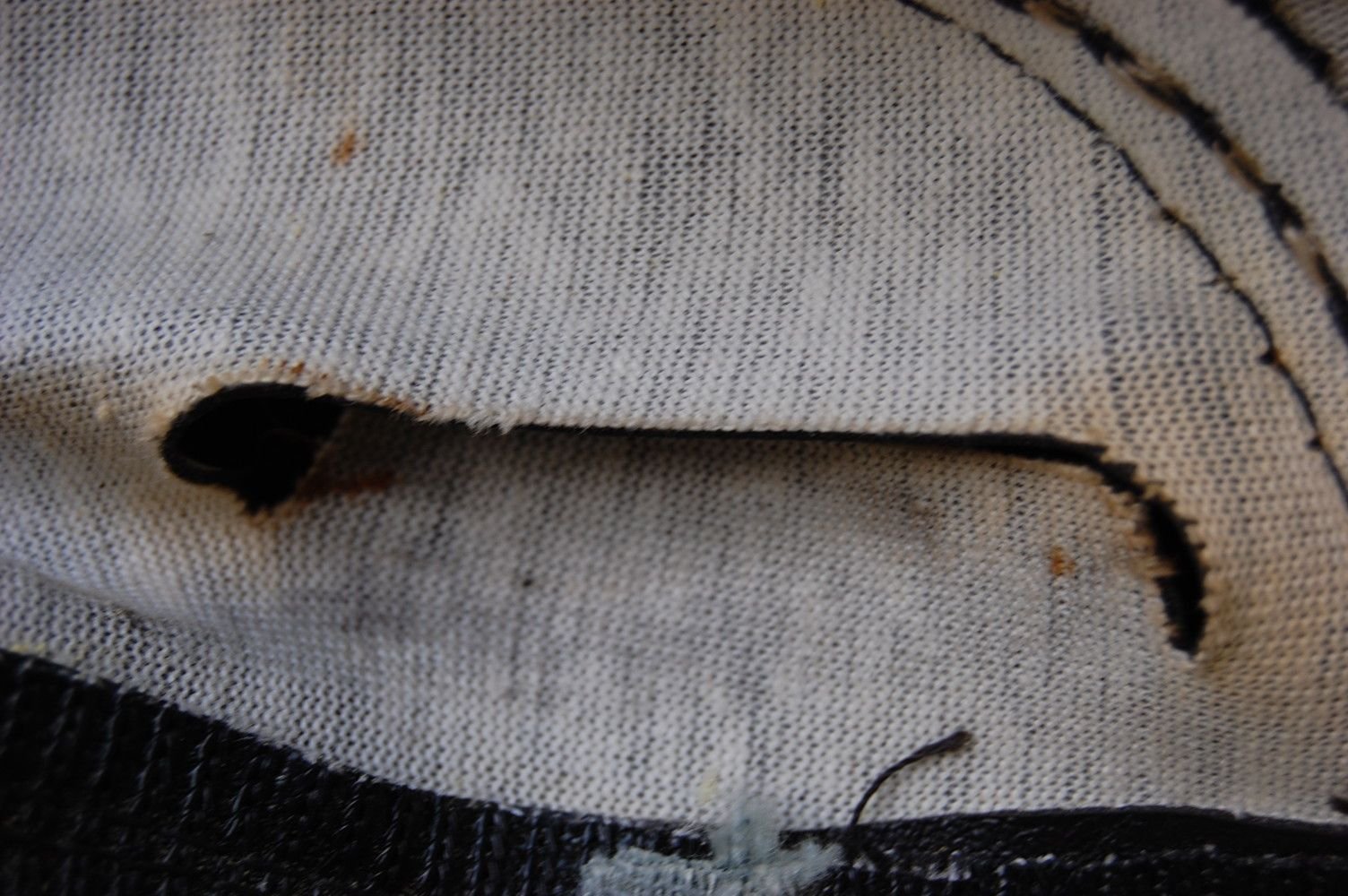

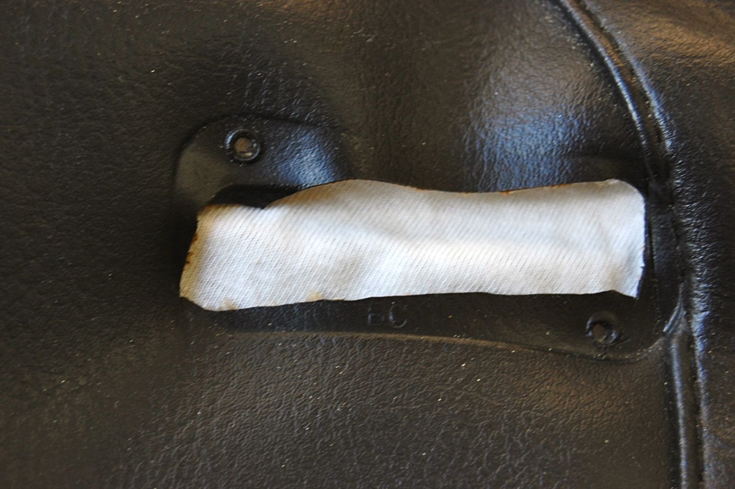

So it looks like on the front it's an inverted 'U' cut making a flap and on the back it's a complete rectangular cut - is that what I'm seeing?
Thanks for posting these!
