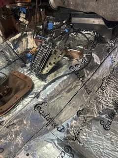

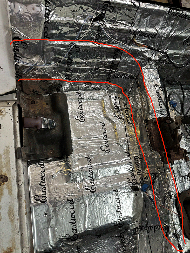

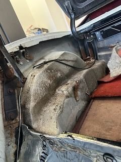

I used the full 6 feet without cutting. I bent it by hand around whatever: can of spray paint--any cylinder you have around that's the size bend you are going for.
Here's two more pics so you can get an idea from start to end.
Start of hard line. Inserted into a flex line from the controller.
End of the hard line on top of the passenger rear wheel well. Inserts into a flex line that leads to the vacuum actuator.
