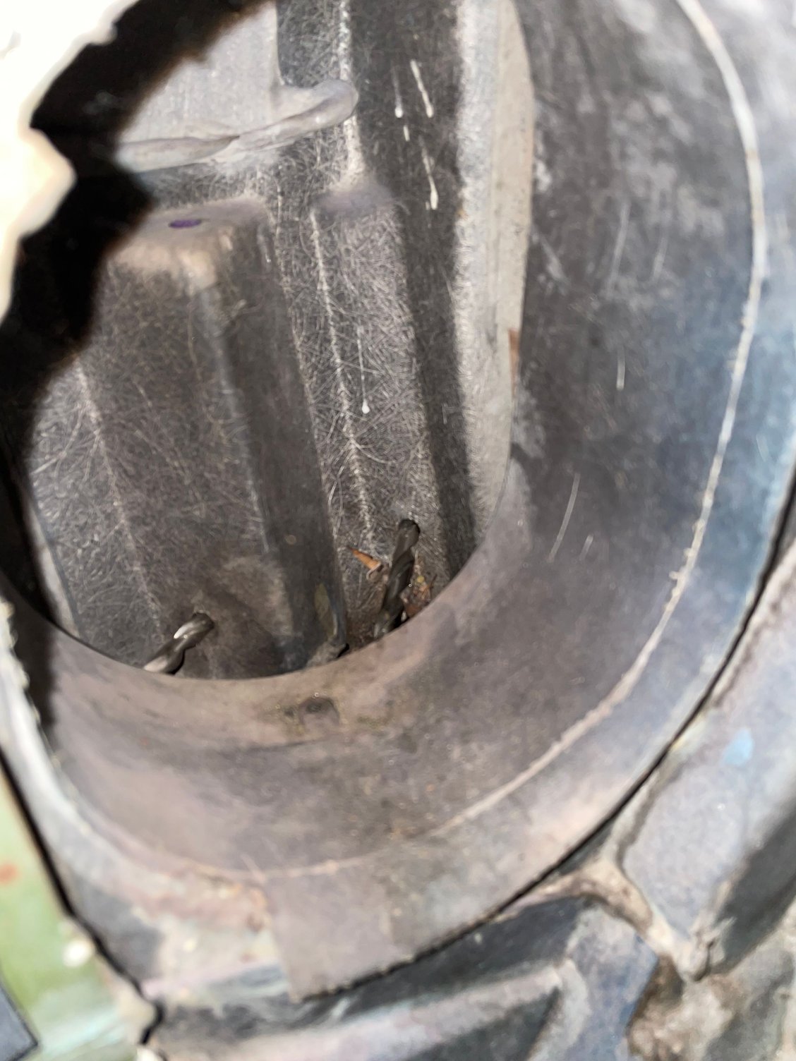

Both the aft most and second to aft most lower holes penetrate the plenum area. Once you push in the rubber well nut and install the screw, you have effectively restored the integrity of the plenum chamber.
This picture is of my 69 which had the gill trim factory installed. I placed drill bits in the holes so you can see them.

Originally Posted by Apollo 13
Thank you. What is the size of the factory holes for the well nuts? They look smaller than I imagined. Are they 3/8 inches? Thanks!
I can slide a 21/64 bit in mine. Keep in mind that I have a small amount of overspray on them so 11/32” is probably closer. Be sure to drill a pilot hole and progressively enlarge to avoid ripping the fiberglass. LIGHTLY smooth the holes with a piece of fine - e.g. 320 - paper wrapped around a smaller bit. Wet the well nut with spit and push in.
