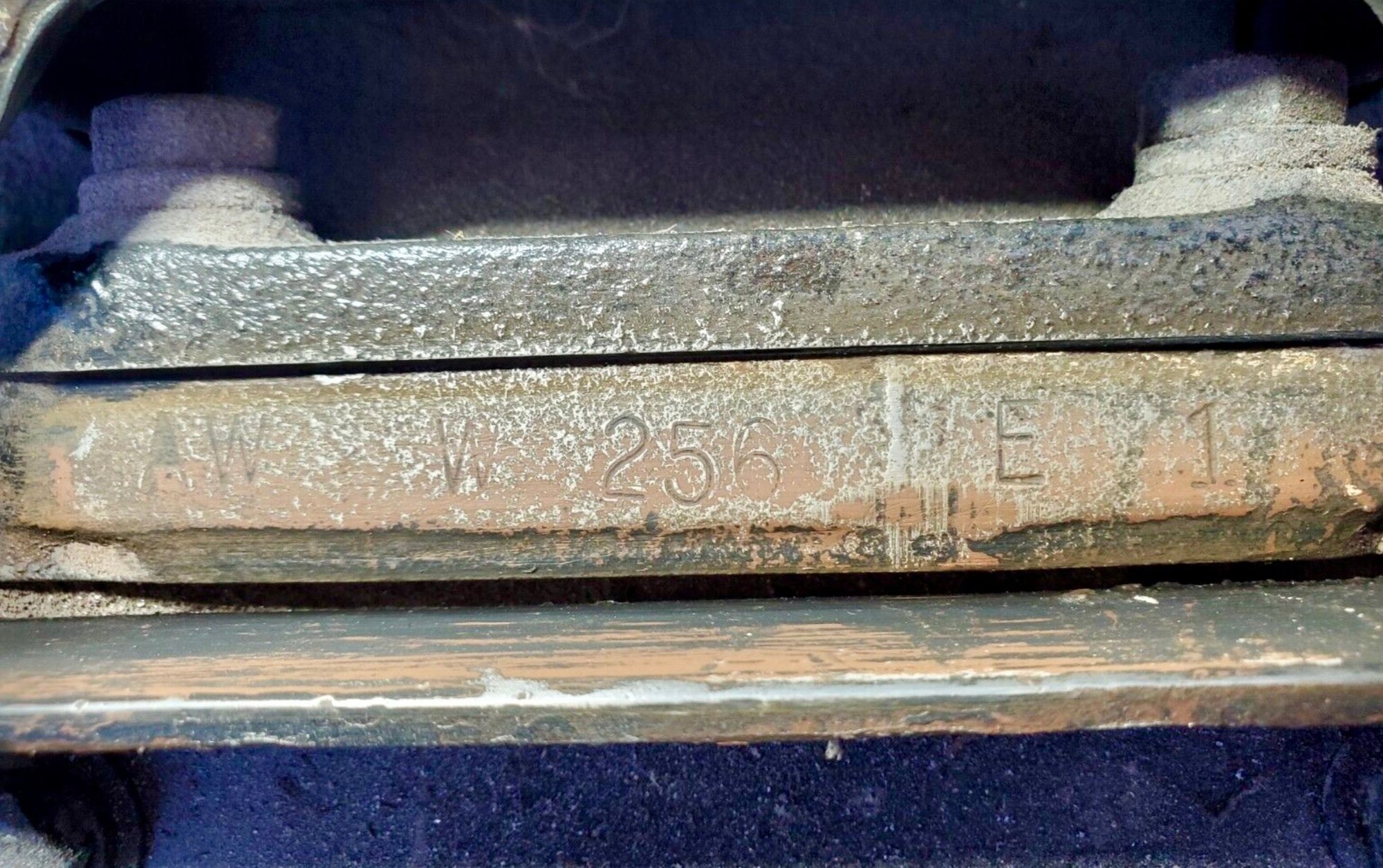

Who can tell me what this differential code means? I need your expertise!
Differential code
Differential code
Thank you!

Hello,
The year of the car makes a difference....
AW........
W...........
256.......Julian date of year
E.......... Positraction Source Easton
1.......... Shift

AW code is 3.08 ratio. Link to diff codes.

Originally Posted by socal_tom
Try to goggle it
I did already search the evil internet. I didn’t try to “goggle” it, though. Can anyone help, please?
Old Feb 14, 2026 | 10:52 AM
Apollo 13's Avatar
Apollo 13
Joined: May 2025
Posts: 57
Yes, I have the AW as 3.08. Thanks. I can’t figure out the other codes. What’s the date code, for example?
Old Feb 14, 2026 | 12:00 PM
Piersonpie's Avatar
Piersonpie
Joined: Apr 2021
Posts: 2,684
Likes: 2,138
From: Minnesota
AW-3.08 Heavy duty posi
W-Warner plant
256-Day of the year, September 13th
E-Eaton
1-1st shift
Old Feb 14, 2026 | 12:21 PM
Rowdy Rat's Avatar
Rowdy Rat
Veteran: Marine Corps
Joined: Dec 1999
Posts: 3,599
Likes: 837
From: PA
It isn’t a 1969 differential… The date system for 1969 is considerably different than what is presented here. This particular style was used on 1971 and later differentials. All we can tell by what is stamped is that the differential was assembled on the 256th day of the year. To determine WHAT year, you’ll need to look at the casting number on the differential housing… Once you know that, you can determine what model year it was originally installed in.

I guess that makes more sense. September 13th 1969 was a Saturday. “AW” was used until 1975, but that year was also a Saturday. That leaves 1971-74.

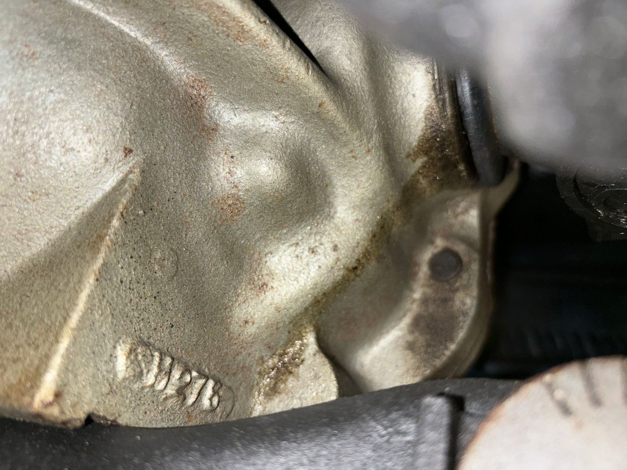

Here is where the year code is. Driver's side, up above a crossmember. Mine was covered with crud and hard to see:
Old Feb 15, 2026 | 03:26 PM
sphil's Avatar
sphil
Joined: Jun 2023
Posts: 507
Likes: 302
From: Western N.C.
So the H 27 8, would indicate Aug 27, 1968?
Old Feb 15, 2026 | 03:41 PM
zxryder72's Avatar
zxryder72
Joined: Sep 2025
Posts: 470
Likes: 131
From: Colorado
Could be '68 or '78 I think...
correct, but a look inside would tell if it was 68 or 78. The posi case, spiders, and caps were different.
