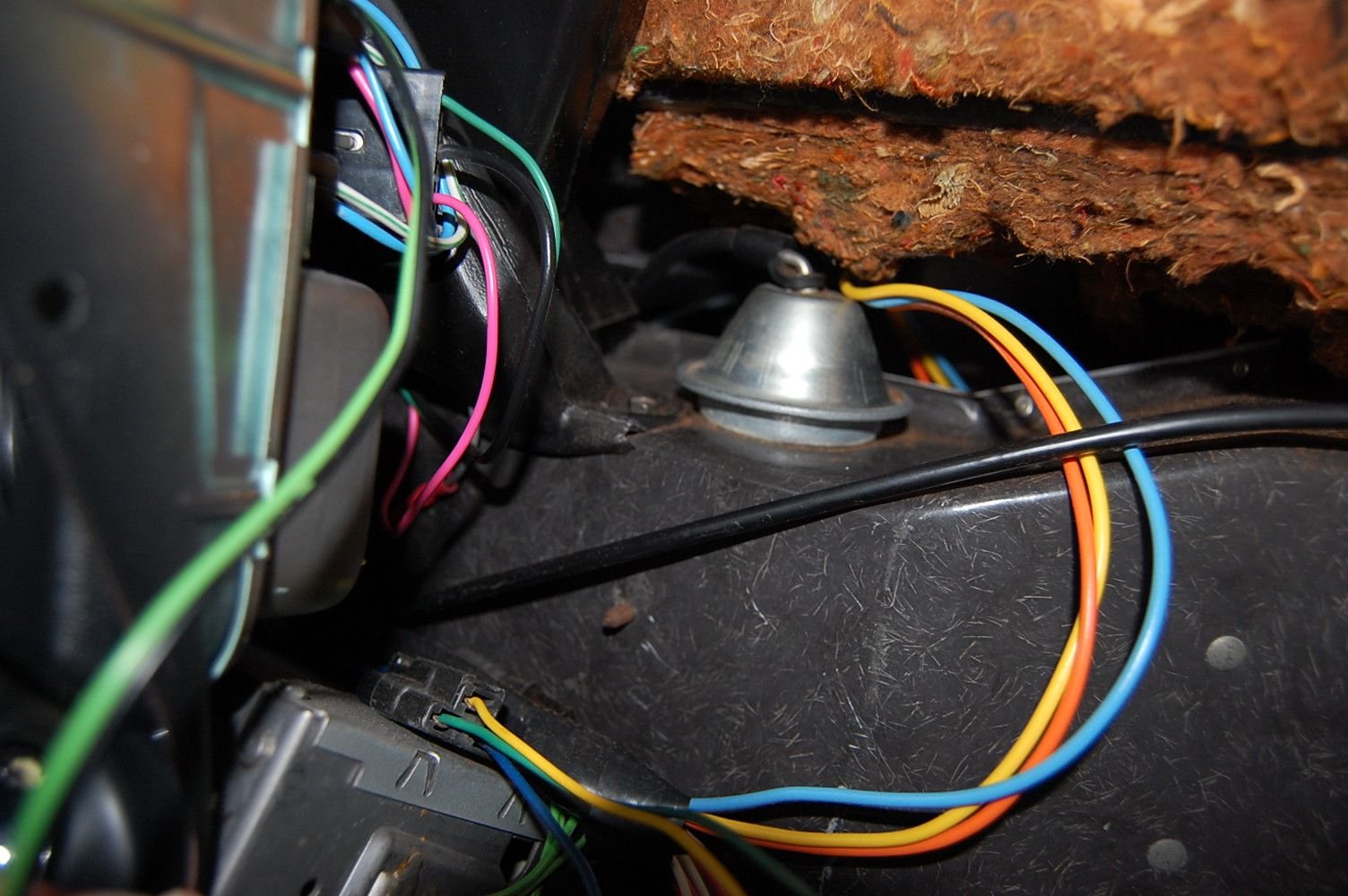

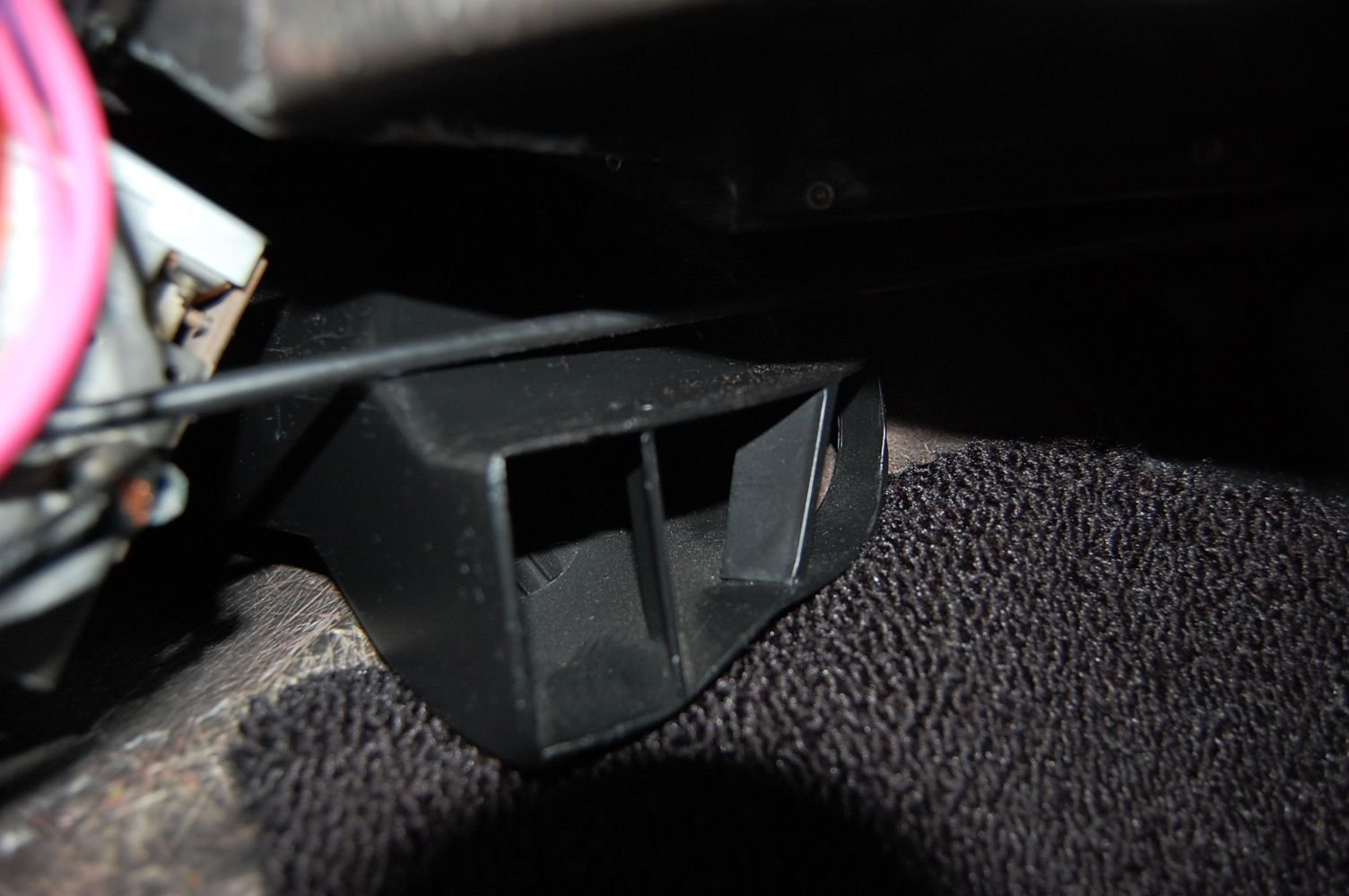

I am putting the interior back together and don't know the correct routing of the vent and heater control cables. Do they pass under the radio or run along the outer side s of the radio?

Hello,
It's very tight and the operating cables are very stiff.
Kinda under and along side of the radio.
The driver's side is especially tight.
Regards...
Maybe these will help....

Alan, that is exactly what i needed. Great pictures....thank you!!
