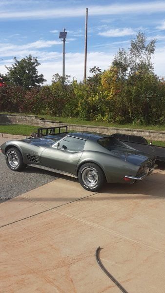

Migrating to the C3 group as my '04 ZO6 LeMans car is off to a new home, replaced by a '71 small block/4-speed convertible that was bought in mid-restoration.
The car is numbers matching with 60,000 miles on the odometer. I recieved the car as shown PLUS 9 boxes of parts and pieces. I've cataloged & inventoried everything, so I now know what I have to work with and what I'll need to compete the refurbishiment.
The prior owner sadly passed away in the midst of a restoration. A guy bought it to flip which is where I came across it. To transport the car from the owner, the front suspension had to be installed so it could be rolled into a trailer. I have no knowledge of what was done in the install, but as you can see, the front is far too high. Only the engine is in the car (for transport)....no gearbox, radiator, etc. Any thoughts on why the front end is sitting so high? From the photo taken in the prior owner's garage, the suspension was installed by a local mechanic while on a lift. Before I tear into it, wondering if anyone might have an idea?

C3s sit significantly higher than a C5, even from the factory. It almost looks like the rear was lowered, which will make the front look even higher. How long are the two bolts holding the leaf spring in the rear? My guess is the control arm bushings were torqued while the car was jacked up in the air. They should be tightened with the full weight on the car, or “Z” height as the assembly manual calls it. Otherwise they will be in a bind and make the car sit high like you’re seeing.

What he said...plus coil springs need everything installed (or approximate how much weight is missing/not installed...then add the right amount of blasting sand bags/etc in the engine bay to help settle the springs.
Also...the ends of the coil springs might not be turned to the correct position causing the frame to sit too high.
Be sure to roll the car forward and backward about 10' to settle the suspension and tires into place.
The rear clearance looks good to me.

I'd think there are several issues to check on...
First: determine what front spring was installed?
Second: how was it installed? It could be upside down and/or not seated properly in the frame and the lower control arm.
Third: how much of the total weight that the front suspension will carry is in place?
Fourth: the rear ride heigh seems a bit low which could affect the front ride height.
Fifth: It looks like a very nice car to get in this situation!!! Mid-restoration cars can often be problems.
Regards,
Alan
Just for reference:
The spring is mounted with the closer coils up.
The length of the bolt from the trailing arm to the end of the spring affects ride height

Thanks, Alan! I appreciate your insights. Answers in red below....
Bob
Originally Posted by Alan 71
Hello,
First: determine what front spring was installed? Front what I can tell, they appear to be the OE springs, Alan. Likely were beadblasted but certainly not replacment.
Second: how was it installed? It could be upside down and/or not seated properly in the frame and the lower control arm. The springs are not inverted as the closer coils are at the top and the bottom is seated in the lower A-arm correctly.
Third: how much of the total weight that the front suspension will carry is in place? The engine is set in place on the mounts and they supported the back of it with a strap under the oil pan and the frame rails. So, no trans, clutch/cover, flywheel, a/c compressor, radiator.
Fourth: the rear ride heigh seems a bit low which could affect the front ride height. The front end was put together so it could be transported. I really need to take it apart as a lot of refinishing needs to be done. Great news is that it is a very solid frame and birdcage. No rust anywhere and the car spent most of its life in Illinois, Wisconsin and Michigan.
Fifth: It looks like a very nice car to get in this situation!!! Mid-restoration cars can often be problems. It is a very good car and my aim, like yours, is a correct restoration. The owner had bought some $15,000 in parts that accompanied the car. It took me a week to assess and inventory what was there, and what I needed.
Regards,
Alan
Just for reference.
The closer coils go up.
The length of the bolt fro the trailing arm to the end of the spring controls ride height.

Correct springs in the car. Found the receipt from Zip for their SU-1022 springs.
