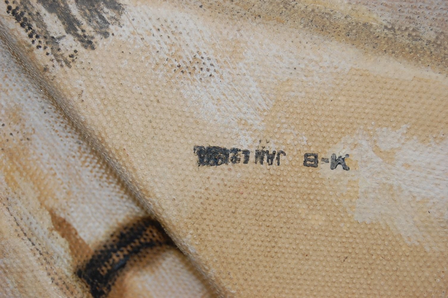

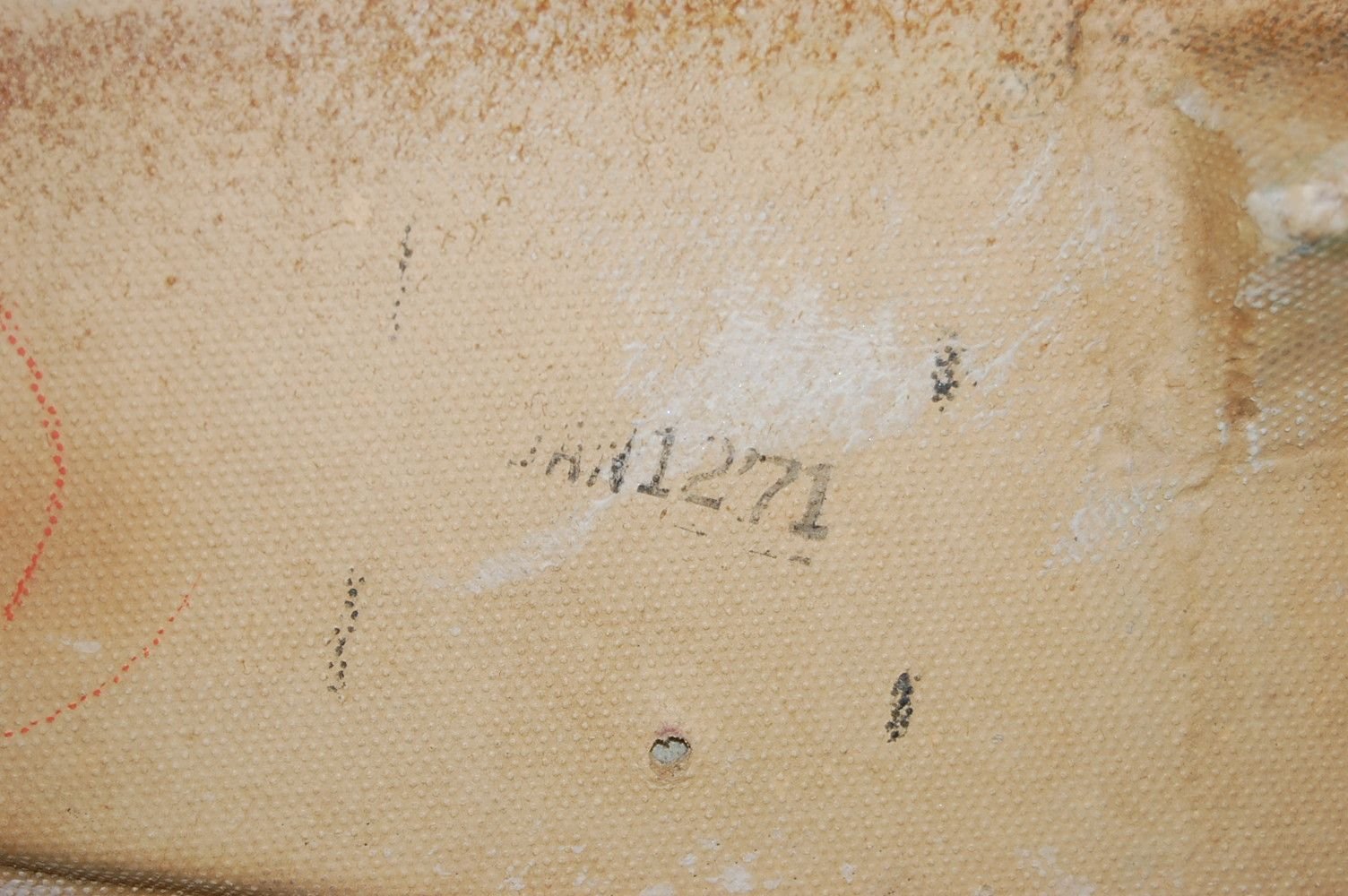

I looked through some of the date coded parts from the 71 I owned.
It had a F14 assembly date. So it was likely on the assembly line Jan. 14, 1971.
There was a strike for 2-3 months during the fall of 1970.
The only part that seemed out of place was the intake manifold with a Aug/Sept. 1970 date.
It was a base motor car so I'd think Flint was making lots of these engines.
I think the closest date I can see was an interior door panel.
Regards,
Alan
