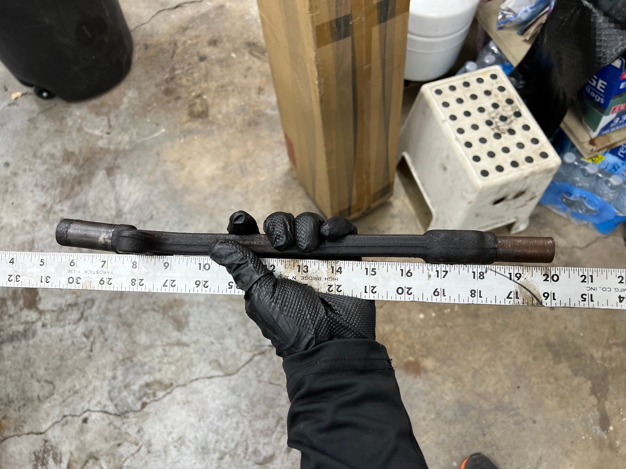

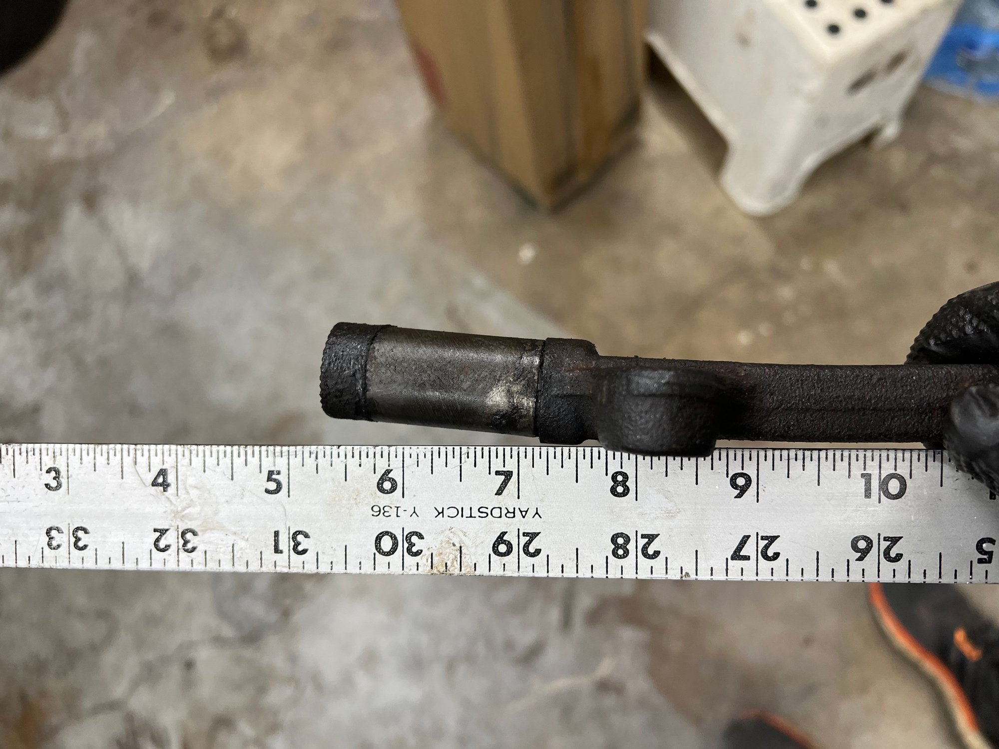

I’m redoing the bushings on the lower control arms on a 78. This shaft is bent, right? It should be straight?

Hello,
I'm betting it should be straight.
And so should the upper.
Regards....

It's toast. Check for other bent stuff up front.

Yes that one goes in the bin. And I agree, have a good look at everything else. It took quite a hit to bend that.
