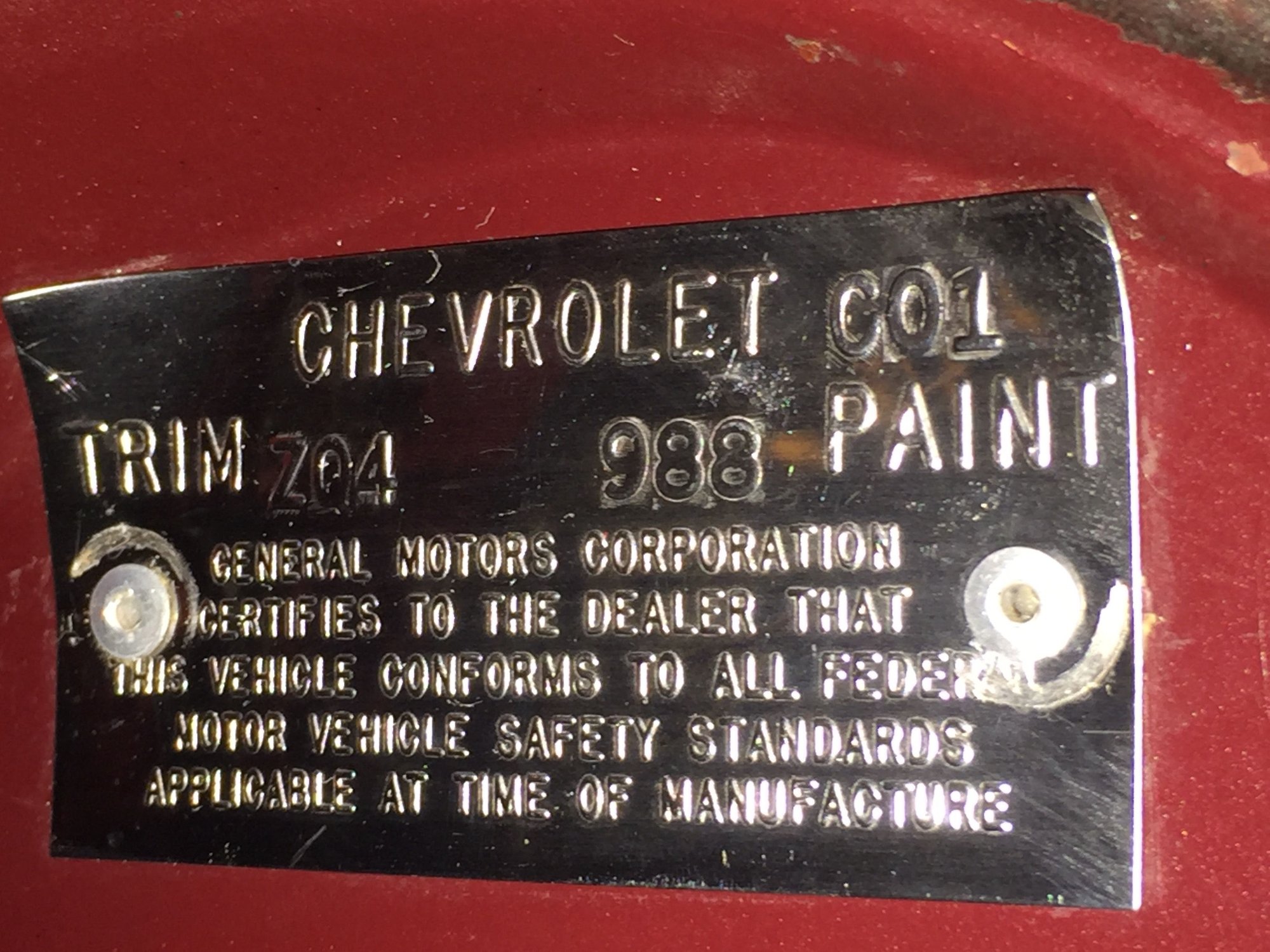

Trim tag looks fine in the photos, but would need to see it in person to be absolutely certain. You mention the tag date as “C07”…. Just looking at it and knowing a thing or two about 1969 trim tags, I’m going to say that is probably a “G” (February 1969) and not a “C” (October 1968)… So G03. You can check it against the VIN. I’m thinking the sequential serial number of the car is going to be in the low 15000 range. The trim tag mounting for these cars were all over the place… Some were centered very well, others (like my late 1969) hung over the bottom edge, while others (like this car) were jammed into the upper ridge, causing the upper tips to be bent.
This is a comp (I’m guessing) for this car. You can see the “G” with no serif across the bottom and installed in the same manner.
Your assessment of the car as an L-46 appears to be correct as well. If the engine is original to the car, it will have pertinent information on the stamp pad (which should back up what you learned from the tachometer. Nice set of options! A/C, p/s, p/b, p/w and a four speed (should be an M-20 with the a/c and probably backed up with a 3.36 or 3.55 rear)… Good stuff!
As to value… I doubt that you are going to find anything presentable AND running in a 1968 to 1972 Corvette for less than $20,000. If the car has no structural issues or major body damage, you’re probably in that range. Apparently there are some problems to address so you can use that during negotiations to work the price down, but obviously it’s something that you’ll have to deal with if your father does decide to buy it.

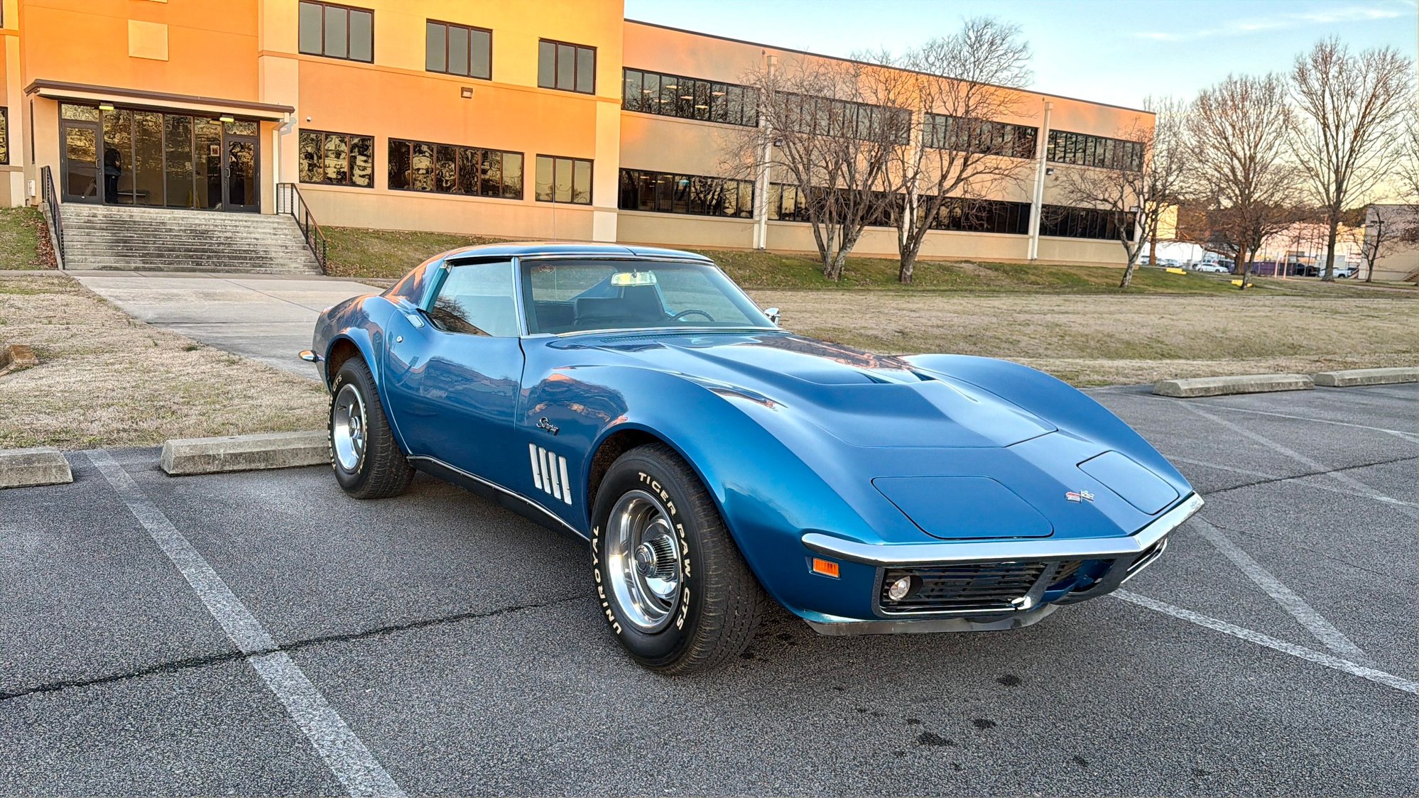

Well, took some time (my not checking plugs cost me some time for sure) but drove it to work today! All lights working! Also got some vacuum stuff worked out last night & headlights are working up & down like they should... passenger is little lazy, I will lube its mechanics & check for small leaks, but it works. It comes up 3/4 way and closes 99%. So you can start car and turn them on and help it or close it when needed and driving around with out them it looks normal and nothing creeping up winking.
Wiper door is staying shut driving but if you get on it creeps open as it losses vacuum so I am sure there is a leak there. Also I have a mystery hose under dash so will work on it. more
But we have a running & driving, shiny 69. Pics in my work parking lot this morning at sunrise.
I changed oil once carb was rebuilt (stopped dumping all the fuel into motor) to get gas out of oil. Drove it around some then changed it again last night. so should be good for some cruising and finding more problems. Power steering leaks horrible, and rear main. So betting those are addressed sooner then later.
I have a Hust shifter rebuild kit, & steel bushings that came in, I plan to do this weekend. Then maybe my dad will drive it some & I will take 66 apart. This old Hurst is loose ha. i rebuilt the old Hurst i bought and installed in 66 and feels Tight, so hopefully will fix that on this raining weekend.
Checking speed with GPS, I think the cars is 3.55 or 3.70 they are so close not sure ha. Leaning to 3.55

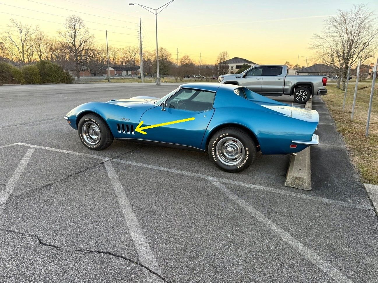

Gotta fix that

Originally Posted by 427SIXPACK
Gotta fix that
Talk to me! I assume it a air vent that is vaccum operearted too? I know my 66 has a cable that opens up a vent up top that lets air in.
Nope, there is no function to it, it just needs to be painted ( blacked out )

Is that how they came and the guy who painted it missed it? EDITZ looks like i found my answer.
Originally Posted by 7T1vette
Also note that the rear-most louver is NOT open to the engine compartment. In '68 & '69, GM painted that surface with semi-flat (or satin) black paint so it would "appear" to be open. That needs to be done whether with or without the metal louver inserts.
I need to figure out what the Pull vents chrome ***** are supposed to do as well, because right now nothing haha. Looks like they open and close that round vent? but there is 3 "positions" in 1/2 and out? also is that cable controlled or vacuum? control flapper?
