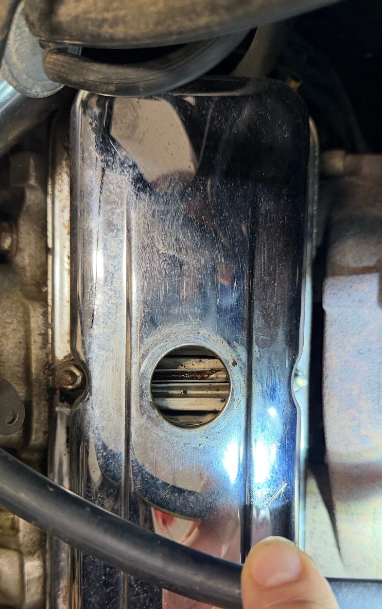

Did you look for the head part number? I just looked down the oil fill hole with a flashlight on mine and could see the number.

Yes I took a pic as well. The valve cover has a baffle in it, so can't see anything.

Eventually if you take a valve cover off you can look for the number. Someone maybe could tell you about the heads from looking at them, maybe get some good photos from different angles.

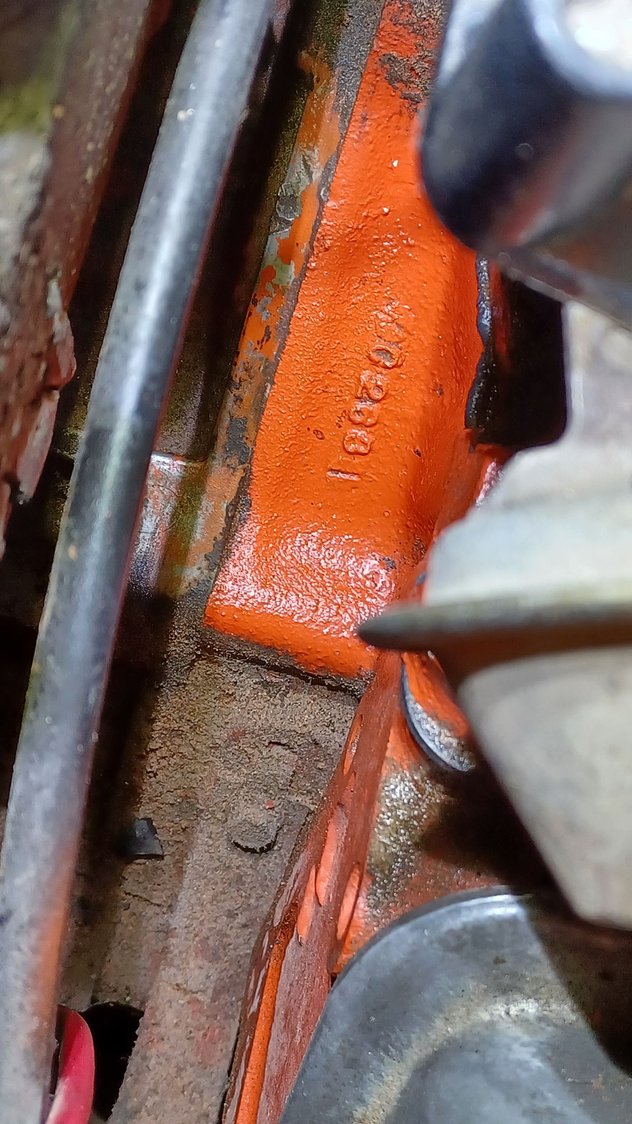

"Block - back of engine I can't see Passenger side, but the driver side casting number is 3970010, The stamp pad is C41154741, K03, 25, TMM (Tmm says 1974 truck block, but C starting the Vin google says certain cars so not sure but probably truck block)"
I checked and found I got a photo of the block casting date on mine pretty easily. Valve cover was leaking down there and was hard to see at first. I wiped off the oil, and the number was right there. I saw two possibilities for the TMM stamp so might be worthwhile to look again for the block date.
3970010 is a good block. Came with either two bolt or four bolt main bearings. One of the TMM engines from the listing I posted earlier appears to be an LT9 which is a four bolt. If your block date is 1980 it would probably be the LT9:
