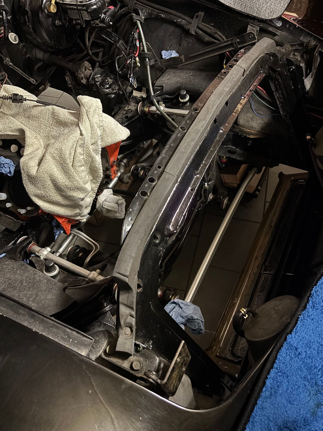

Hi everyone
Can I remove the radiator support to make some extra space when lifting the engine out from the front?
Or will this take support away from the chassis/ body?

Maybe important to note:
I also removed the bumper cover and the bumper asm.

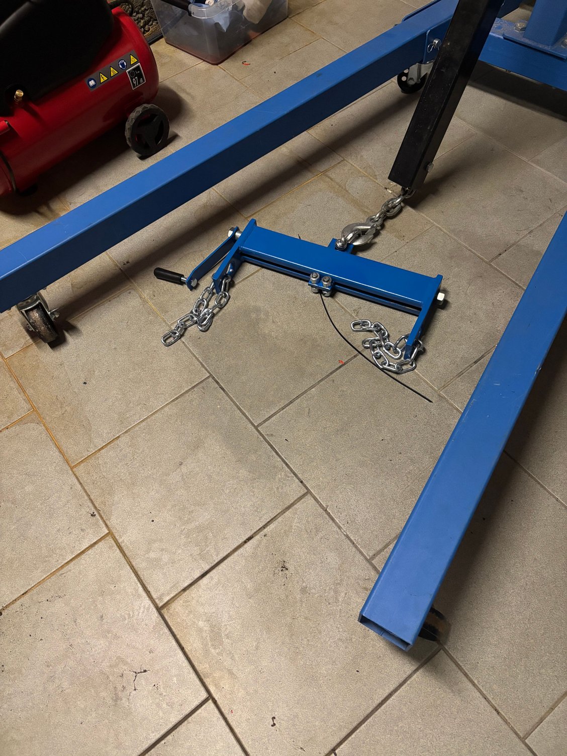

I removed the engine/bellhouse/transmission stack out of my donor 70 car by lifting if from the front of the car with a standard engine hoist. I used a load leveler so that I could rotate the engine/bellhouse/transmission stack in pitch. The top of the radiator frame did become an issue at times, but using the engine hoist in combination with the load leveler allowed me to remove the stack with no real problem.
I used a Harbor Freight engine hoist. Cost $179. The look alike Snap On Hoist was $1200. I've used the HF hoist several times. It's main quality problem is the hydraulic ram. The piston hard chrome plating is very thin and the piston rusts easily. I've gone through 3 hydraulic rams, not a big problem since they are cheap. ~$70.

Do you mean this by a ‘load leveler’?
I had it already attached.
Yes. That's the load leveler. I think you're good to go.

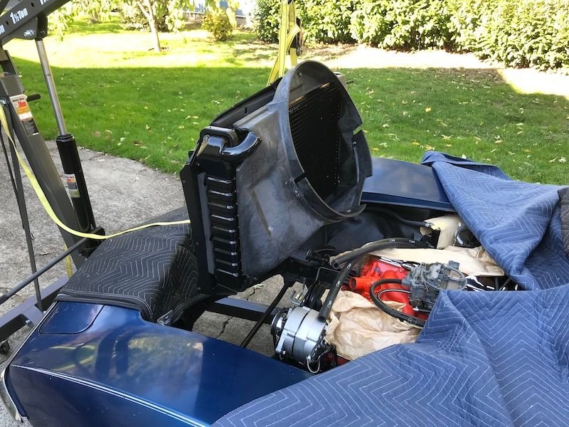

The core support on a C3 is not like a C2. It does not support the body and can be removed and replaced without fear of changing the body alignment or having the fenders droop. I discovered that the best way of replacing the radiator in a C3 is to take out the radiator, support and shroud as a unit. It is certainly the best idea to remove the unit in order to get room to remove the engine and trans together.
To Remove radiator support -> Extra space for engine lift?
100%!
These pics are re-installation after engine/trans back in place.

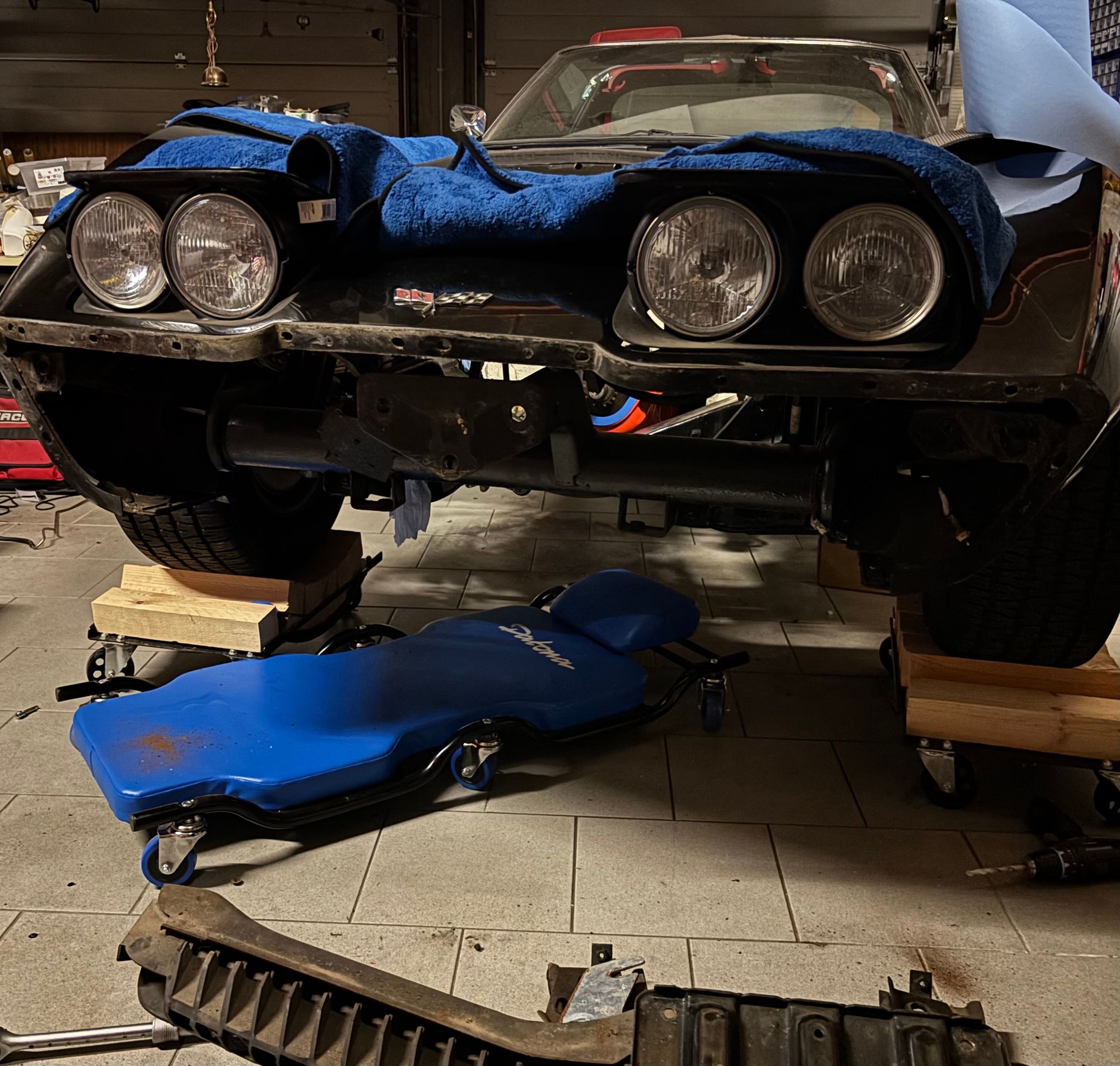

Okay, so I think I will remove the rad. support.
Do you guys think it would be a problem to keep my car on these reinforced wheel bowls?
My vette is resting on it to get easy access to the underside.
Can I keep it this way when removing the engine + transmi.?
The ‘wheel bowls’ can’t go anywhere for the moment because I blocked some of the wheels (rear of the car) with wedges.

You may find that you need to remove one wheel and put the frame on a jack stand. Most engine hoists don't have the arm reach to lift or lower from the nose of the car, so coming in from the side is the only option and removing the wheel offers room to maneuver the hoist's feet and casters. I've always done it from the driver's side but I don't think it matters, so choose whichever side is most convenient for jockeying the hoist around.
Tip: pull the distributor out before lifting as the lift angle can cause it to contact the firewall and damage something.
