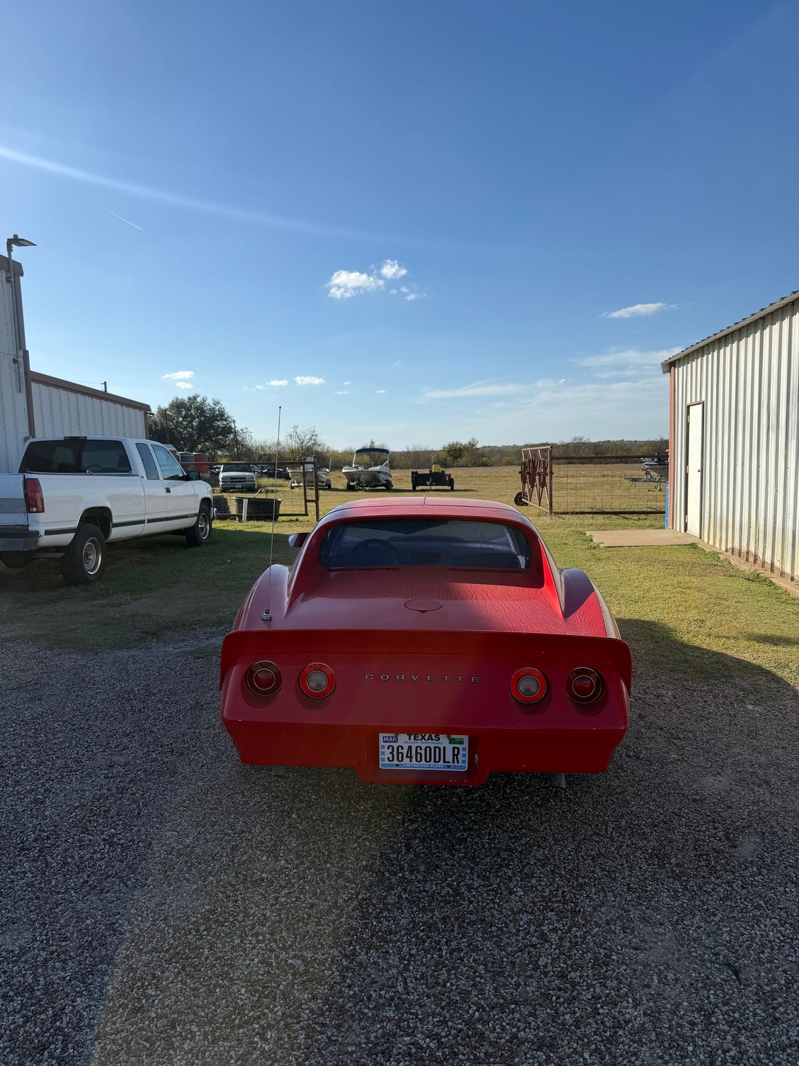

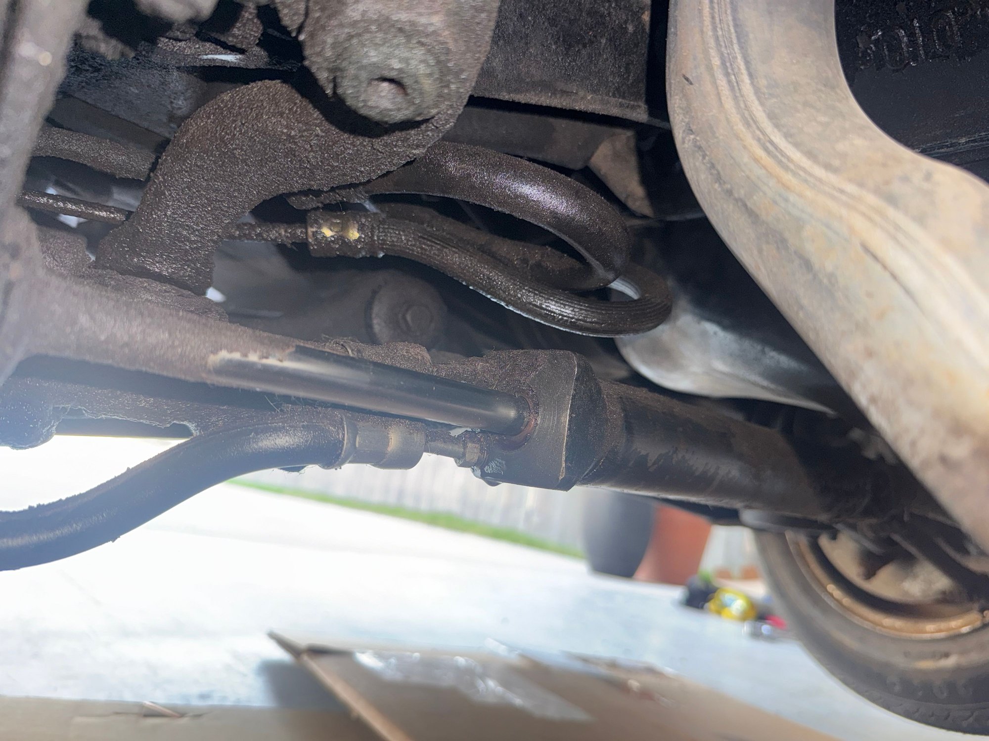

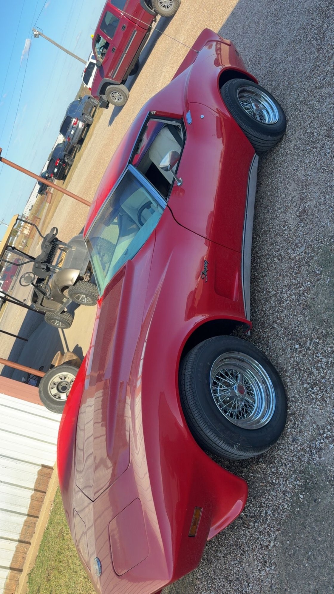

Bought this 1974 Stingray a few days ago. Was told engine and trans were rebuilt, both with only 50 miles on them. I’m not offended to admit I am not the most knowledgeable on these cars. I’m 25, love the look, and made enough this year to go out and make a purchase. Tell me about what I’ve got, the goods/bads. Did I pay a fair price? $10k at a small mom and pop dealer. New radiator, tires, rebuilt engine with a cam, rebuilt trans. Pictures added. Cons: Headlights don’t pop up, vacuum leak to headlights causing it. Small oil leak. Small power steering leak. Intense gas smell after cold start when started in the garage (with door open obviously). Fuel gauge doesn’t work. RPM gauge doesn’t work. Power windows work, slow going up. Heat from under the dash in the footwell when driving a long ways on the highway.

I bought my 76 a little over a year ago and it had the same power steering issues as yours. I replaced the hoses and rebuilt the pump, valve, and cylinder. Parts are readily available. Messy job. Be sure and research how to balance the valve when done.

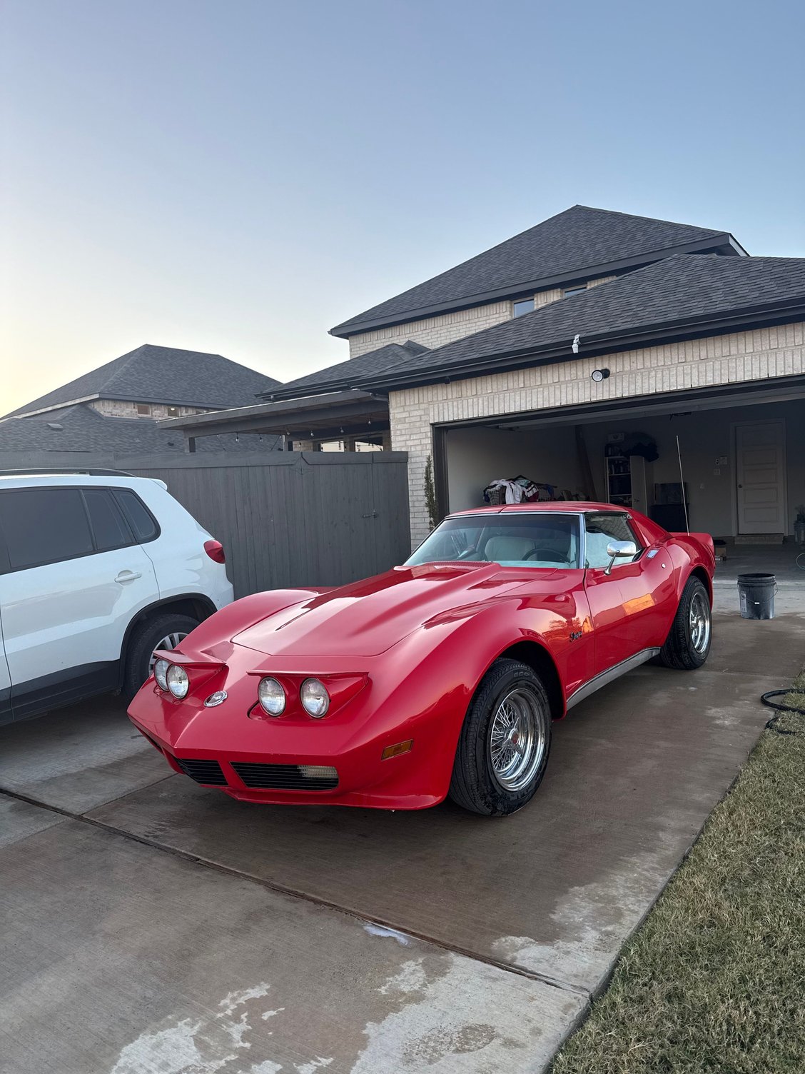

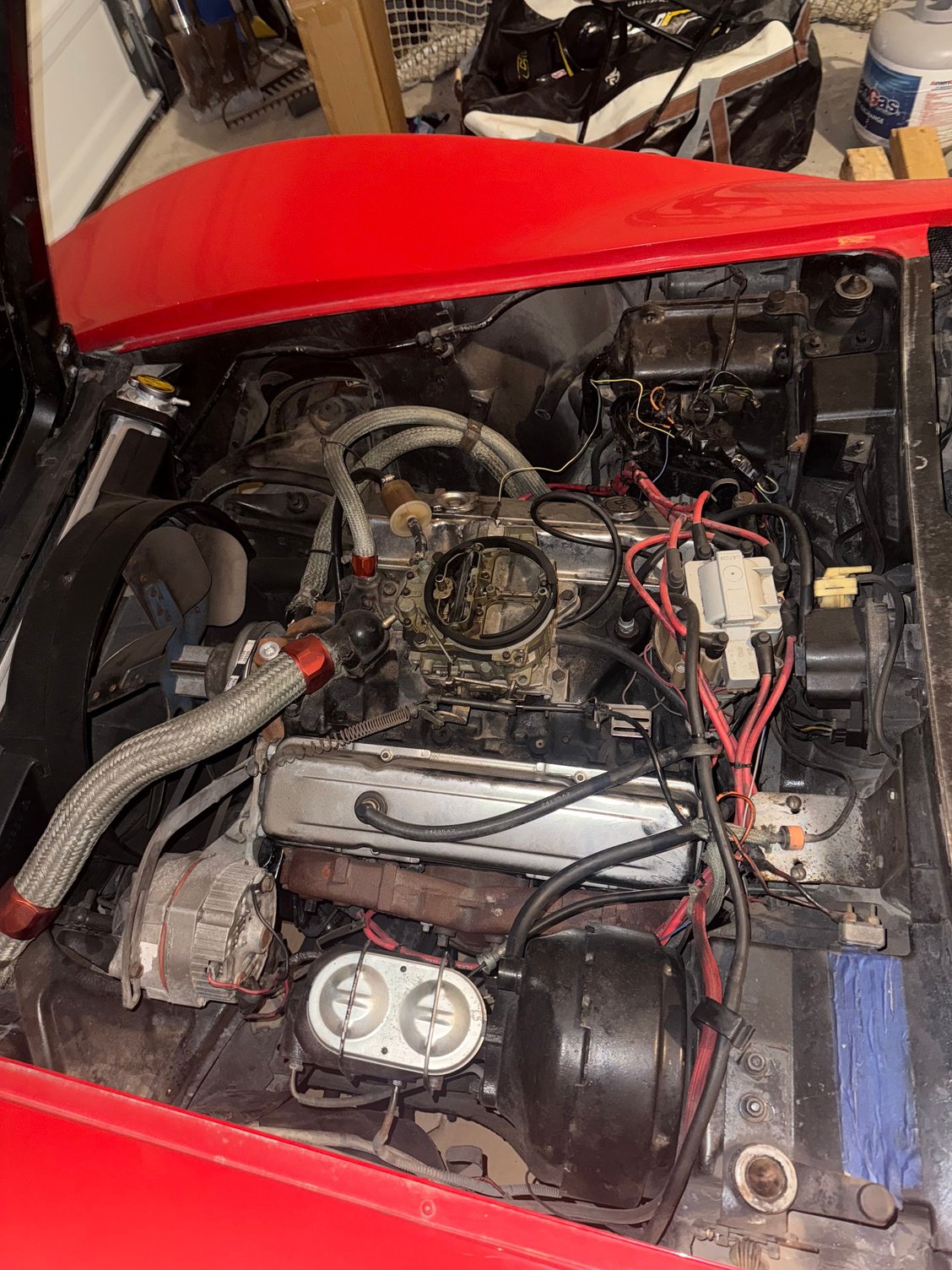

Welcome to the forum! Beautiful ‘74 with some custom touches. Some that stand out to me are the ‘78 pace car front and rear spoiler with the bumpers glassed in, those wire spoke wheels, and that collection of stainless braided line all over the engine bay (each one adds 5 horsepower btw)
With the amount of leaks and the overall look of the engine bay it’s very hard to believe it only has 50 miles on it. Do you have documentation of when the rebuild was done and what parts were used? You appear to have an HEI distributor, which would explain why your tach isn’t working. Like what was said above, ‘74s came with a distributor that had a cable that spins the tachometer.
If the frame is solid and the engine runs well I’d say you got fair market value for it. The only other glaring thing is that fuel line in the picture. There should already be a filter in the carburetor, so the inline one is unnecessary, and the whole thing being made out of rubber is just asking to melt and catch on fire. I would be on the lookout for an OEM metal one to replace it.

Congrats and welcome to the C3 world! Oil leaks are a thing with vintage cars, I just live with it, however a gasket on the oil drain plug may solve that. The body had been modified and aftermarket seats added, that tends to reduce values but if it runs great, at $10K, I'd be happy.
Those look like '79-'82 seats to me, not aftermarket...

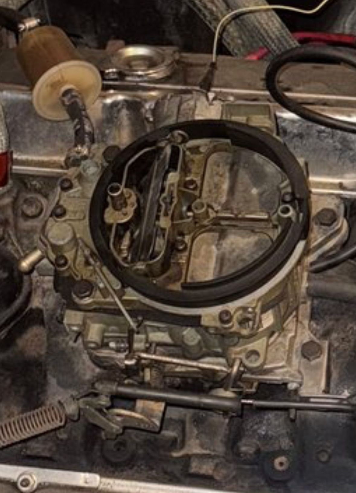

Some more things of note in the engine bay.
A Quadrajet is the name of the original 4 barrel carburetor for your car. Great running carbs when set up correctly, and much better than almost anything you can buy new today.
While this is a Quadrajet. It’s one from the 80’s as shown by its torx bit screws and by its 1975 and later “M4M” design. That wouldn’t be the end of the world, but based on the sticker on the back of the carb body you can tell it’s been commercially rebuilt. You can do your own research here on the forum about these kinds of carbs, but the short of it is that it has completely different jetting settings than what’s ideal for the car, and likely has multiple setup issues that prevent it from running correctly. Another thing to note is the unplugged float bowl vent on the front. This would explain your fuel smell.
The PCV valve vacuum line is going somewhere behind the engine. It should be going to a vacuum nipple on the carb (not the bowl vent I just mentioned.)
Furthermore your radiator fan is the “flex fan” type. People install them thinking it will gain them more power over a stock clutch setup, when in reality they actually reduce power and can come apart at high speeds in a spectacular fashion. Your best bet would be to find an original metal fan/clutch setup or converting to electric to actually gain power.
Lastly, it looks like you have an aftermarket aluminum radiator, which is an upgrade over the factory copper one, but you’re missing an expansion tank. Being in Texas you’ll want that sooner than later.

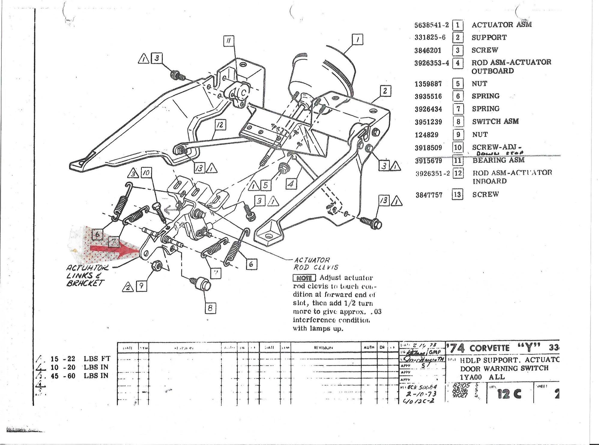

You are missing two of the four springs that go on the headlight assemblies.
How to troubleshoot headlight problems:
https://www.corvette-101.com/vacuum.htm

Also, remove the plastic fuel filter, could melt from engine heat, then you have a fire on your hands.

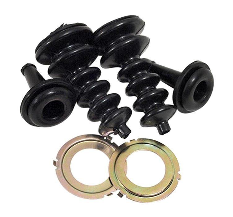

The seals in the actuators often need to be replaced.
Here's what they are:

OP did not say his lights don't work, only that they won't pop up. You can manually raise them.
Here is a vid for replacing the seals Peterbuilt posted, if you find that is your problem. jump to the 3 min mark.
