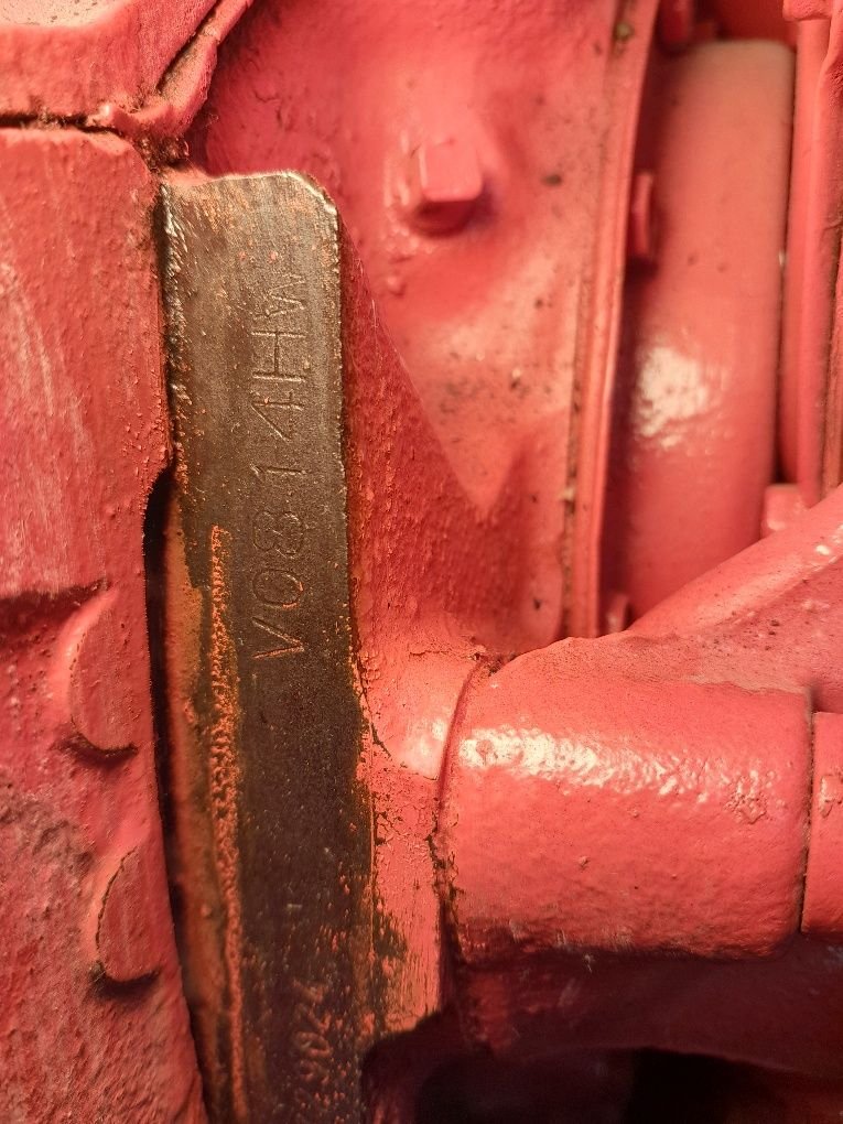

Have yet to see any casting numbers & casting dates; to help either confirm Or deny original numbers matching engine.
AFAIK, IF OE C3 Corvette sbc block, it should be a Flint block.
However, I do not see the square-head, tapered pipe-threaded oil galley plug at front of block, located just above timing cover flange and slightly right of centerline, and toward passenger side.
AFAIK, that square-head galley plug is indicative of all C3 sbc Flint blocks. Perhaps it is there, but that I cannot resolve it; OR there simply isn't one.

BUT, there were Other sites in USA, Canada & Mexico that completed Many sbc for Other platforms (trucks, sedans etc). Perhaps your engine is one of those; that's Not uncommon when OE motor is replaced by one of those. Haven't seen Your stamp pad (which is easiest part to tamper with). If ya really wanna know if yours is "numbers matching", post up good, clear, sharp pics of a clean, paint-free pad; as well as those things listed below. Suggest use a real camera; not sloppy phone pics.
You wrote this: original numbers matching
* I'm not there to look at ALL the casting dates, casting numbers, pad stamps and other clues which help to flesh out identity. The "Flint Plug" is but one of many exemplars. By chance, I spotted it in one of your pics that, on the whole, don't provide much help to ID motor. Hey, maybe Flint Plug IS There But I don't see it ? Mind ya; not complainin', just sayin'

Vin matches, rest are V0814HW. From my research, 14 Aug 69, car 10 Sept 69
From my crappy phone

So far, Numbers all seem to coincide. And from that angle the plug's clear as a bell.
Shucks, a camera may've done a better job of resolving pad's broach mark pattern ?

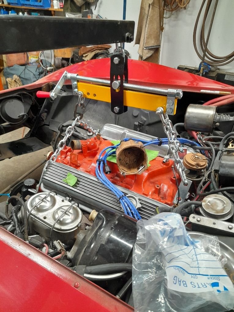

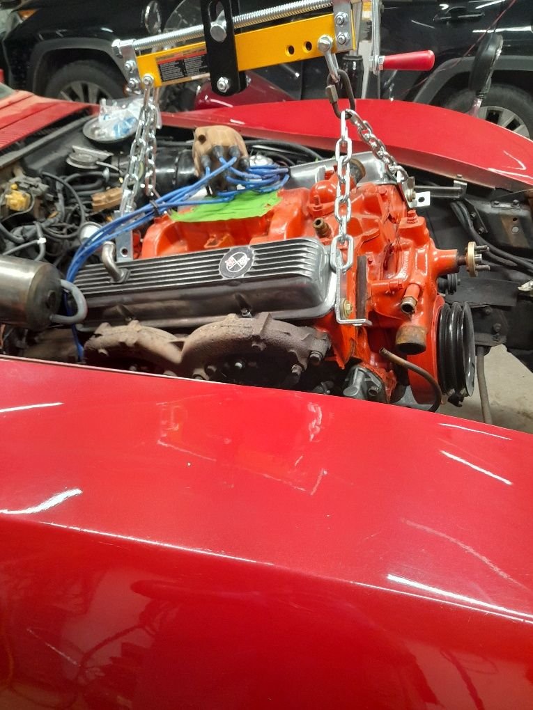

I got some more grade 8s today and pulled bolts from the engine mounts, all the linkages wires and cables are off, driveshaft is off the transmission, the rest of the exhaust is off, the only things left are the bolts holding the transmission and tension from the crane.

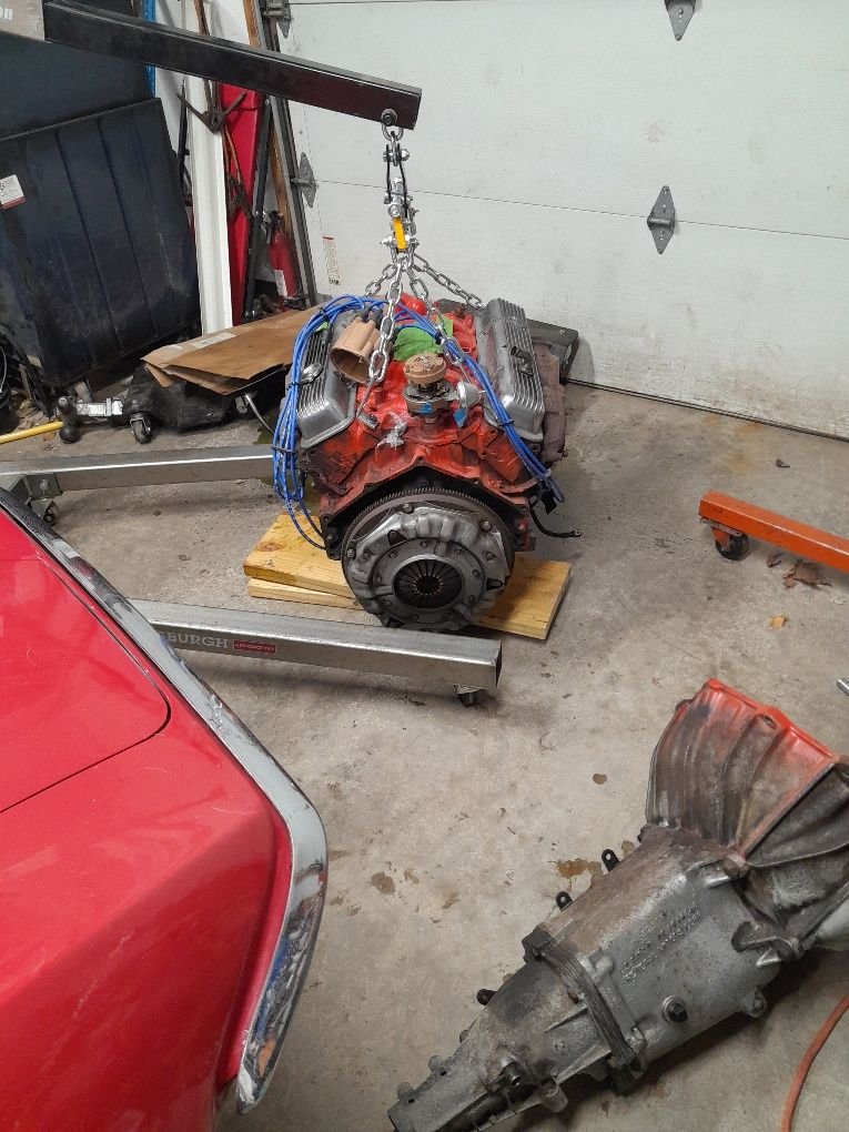

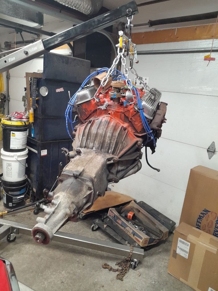

Shes ooot !!!!

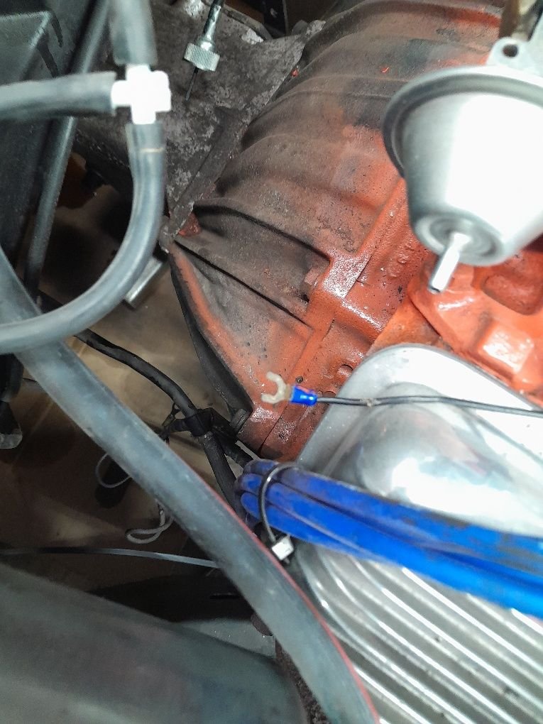

Only missed one connection so I did OK.
Getting a call approx 2-3 this afternoon from the guy who is doing the rebuild. I know my limitations.
