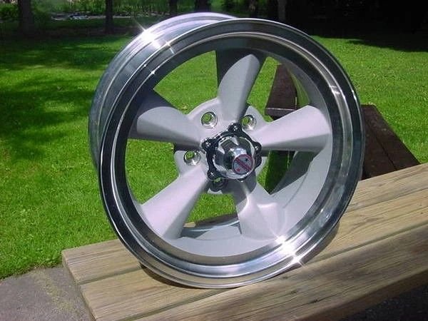

Originally Posted by zxryder72
Hard to see the curve of the spokes from straight on. Do they look like this or more flat?
thats a D... are yours that curved?

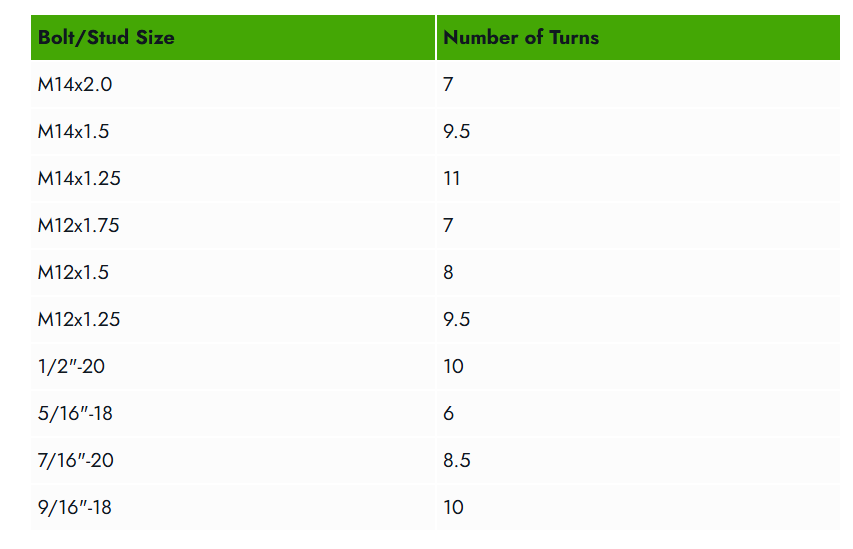

I got new wheels for my '73 and had to get longer studs. I only needed 5mm spacers to clear the calipers, but the wheels were thicker than stock so ended up without enough threads. I went by number of turns after the threads catch to determine if there was enough engagement. 6 to 8 full turns is a general guideline. I found this on a lug nut specialty website:
Or with straight spokes like this?
I think they are curved but, I will look tomorrow. Thank You!!! Dan

Originally Posted by Golfobsessed
Agree with above... 1055861 is a torq thrust D 15x8.5 direct bolt on a C3 without spacers or rubbing
I have the same wheels. I ordered a new one two years ago to replace one that was damaged. Part number from American Racing VN1055861.
