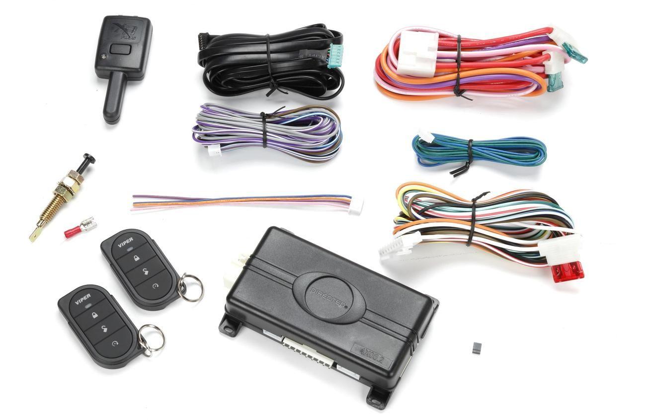

Does anyone have any experience with aftermarket keyless entry. I made up my relays for the reverse polarity and tried it behind the glove box. It locks and unlocks the lock in different directions. Switches work fine. I’m using the tan and gray wires.I believe the relays are wired correctly. Should I be using the wiring on the other side on the drivers side kick panel. We got orange /hot. Blue tan and gray wires. I’m having a hard time following the wire diagram. Two grays and two tans go in the drivers actuator one gray and one tan in the passages side. One black on the drivers and I believe three on the passenger that includes the one to ground on the door. Any thoughts? It’s a 1982.
