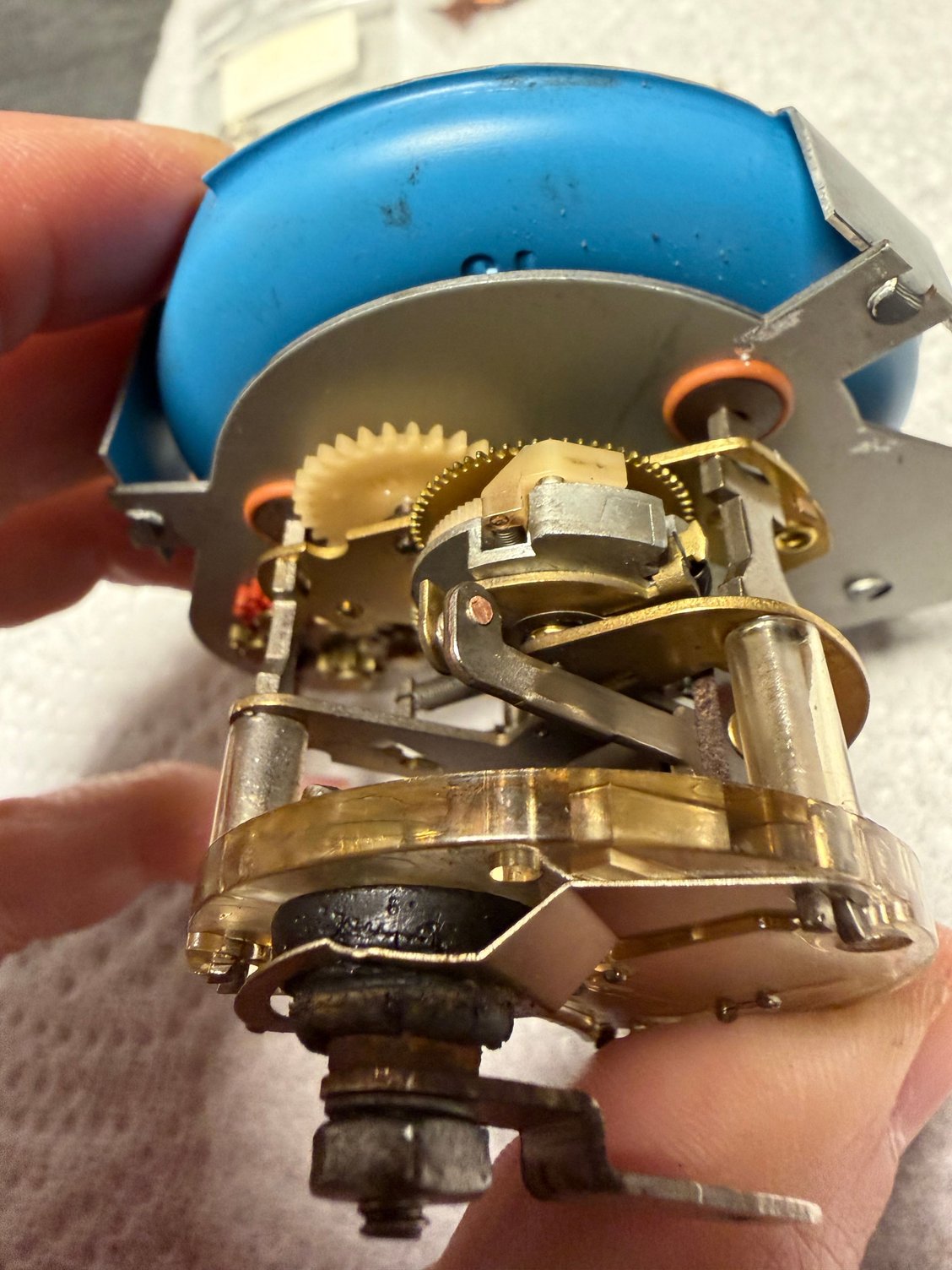

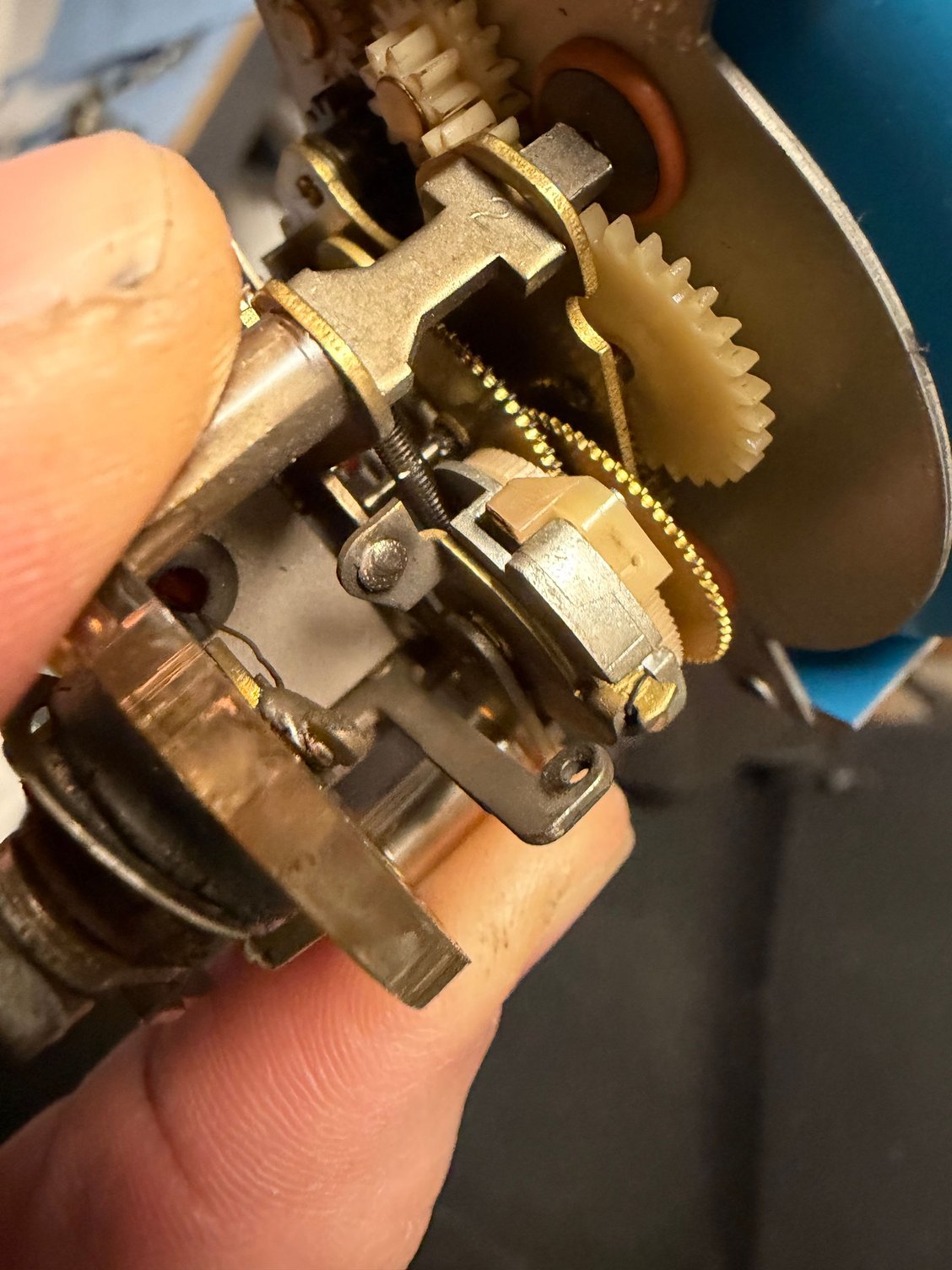

I have a small clock project. It began with just checking the accuracy, after that is opened it to check and clean it, and now I am searching a a source for the points.
One of my points was loose in the case, and the other looks like toast. So the idea is to install new points. Any idea for the size and source of the points?

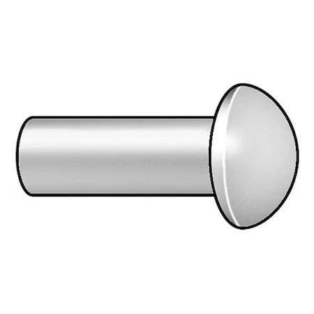

They make these small solid aluminum rivets. Aluminum is conductive, so might work there. Cut or grind the shaft to the length you need. You could try to crimp this into place or just solder it in maybe.
Don't know the size you need, this is the smallest one I saw. Size is about 1.6mm, I assume that means the head. They come in bigger sizes; you can just search for similar ones of the size you need. There are steel ones, but they would be less conductive:

The idea with the rivet, I also had, but I did have concerns with the material. Yes, aluminium is a good conductor, but also very soft and has a low melting point. Silver would be the better choice for conductivity and has a higher melting point, but it is also soft. Copper rivet is also an option.
The setting instruction is perfect, but the way with the self-adjusting didn't work well on my clock; I will go with the technical way. with the oscillating spring tensioner's handle.
I wonder what the original contacts are made of. I would think the aluminum rivets would be harder metal than just making a spot with solder.

I agree, a rivet head is pressed into shape. Pressing compacts the material.
I have learned that copper is harder than aluminium and a better conductor anyway, so I think I will look for a copper rivet.

The factory rivet looks like a hollow rivet; the back looks very much like brass, and the head may be coated with silver.
Edit: The hole for the rivet is exactly 0.0550“.

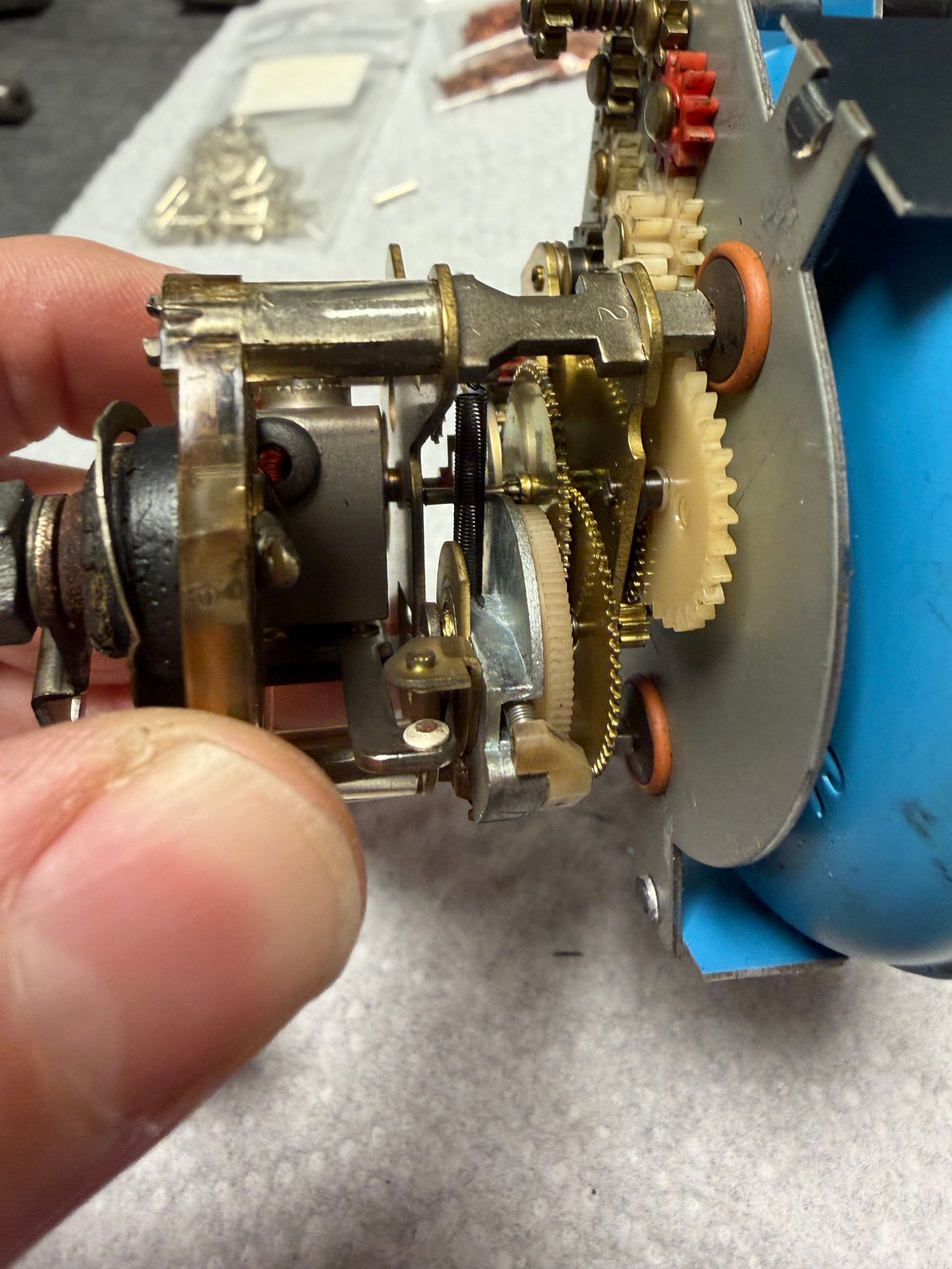

A lesson for posterity, if anyone else ever does this.
I use a silver-coated copper round head rivet. I tried to use as few strokes as possible concerning the balance wheel.

I found these in the model building section. You might also find them in precision engineering.

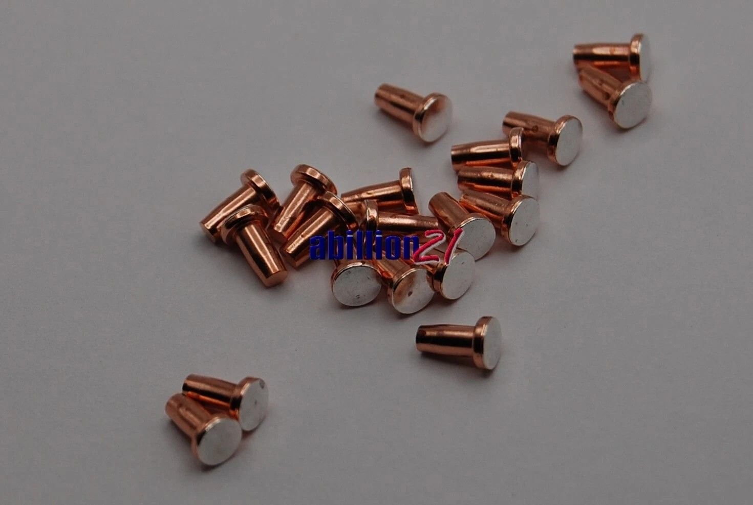

I found these on eBay pretty cheap. My clock isn't working but I haven't pulled it out yet. If it needs contacts, I'll have these on hand: Flat face, not round, so hopefully that will work.
20 NORSTAN 70049/05 Machine Composite N100/OFHC Copper Electric Contact Rivets

Aluminum is conductive so something like that might work. No one has replied here that they tried it though. The copper rivets are made to be contacts so will work for sure if they can fit in the hole.

The question is, do you find a so small pop rivet? And the other problem is you don't have a flat surface on top for a good the contact. It's a high-energy point, the contact should be strong.
The best is a round head, but a flat head will work. I can send some pictures of my rivets, which helps?

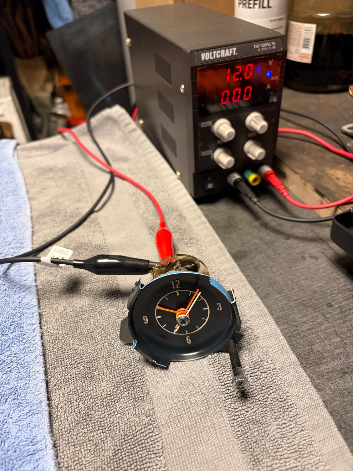

Before you go forward, check how dirty it is. If necessary, clean it CAREFULLY with ultrasonic or isopropyl. You can easily damage the balancer spring and wheel. After that, use the right oil for a clock. I also heard weapon oil is good. Use only a tiny bit oil not to much.
Currently, I have regulated the clock and found a sweet spot. The clock has plus 24 seconds per day, that's for a 50 year old cheap clock very accurate. I have luck, my balance spring is in good shape.
