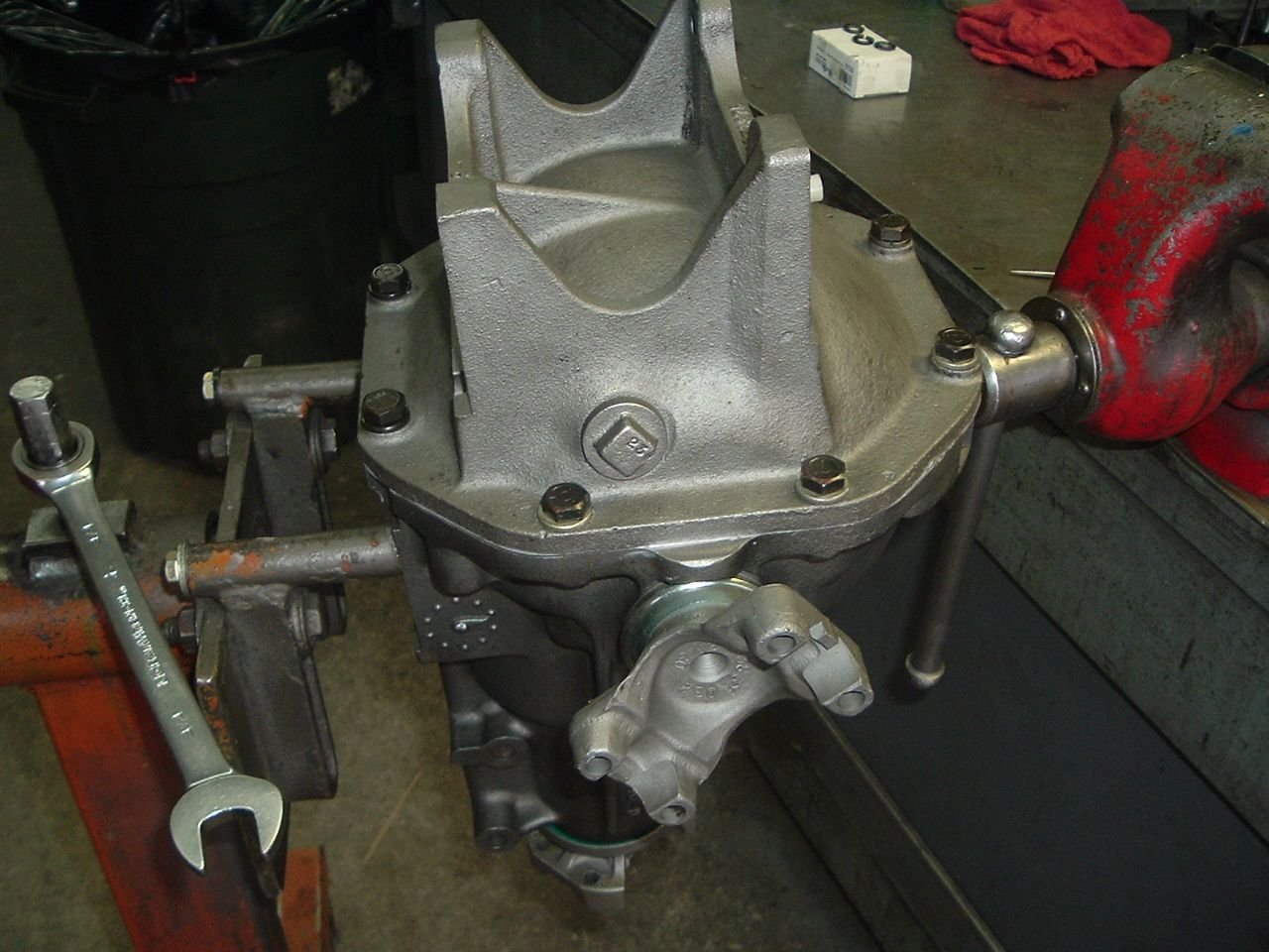

Here is a Diff I custom built,keeping it bare iron, treated with RPM. Most I paint but it's up to the owner on how it is finished.

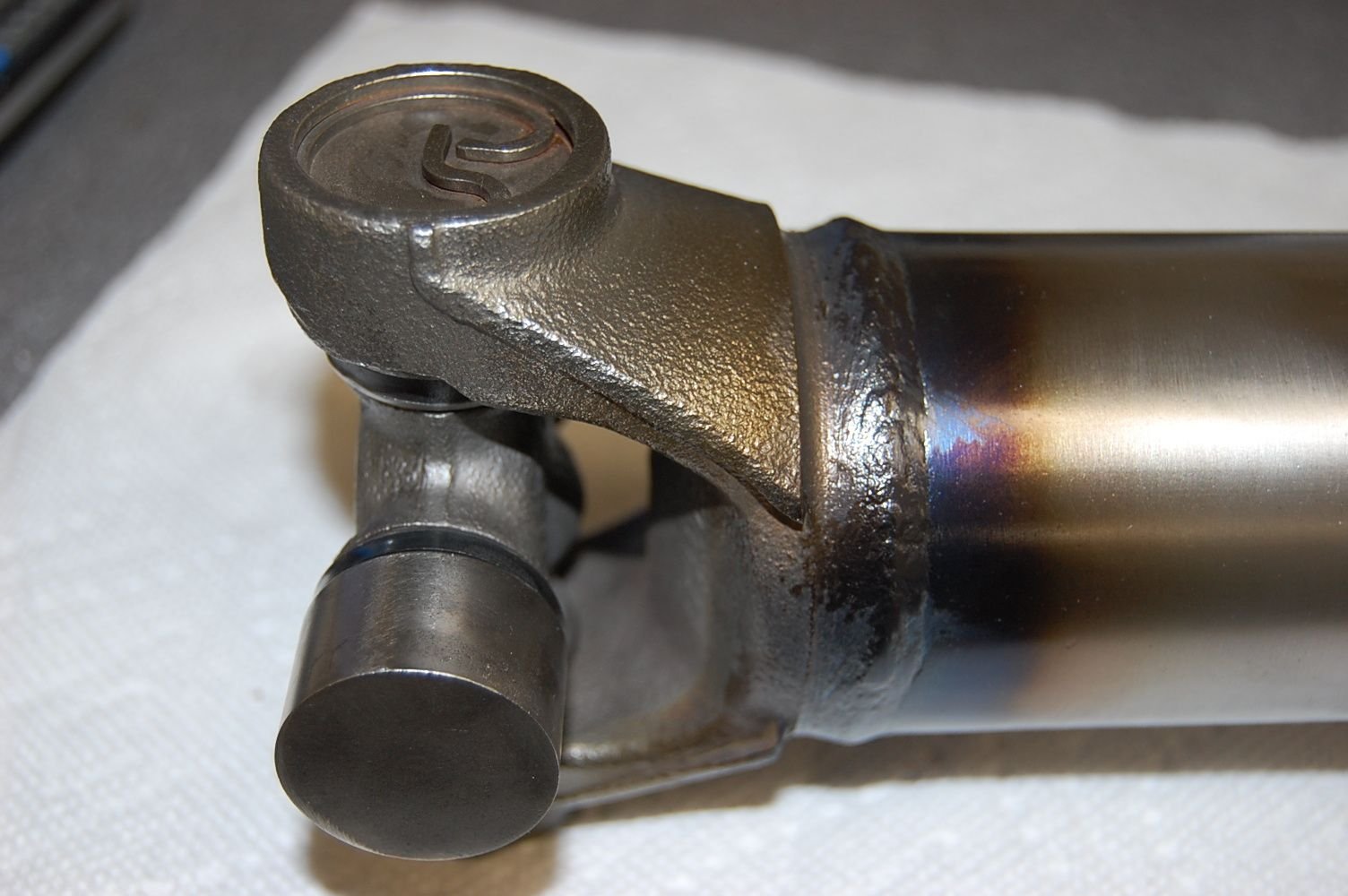

Here's one with a little semi-flat clear on it.
Regards.....

Originally Posted by Alan 71
Hello,
Regards.....
Beautiful!
How did you get your half shafts to look like that?
Old Dec 6, 2025 | 10:03 AM
Alan 71's Avatar
Alan 71
Joined: Sep 2006
Posts: 31,200
Likes: 4,287
From: Westminster Maryland
Hello,
There are typically several issues here:
The finish on the 'tube',
The appearance of 'heat zone'
The finish on the cast iron parts.
The finish on the u-joints.
The finish on the fasteners.
Regards...
The 'heat zone' was created using a propane torch. After a little experimenting, the size, color, and extent of the 'band' was controllable. A little semi-flat clear preserves it.
There was enough of the original fastener finish left to copy it in plating the small parts.

I have done that for some builds, and it looks great. However, the shafts were new and not pitted as most used shafts are. The propane torch blued them like that.
Trying to get used shafts like that will require some polishing but that won't get the pits out, just the surface.
The surface on Alans is perfect. If I recall the car was near perfect in every aspect. A lot of time and labor was required to achieve that.
