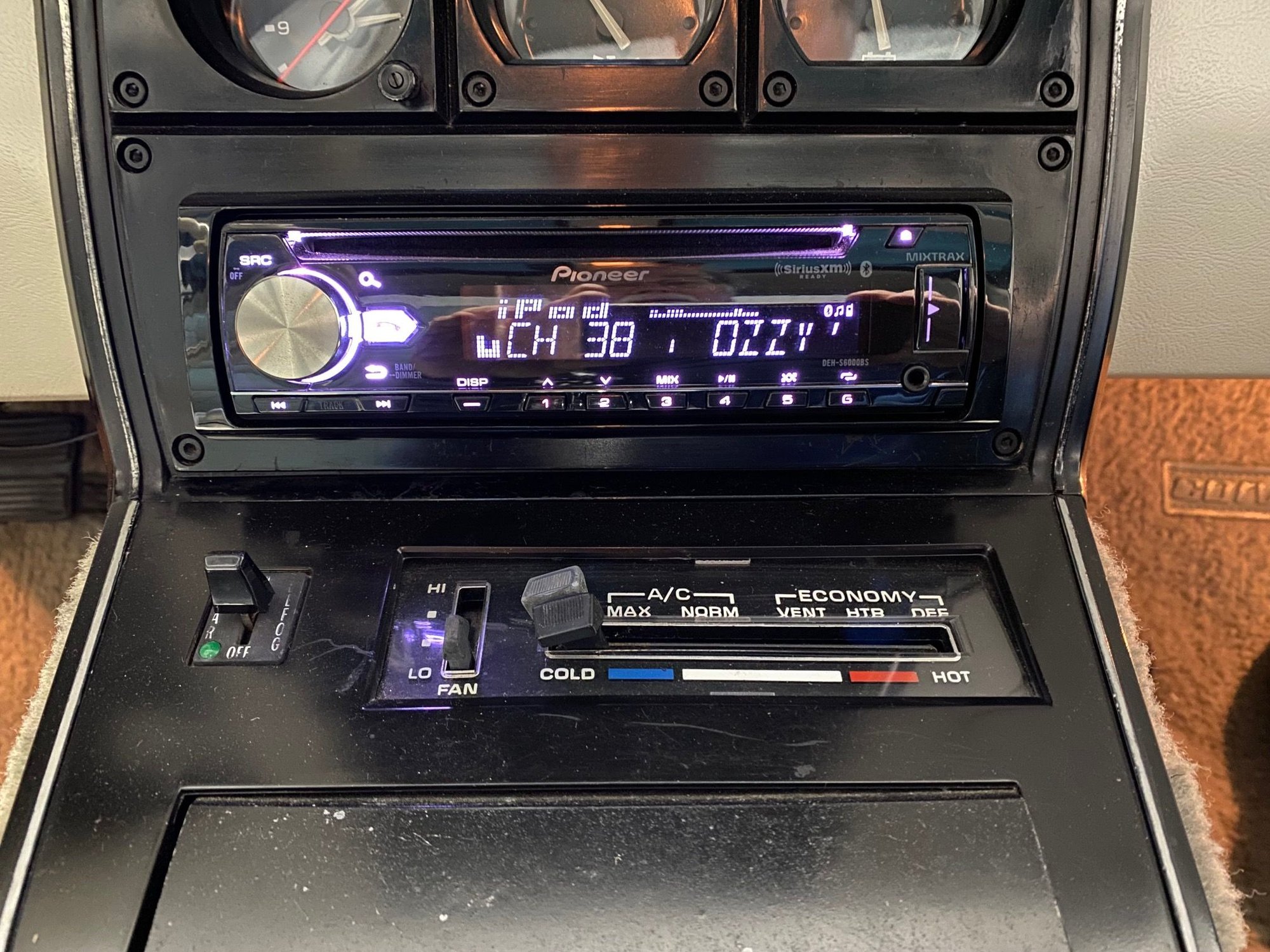

I won't swear to it but I'm pretty sure you can cut the original bezel. I know the reproductions you definitely can. I was wrong about the rear speaker size. I looked at my order history from Crutchfield and these are the speakers that the magnets barely fit in the Corvette: https://www.crutchfield.com/p_575R16...te-R169X2.html
To be honest they don't sound as good as my Pioneer 6x9 that I have installed in my Cuda but that may something to do with the car having a trunk. I don't remember what Pioneer speakers I have but they were 2 way speakers.

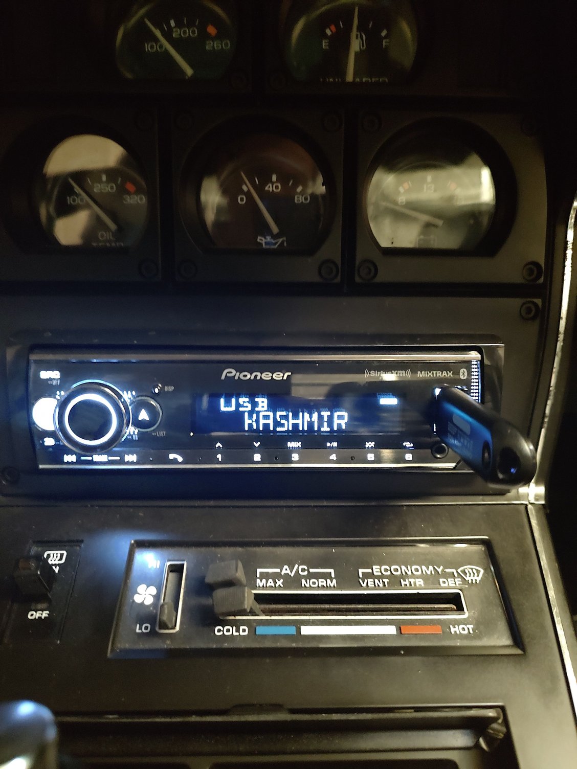

I'm not audio expert so I'm not going to recommend anything. I would recommend calling Crutchfield. Their staff is very helpful. Here's a picture of my head unit installed in a reproduction bezel.

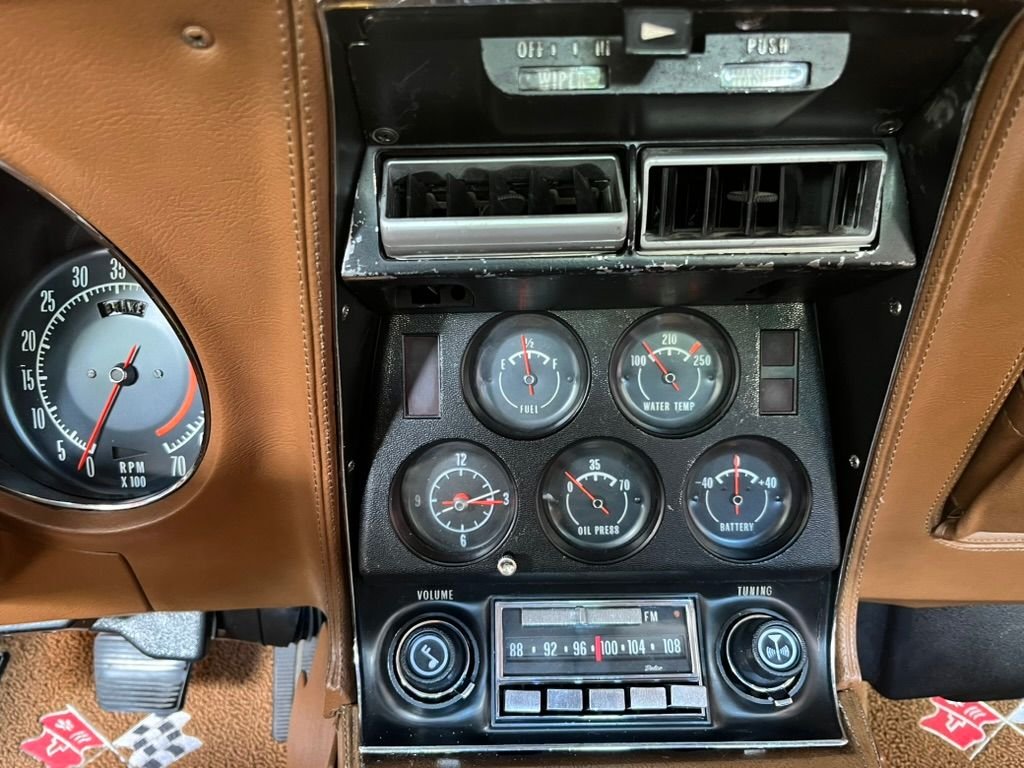

A lot of the replacement radios I've seen say "Corvette" across the top which makes my skin crawl. Most 60s and 70s GM AM/FM stereo radios used the AC delco radio with the bar that slides left and right for am or fm. My buddies early Monte Carlo had the same radio. When I bought my '73 Corvette a few years back a PO had removed the original and put in a cheesy "Corvette" radio. I later learned that was done to accommodate a Vintage Air ac unit which occupies the space behind passenger side dash where original radio's "convector" was located. Long story short I put the original radio back in after having the guts replaced with Aurora design components (no longer needs big convector box).
Looks completely original because it is original:

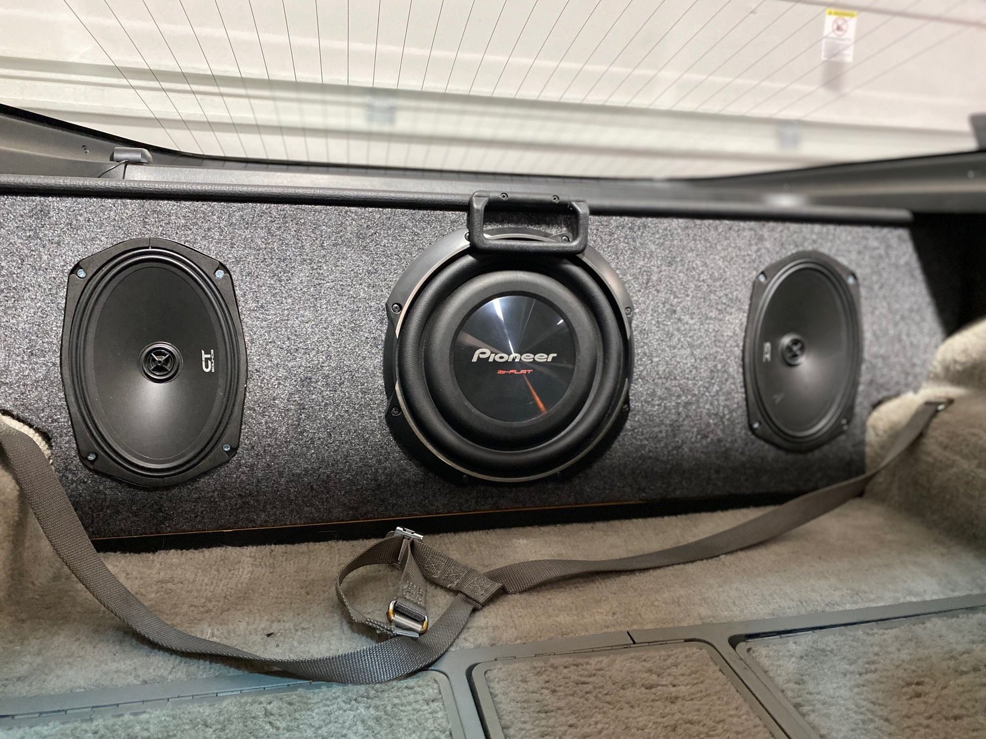

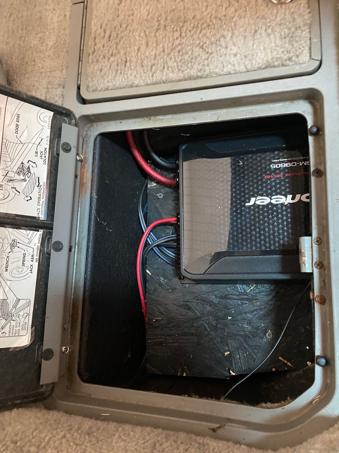

This is the stereo in my 1979, similar to Fly_Skids_Up. I didn't want to carve up my original console bezel and bought a used original one on ebay for around 50 bucks. A 1U radio fits great with minor cutting, are inexpensive and can sound as good as you want to spend. For example, that radio a few years ago has bluetooth, sirius, usb, am/fm, aux inputs and cd as was about 100 dollars.
My car had the original rear corner speakers and had a hard time finding something that sounded good in the space. was not happy with the sound. There is no baffle space isolation. I ended up buying a prebuilt box specifically for the C3 with a 10 inch sub and 6x9s. Does take up abound 5 inches of floor room on the already limited behind the seat space. The fronts are 4 inch, think the stock size is 4x6. A 5 channel amp in the passenger size cubby. Sounds really good for cruising tunes with the T tops off. Probably more than you were planning but a direction one can go.

Where did you get this speaker box from? I need one! Thanks!
