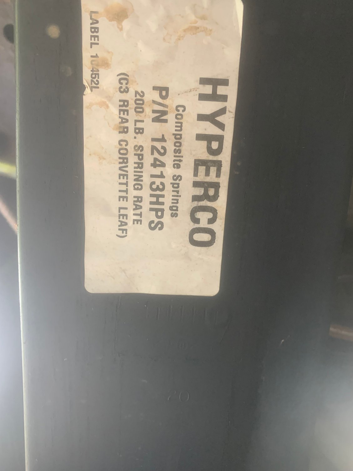

When I got my 75 vert, it had been changed to a Hyperco 200 lb composite. I find it rides very smooth, however, I wouldn’t mind it being a little stiffer.
see photo.
