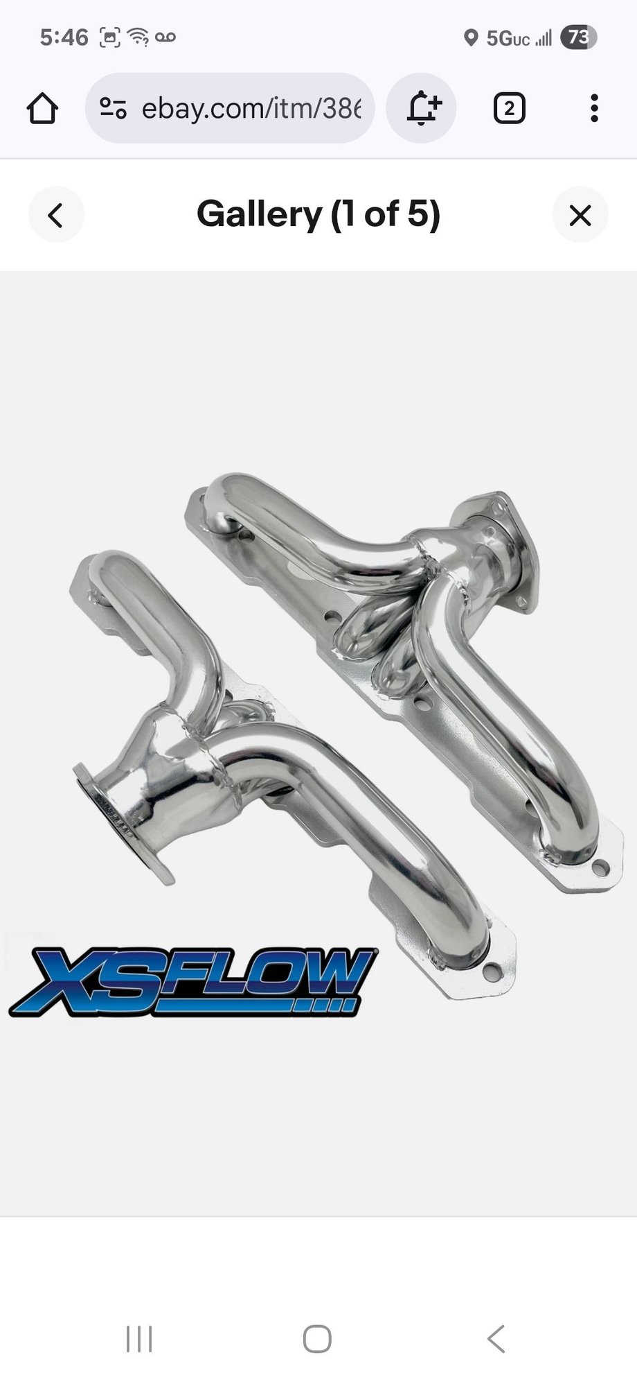

Thank you... I put very short headers on this car to factory style side pipes so no heat riser
I was originally wanting to do away with the crossover in the intake which would send me to an electric choke set up... if I stay with the open crossover in the new intake (2101 edelbrock) I will just likely stay with my current carb as it runs great and been on the car since the 70s
