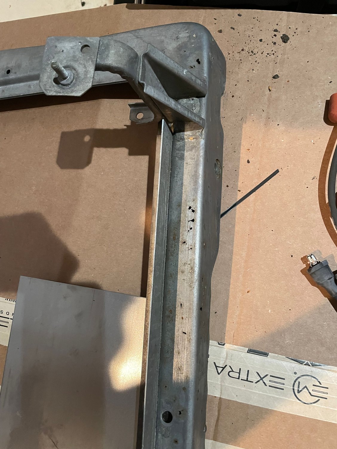

Had my radiator frame acid dipped and debating whether to weld in some patches or buy a new one. The piece is still solid but its a pretty important part and the "patching" will be a little tedious as I don't have metal shaping/bending tools. Some pics below for reference. Also looking for any comments on new pieces that are non USA made as they are about $300 less than the USA versions. Anyone buy one and how was it? Any general input is welcome. TIA
shook out quite a lot of rust from inside as well

You could try Coffman Corvette (419) 522-2246. They are based in Mansfield, OH and they specialize in core supports. They may be able to repair yours since it doesn't look too bad. They also build new core supports. Made in the USA. Family-owned business. Mine was too far gone to repair and I ended up buying a new core support from them. It was perfect. High quality and fit like a glove.

i was at that crossroad on my 69 about a month ago, mine was very rusty, the price of the China one sure seemed like the route to go but i did not want problems from going cheap and i wanted usa so i did the coffman usa core support and it is great and i dont regret it. the shipping was also very fast 2 days.
your current support looks very fixable someone might want it for the right price to fix.

I had mine out about 8 years ago and it was in similar condition to yours. The thin areas with pin holes quickly opened up a lot once welding heat was applied.
These things tend to rust from the inside out.
That said, being overseas. I patched mine. It's just that it took a lot more patching than originally thought. I wasn't particularly concerned about perfect appearance. Just fit.
As once installed in the car no one is going to see it.
As perfect looks wasn't priority, bending patch panels in a vice was good enough. Basically a free repair other than primer and paint. And spraying the inside with rust converter.
As per the Chinese made unit. I would be very concerned about the quality of the steel they are made of.

If you can do a little cutting and welding that looks patchable/repairable. I'd just try repairing it.

I'll definitely check out Coffman and see what they have. I know I could repair it and agree it doesn't show but too many plates in the air right now so time is an issue.

A Coffman will set you back $690. The “other ones” appear to run $365 so quite the spread.
I’d first take a pick hammer and assess what you have. If you can easily poke holes with light hammering, those areas are no longer viable, in terms of providing the requisite support for the radiator. On the other hand, if the distressed areas are more contained, you might consider just priming and painting without attempting any repairs, followed by pouring rustproofing material inside to prevent further deterioration. There are thousands of these cars with Swiss cheese core supports and aren’t going to park you on the side of the road.
The Coffman option will avoid any concerns down the road (especially if you pour rustproofing material inside). Even if you do a stellar job of welding in patches, a future buyer, if they do their full due diligence, will see the repairs and that will raise concerns over what else may be rusted on the car.
If you are willing to accept the fact that the ones built across the pond aren’t the quality of the Coffman’s, you are probably fine with that option. I think the main concern is how well it fits but since it is sheetmetal, you have some room for “persuasion”.

Consider that once a part is acid dipped it is near impossible to add corrosion protection without dipping in a vat of e coating. The acid will remove everything from all the cracks and crevices' The challenge is to recoat those areas.
Your radiator support still looks serviceable by welding a patch into the large hole, for the smaller holes consider seam sealer or panel bond and move on. Just another thought on the larger hole is that the panel bond would work by cutting two strips of metal and bonding them to the support if you are not too worried about looks vs function.

mine had pot holes running 1 feet on the inside edge
I brazed and finished it with grinding tools
and repainted and looks great
you will have to cut and form a piece and braze and finish

The automotive parts company that I worked for in maintenance for 34 years in Cleveland made all of the Corvette radiator supports from about 1960-1982. This is a very exacting, extremely hard to make part. Especially the six side holes have to be held in perfect alignment with a jig while spot welding. Only one person welded these supports for all of those years because it is so difficult to fabricate it. And too easy to make it wrong.
This part supports the whole front end of your car. If any of the side holes are off, you will have problems installing it. If the sides are not straight on the outside, the inner fender will not fit right.
Thin metal warps from welding heat also, if you try to repair it.
We lost the contract with GM and then it went to someone in Canada and then Coffman Corvette acquired all of the dies and welding jigs, except for 1968 supports. As I said I worked there for 34 years and we never made a 1968 "service part" radiator support. Then GM ordered all of the old dies that we had destroyed and there went the 68 dies. I have had a 1968 coupe for 53 years now.

Just wanted to update that I ordered and received a new one from Coffman. A really nice piece, thanks for the tip.
