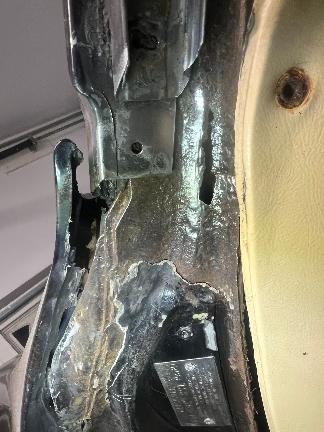

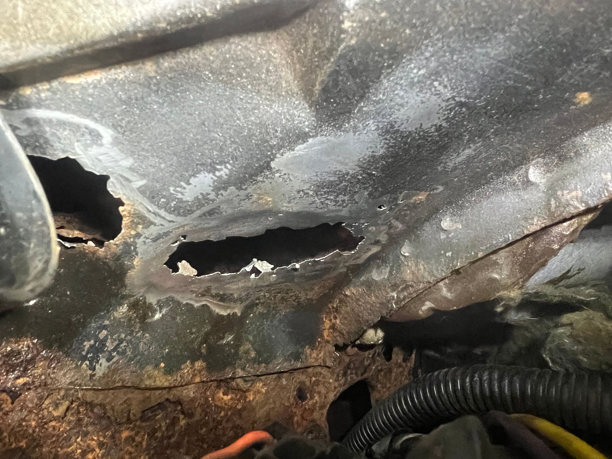

With my new interior resto I’ve almost got the dash out ( one corroded side screw left) so see how bad what I have is.
Heres 25 years of garage kept by the PO ( friend who’s older ) and never even thought to look behind.
some one tried fibre glass fixing the corners. The lowers have small holes. As for now, it’s blow and suck everything out, wore sheep and convert. I may get a while frame from a doner and just do it that way vs piece. Need to be smart and don’t want to ruin from clip.
Crazy part is it’s JUST the corners. The whole middle is tip top. Not even surface rust.
Crazy part is it’s JUST the corners. The whole middle is tip top. Not even surface rust. Below I can’t punch through.

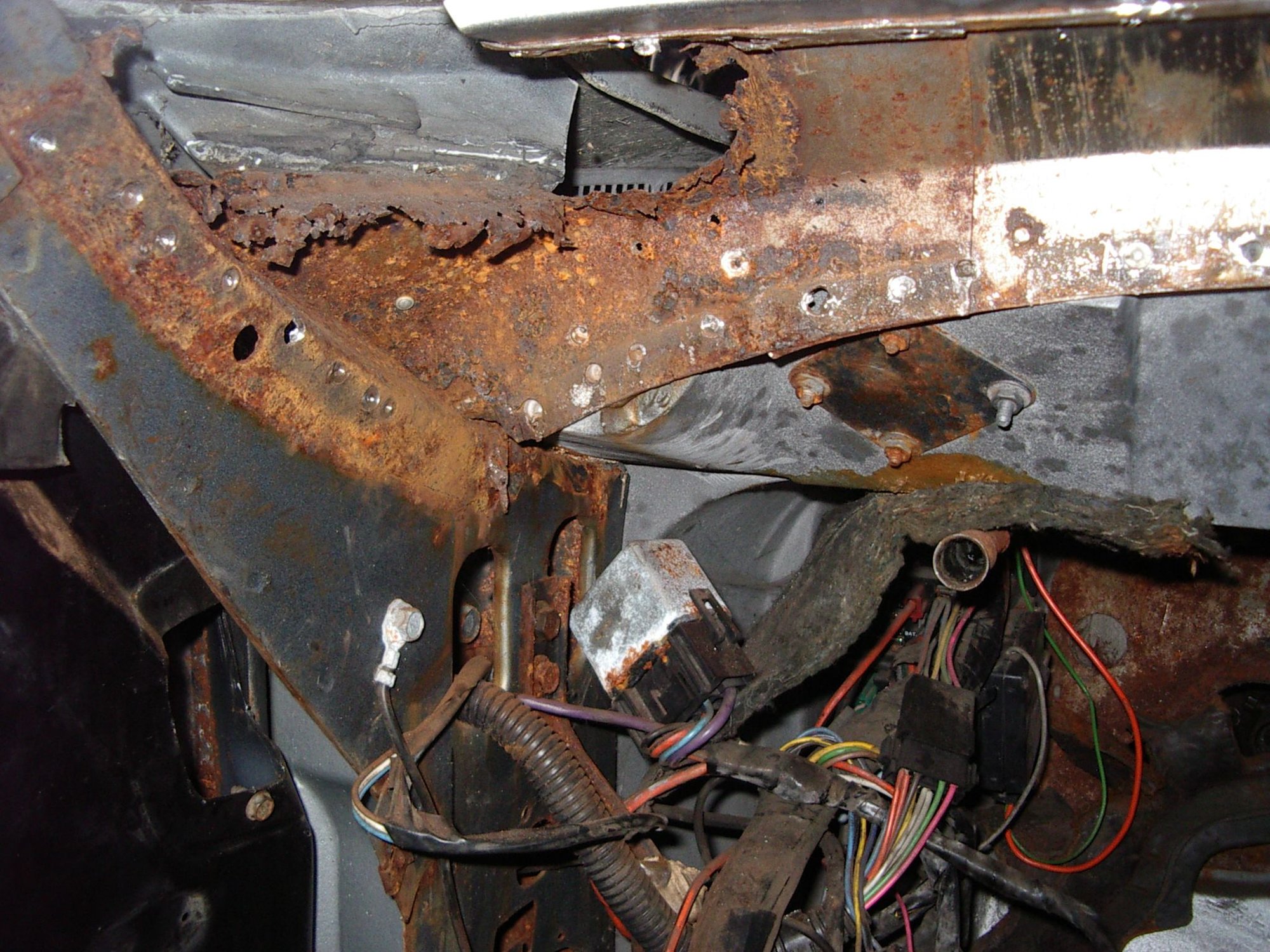

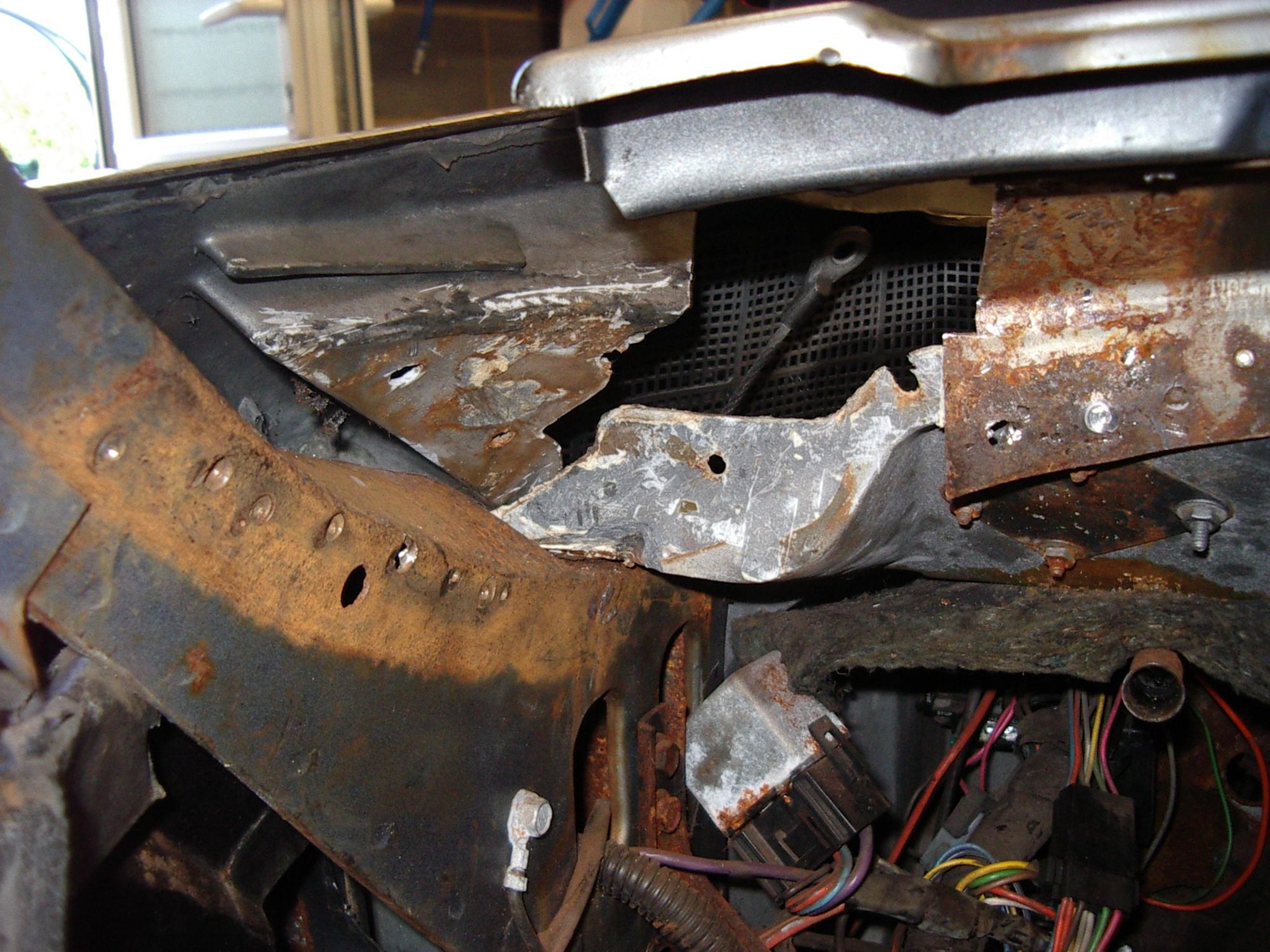

Hard to tell how extensive your rust is, but if it is just the corner you can do it without disturbing the front clip. Your inner corner skin has rotted through, mine was no problem at all, but here's what was left of the outer skin once I had removed the inner skin.

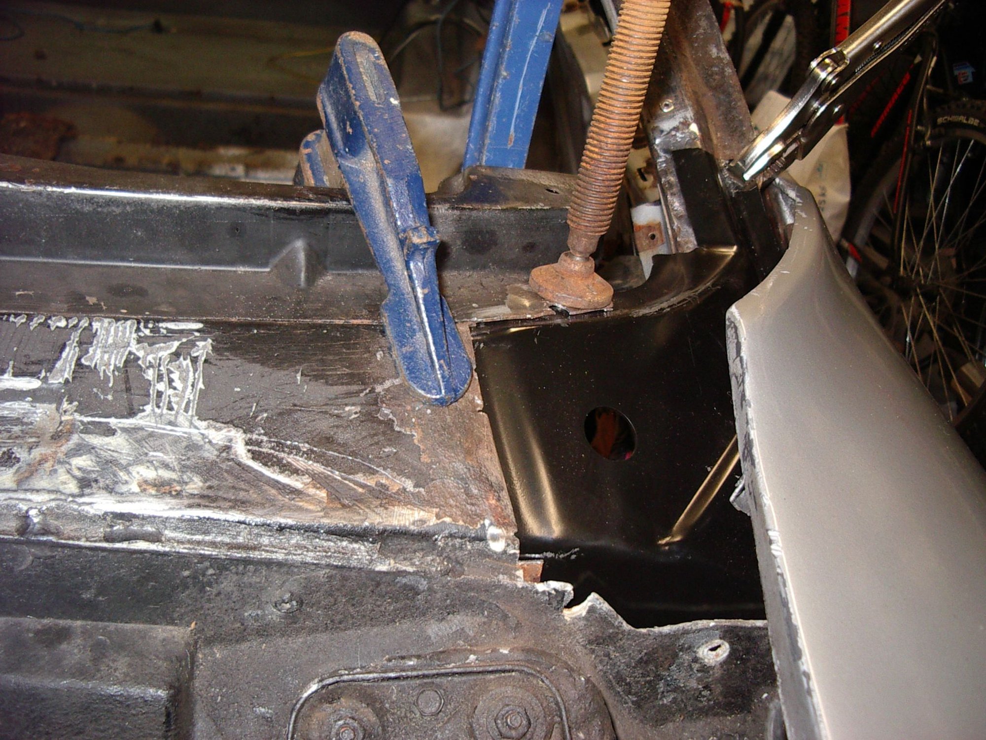

This is what it looked like when I cut out the rusty part of the outer skin
Then put in the new outer skin.

If the rust was bad that area behind the kick panel would be a lot worse that what I'm seeing. I would look up under the dash towards to base of the windshield and just keep looking until you've seen most of the windshield frame. I don't think there is a serious rust issue here but if it were me I wouldn't stop until I knew for a fact there is no problem. My first course of action would be to remove the T-top trim and get a look at the windshield frame,there are areas on top of the frame that water can collect and sit there.

I just finished doing similar on my '71 but I did remove the rear tip of the fender.
How did you weld the outer corner piece on without removing at least some of the fender??

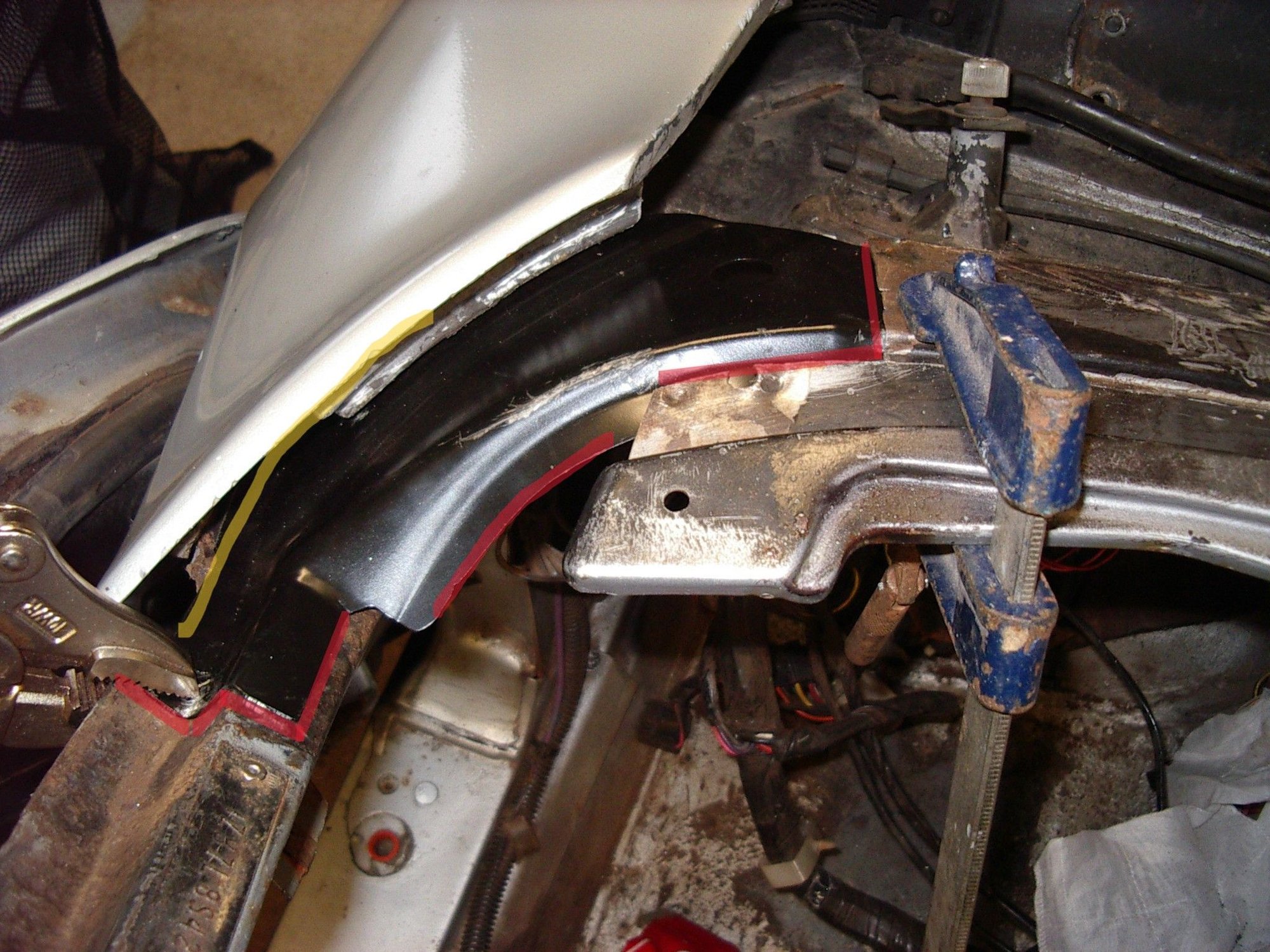

You can weld the areas I've marked in red, but not the yellow area. I applied some epoxy along the yellow area from inside the car to provide a bit of strength. I felt this was acceptable and preferable to removing some or all of the front clip.
exactly what I needed to know. Thx! There are some great panel seam products out now.

I wanted to follow up for any future readers of this thread since the opinions varied a bit. I pulled out all the trim and glove box to have a look. I also shoved my borescope where ever I could to have look. I was already doing some wiring work so it became a "while I am at" thing. I am glad I did for the peace of mind. Any rust present was all just surface rust and there really wasn't even much of that. I treated what I did find with rust reformer.
As for the spot on the base of the a-frame, it must been just a chip in the paint and not bird cage related.
