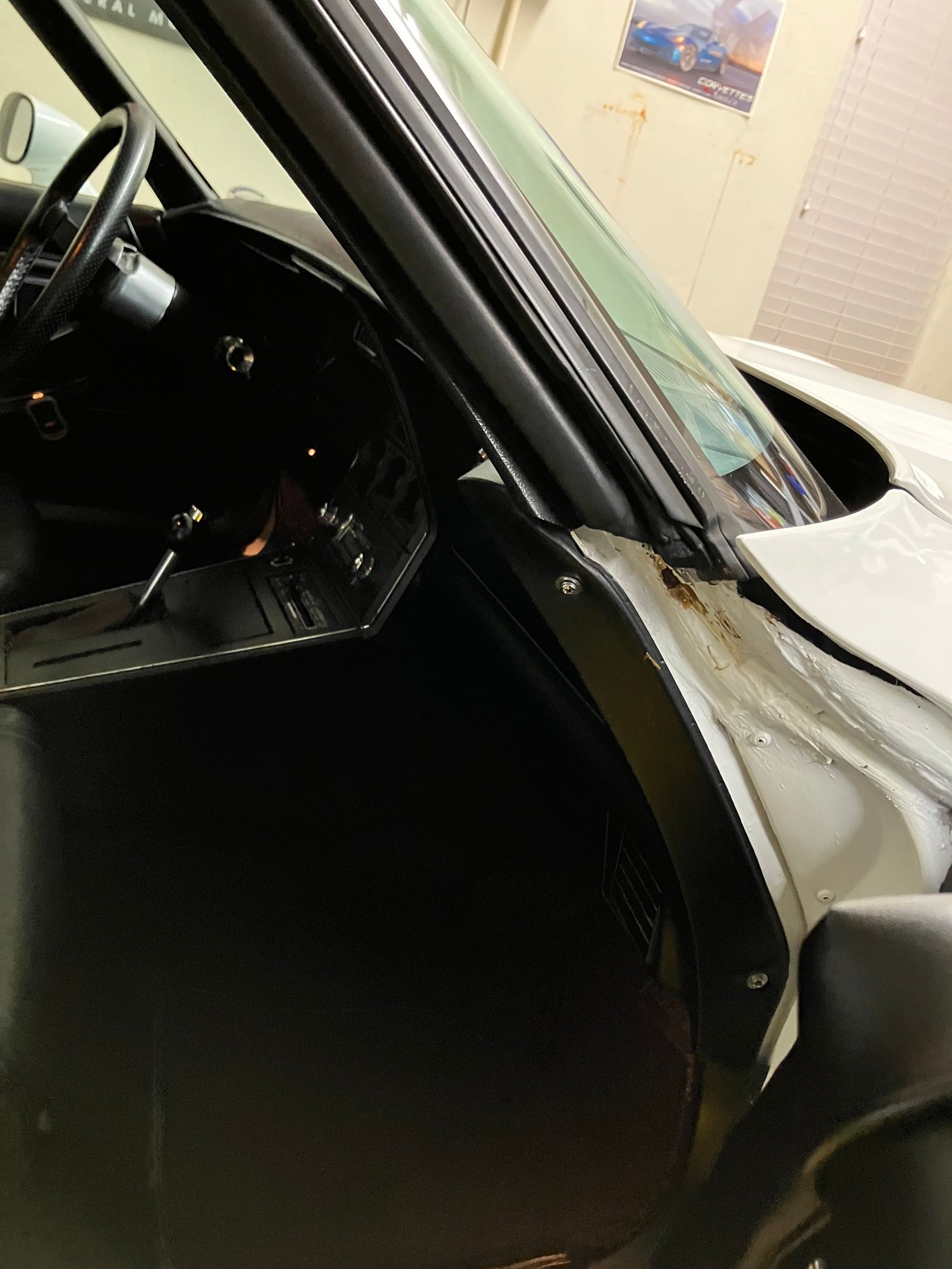

Took my wife for a Sunday drive in my 1980, and she noticed a rust spot where the windshield frame meets the body behind the passenger‑side door. That caught my attention because the car is otherwise immaculate. I can’t poke through the rust spot, but when I pulled the kick panel, my worst fear was confirmed — a pile of rust inside.
I peeled back the windshield trim. The frame itself doesn’t appear rusty, but the trim has rust stains. (See attached pictures.) The car was restored at least ten years ago, so I’m assuming the birdcage leak happened before that and the rust was painted over during the restoration.

I can't really tell where the first pic is showing in the car. The other pics are pretty typical.
With the interior upper and side trim off, poke around the metal structure and see how solid the channels feel. If there are not rust-through holes, heavy flaking, and rust jacking going on, I'd not worry about it.

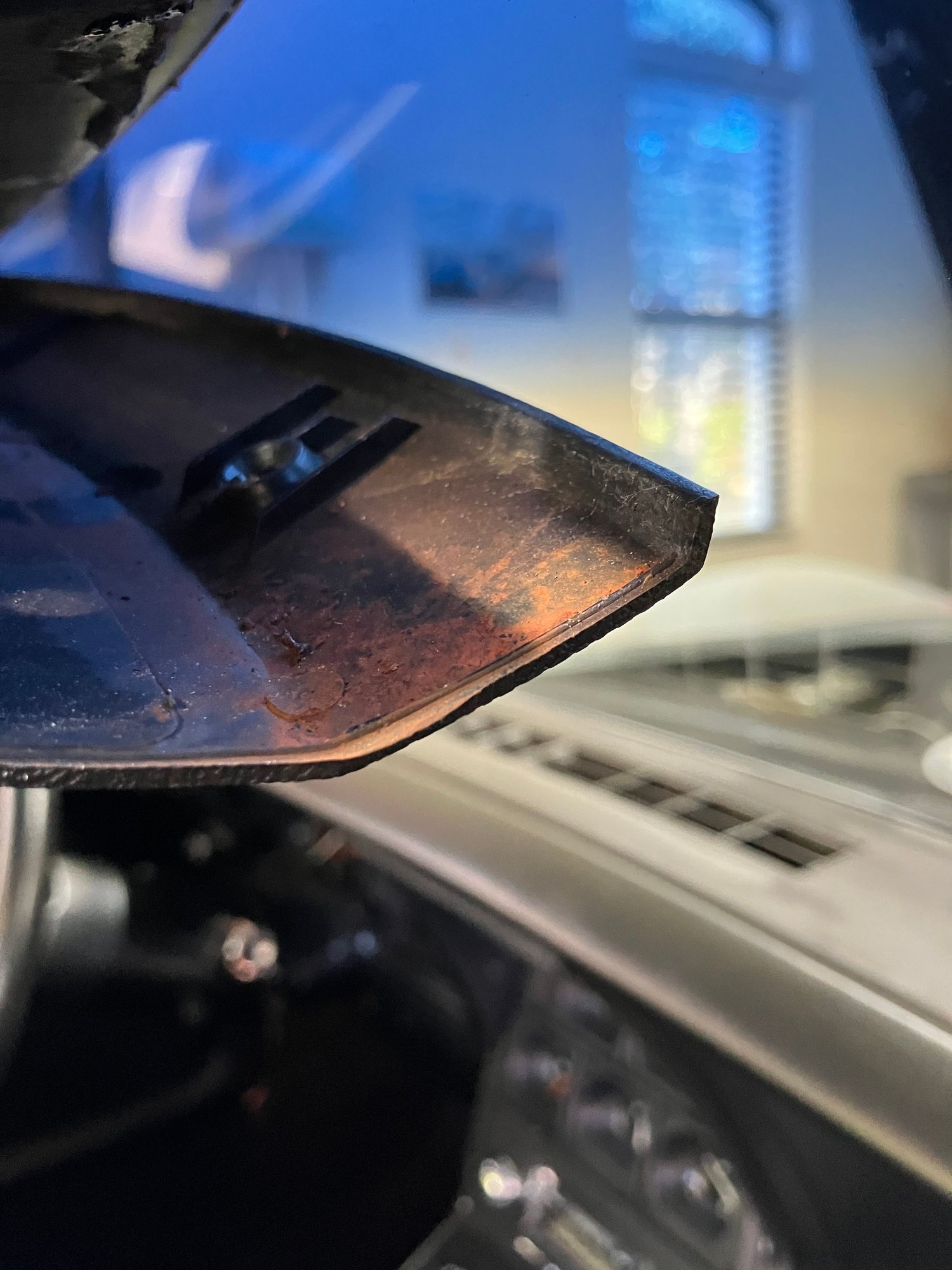

The kick panel rust looks like it came the large washer, clean it up for a better look. I also can’t tell what the first pic is.

The first picture is a rust spot on base of the windshield frame behind the door.
The top of the frame windshield frame is solid. I think the side trim is glued to the frame so stopped my disassembly for the time being.
Being a white car, the area above the hinges is going to show rust staining worse (better?) than other colors. This spot is pretty ugly in the best of cars and is exposed to environmental moisture, so a bit of rusting here is very common. I wouldn't say it indicates birdcage issues, especially since your windshield frame seems solid.

Thanks all for calming my fears! For context, here's the first picture zoomed out for reference since I didn't think it was typical. The brown all around the rust spot is excess weather adhesive. I poked the rust hard with a screw driver and it felt solid.

Agree the large washer caused the rust pile.

That seems to me quite a lot of rust to have come just from the washer and it does also beg the question if it is just from the washer, where did the water come from to cause that? I had a similar amount of rust behind the kick panel and my windshield frame looked solid until I removed the dash and the windshield. I would clean out the rust, drive the car and see if you continue to collect more rust particles in there. If so, you likely have an issue higher up.
