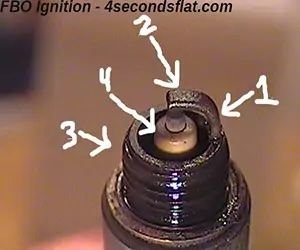

I've got a couple questions from the first link. What do others think of these 4 areas and what they indicate.
#1 Is a timing indicator, you'll see a definite color change on the ground strap, it doesn't show well here but you can still see it right about at the arrow. Too much timing and the color change will be very close to the threaded body of the plug, too little and it'll be closer to the tip. Ideally we want it right in the apex or center of the 90 bend on the ground strap. This plug shows too much timing for the combustion chamber efficiency or octane level.
How can the spark be optimally jumping from the ground strap to the electrode from the 90° elbow. Why do we set the gap between the end of the strap and the electrode? Doing this doesn't change the elbow distance much at all.
#2 The tip of the ground strap is loaded with OIL deposits, fuel deposits are usually flat black in color and almost like a fine powdery deposit, this motor is leaking oil into the combustion chamber, bad valve guides, leaking valve covers allowing oil to seep through the plug threads, whatever it needs to be fixed.
I agree with this, but this plug doesn't look too bad.
#3 The threaded portion of the plug gives you the heat range, look at the threads you'll see that a few toward the tip are a dull burnt looking color the rest are black and shiny. You want about 2 threads showing the heat on the end of the plug and the rest of the threads to be shiny, this plug is impossible to read because of the oil mess. If you using a longer reach plug than this one 2.5 to 3 threads is optimum.To increase the number of burnt threads increase the heat range of the plug, if you have 4-5-6 threads burnt you need to get a colder plug.
I've long thought that the whiteness of the center porcelain is an indicator of how appropriate the plug's heat range. Never heard that the threads indicate anything in this regard.
#4 Arrow shows another indicator of timing, you'll usually see a brown ring right at the tip of the porcelain area it should be a sharp and defined ring about .020 wide. Wider indicates not enough timing and any smaller, or only 1/2 way around or nonexistent as in this image is the second indication of too much timing in the motor.
Again, not aware the white porcelain indicates timing. A coolant leak if bright white, fuel quality and characteristics if there's red/brown coloration, deposits if too cold.
Any comments on the webpage or my thoughts?

It’s been a while since I actually read the webpage i linked to! But having now re-read it following Barkingrats comments, I have a few thoughts.
Re Point 1: It’s not saying that the spark jumps “early”, but that the colour of the electrode changes along its length based on the plugs actual heat (not heat range). So if it is getting too hot, or not hot enough, the colour change is not at the optimal point on the electrode, ie more or less on the apex of the angle.
Point 2: If any of the plugs in our ’78 looked as oily as this one, I think I’d be worried! 😀 A bit too oily for me I think?
Point 3: Back in the late 60s, when I was running my Austin Cooper, I used the info from an old English driver’s handbook (for a Humber Hawk!) as a guide for setting timing and mixture. That gives info on ‘reading the plugs and does in fact include mention of how the “top” of the body (thread ) should look. I’ve always worked on “a light carbon deposit, grey brown in colour”. But I don’t see it as a separate guide from the electrode insulation (porcelain) colour, using the two together as an indicator of timing and mixture settings.
Point 4: Both timing and mixture will have an effect on the plug condition. Over advanced timing will show very similar symptoms as a weak mixture. I work towards a light straw colour for the insulation. Too white is an indication of weak mixture or advanced timing. Advanced timing can of course be “cured” by a cooler plug, depending on how advanced you want to go. Or, retard the timing and/or richen up the mixture. My thoughts are that generally, the mixture in our Corvettes will be OK-ish, if set up well, so then the timing is the item to be adjusted.
I also like to periodically check how the exhaust tail-pipes look inside. I like them to have a light greyish colour, with little or no “soot”. That gives me an idea of the “running” mixture.
I’m not saying I’m right - just how I’ve always interpreted plugs.🙄 If I’m honest, it was probably more critical on the small Cooper engine, which needed to be spot-on to give the best performance and soon showed its displeasure at incorrect settings! The old Corvette just rumbles on…..😄

Point 1: Ah, I see now that I was misinterpreting what it was saying. Thanks for pointing that out.
Point 2: I agree the threads are very oily and not acceptable. I believe the article is still talking about the ground strap and it looking overly oily. It only looks to be slightly wet with the strap showing through which is why I thought it wasn't horrible looking.
If I were to "read" this plug, I'd say the heat range of the plug is appropriate given the porcelain color and the fuel mix seems appropriate given the lack of sooty buildup, but the engine has an oil problem given the threads.
As I understand it, the heat range of the plug has nothing to do with spark intensity or heat of combustion; it's all about heat transfer from the plug's exposure to combustion temps away to the head material. Because of this I'm unsure how timing effects can be addressed through the plugs.
Don't mean to hi-jack the thread, but maybe this sideways deeper dive adds to understanding.
