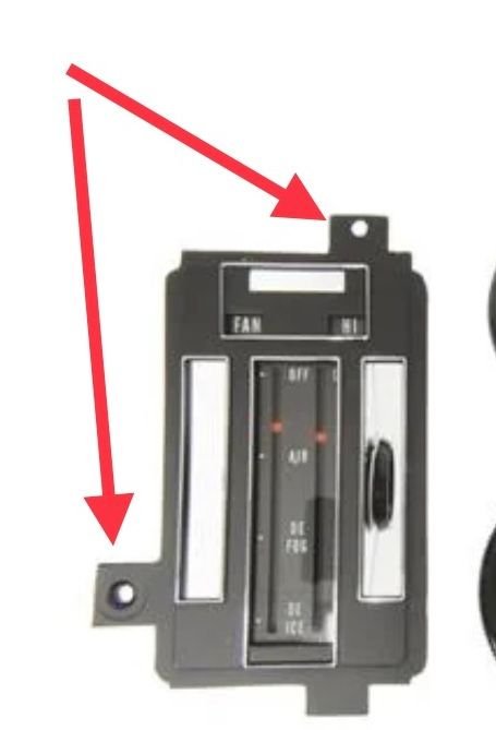

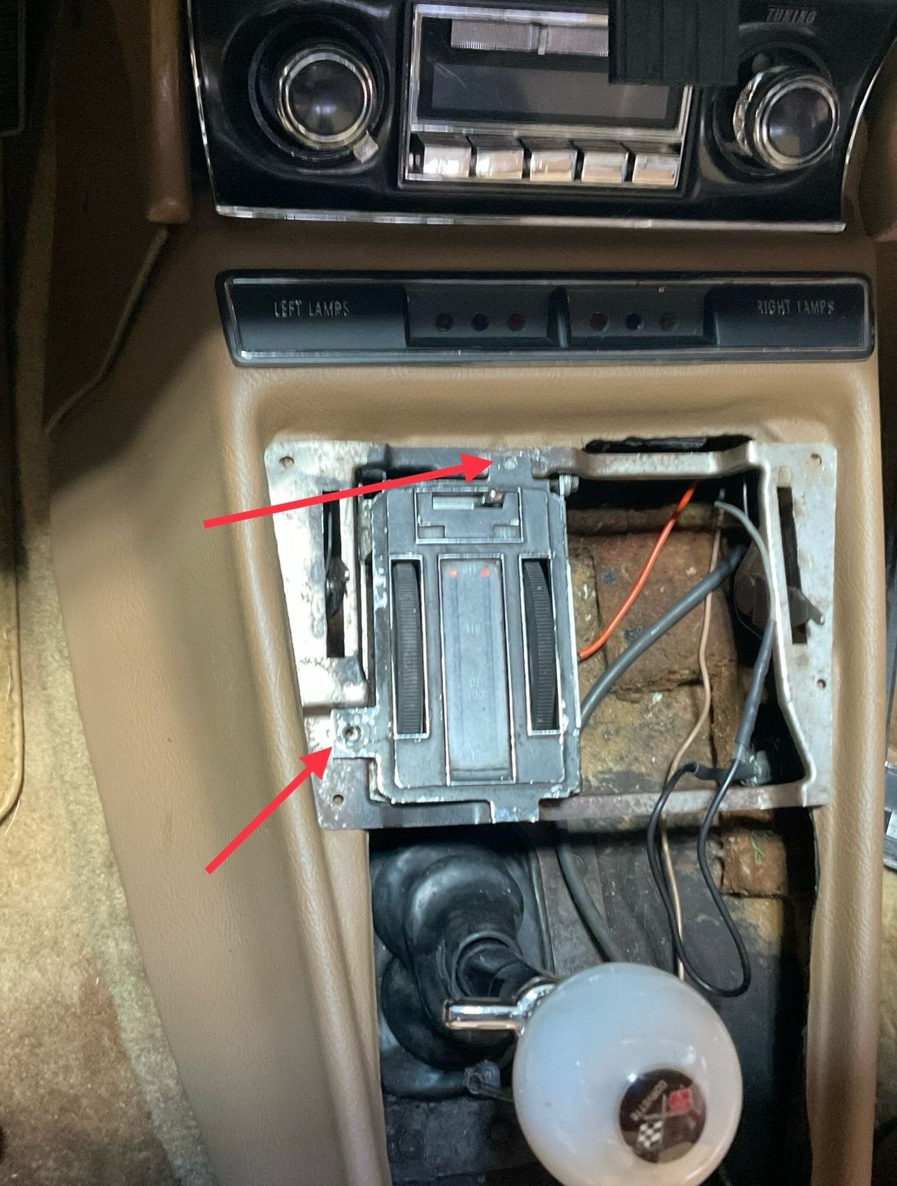

I’m attempting to put the center console back together after doing some repairs. Unfortunately I didn’t take enough photos and I’m having trouble figuring out the correct screws to mount the non A/C Heater Control to the mounting bracket. I’ve looked at the various online vendors and they all seem to show different screw combinations. I’ve attached a photo showing the location of the two screws in question.

Hello,
How about....
Flat head Phillips machine screw

So they are both machine screws, and not sheet metal? Are they both black in color? Just trying to narrow it down before I go through my plethora of loose screws, lol.

Hello,
Yes. Black in color.

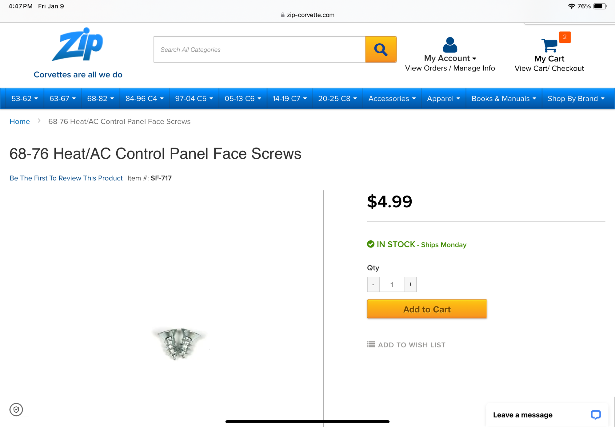

Sorry to bother you again but is it possible these are sheet metal screws? Everything I find online shows sheet metal and not machine screws. Unless I have the nomenclature of the parts wrong.

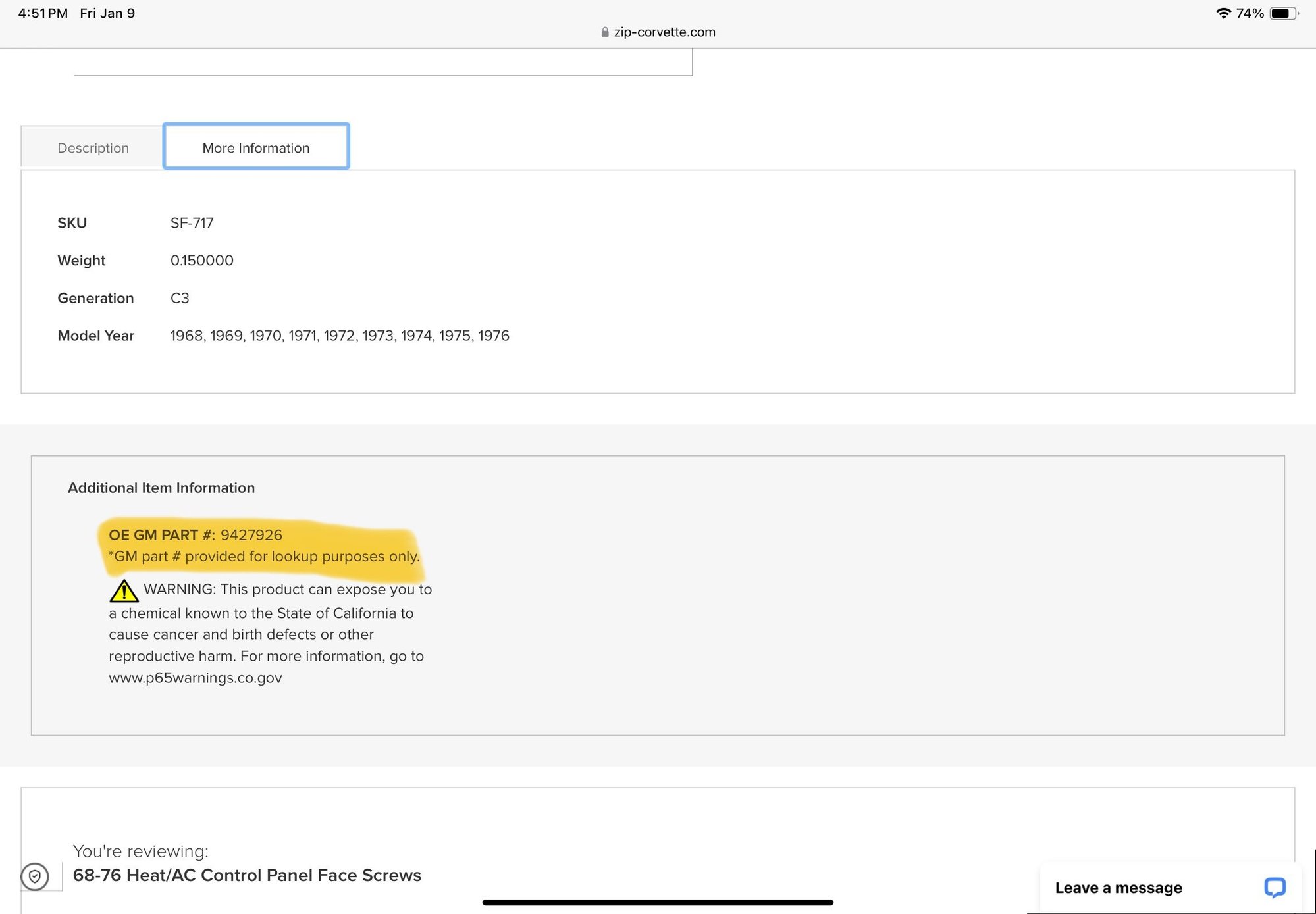

I believe the screw is as I described.
In the 71 AIM it's:
UPC 1 ASM
Sheet M3
Item... #1 Screw 9427926
The screw is drawn as if it's a Philips head machine screw.
I certainly could be wrong!!!
The AIM drawings are often misleading.
Regards....
Old Jan 9, 2026 | 05:13 PM
Jeff2761's Avatar
Jeff2761
Joined: Oct 2021
Posts: 153
Likes: 36
From: West Virginia
Very helpful. Part # crosses over to a OE part on the zip Corvette site. Thanks very much!

That’s interesting. The part # Alan references crosses over to sheet metal screws, at least on the zip Corvette site. I want to ensure I use the correct screws so it looks like I’m going to have to do some further research, lol. Thanks guys.
